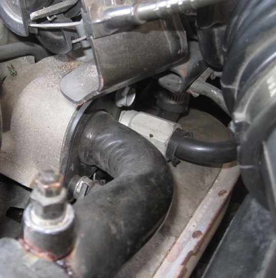

Padgett Posted March 5, 2016 Report Posted March 5, 2016 Do you mean it is in here ? Gasket only has two bolt holes. Quote
Schurkey Posted March 5, 2016 Report Posted March 5, 2016 Yes, I expect that's the thermostat housing/water outlet. Doesn't look like the 3.1 I was just working on. Looks more like my 3.4L. Quote
rich_e777 Posted March 6, 2016 Report Posted March 6, 2016 Ive never seen that on either 3100 SFI models, maybe unique for the final year? Quote
Padgett Posted March 6, 2016 Report Posted March 6, 2016 Is a 3.4 LQ1, guess they are different. Quote
