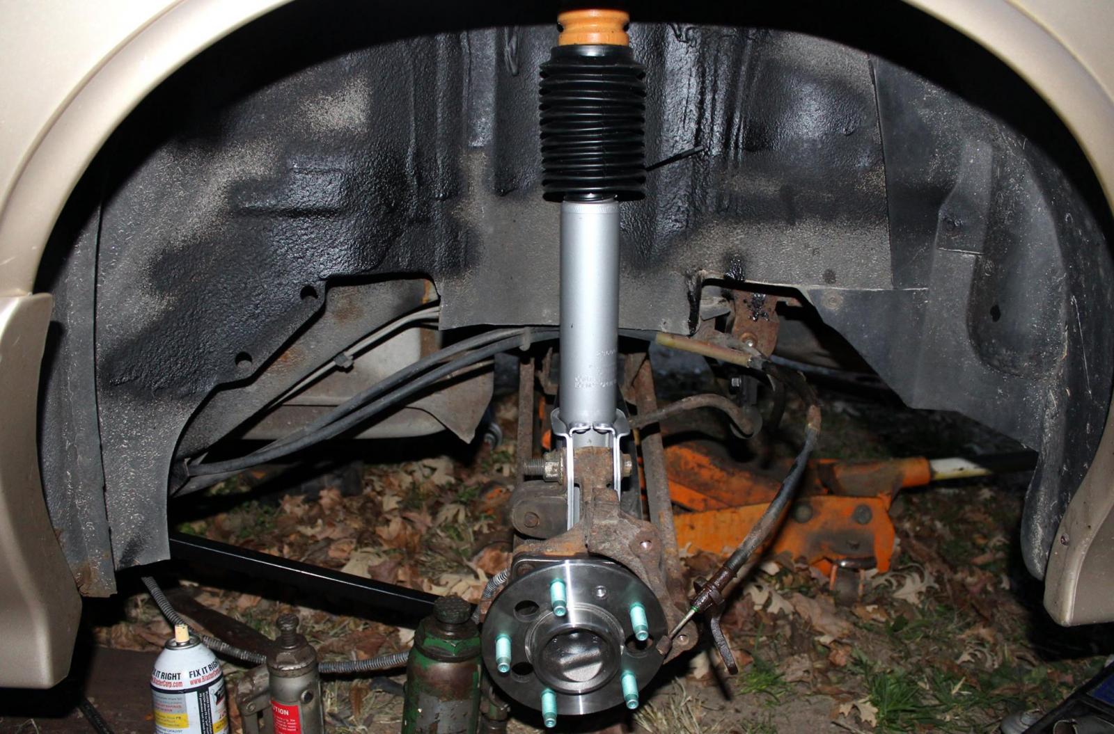

cutlasssupremepizza Posted November 3, 2014 Author Report Posted November 3, 2014 Oh man, what do I do now? I got the struts put in, and tried to hook up the trailing arms, but the hole at the knuckle is about 1/2" spaced to the rear, since the new ones are Chinese, I thought maybe they were too short, but they are not. I tried using a pry bar to move the knuckle closer to the front of the vehicle, but no dice. Quote
cutlasssupremepizza Posted November 3, 2014 Author Report Posted November 3, 2014 (edited) Got it! I guess I needed to jack it up (the knuckle) higher, I was just worried about the leaf breaking. Now on the drivers side, the parking brake cable jacket is broken. I was thinking of just disconnecting it, but how hard is it to replace? Rockauto and other sites list 3 cables, a front, and a left and right rear, but on my car, the drivers side cable looks like it runs the whole span of the car. Edited November 3, 2014 by cutlasssupremepizza Quote

cutlasssupremepizza Posted November 8, 2014 Author Report Posted November 8, 2014 Well I got one side all together, minus the caliper, and the damn alignment is off, way off. The top of the wheel sticks in while the bottom sticks out. This is how it was when the old strut was broken. However the latteral arms are not bent, and neither does nothing else. Quote
rich_e777 Posted November 8, 2014 Report Posted November 8, 2014 I`d take it to an alignment shop, some guys here can do it themselves but a shop has the better equipment and more knowledge. Then you can ask where the alignment was thrown off. Sounds like the Lat. Links are pushing the wheels out at the bottom. Just a little bit can aid in cornering, to much gets you pulled over by the cops and laughed at. Quote
pitzel Posted November 9, 2014 Report Posted November 9, 2014 (edited) Well I got one side all together, minus the caliper, and the damn alignment is off, way off. The top of the wheel sticks in while the bottom sticks out. This is how it was when the old strut was broken. However the latteral arms are not bent, and neither does nothing else. So you have a positive camber issue? If you used the KYB's (like I did), the way to resolve positive camber is to loosely tighten the top and bottom strut to knuckle bolts. Install the brake rotors backwards, and use the lugnuts to hold the backwards brake rotor on. Use your floor jack to jack up the brake rotor that's been held securely on with lugnuts, until the bottom strut to knuckle bolt reaches the desired (ie: usually maximum) deflection. Tighten both strut to knuckle bolts to the prescribed torque (check the service manual, I think its 134 ft-pounds.). Let the jack down, and continue reassembly as normal. Edited November 9, 2014 by pitzel Quote
pitzel Posted November 9, 2014 Report Posted November 9, 2014 Mind posting a picture, BTW, of what yours looks like? For me, it was positive camber (and too much of it) that was the issue, not negative camber as your description might suggest. Also your new struts, do they have holes exactly the same as your old ones, or are they elongated/oblong/elliptical? It is possible that something is bent/whacked/messed up. The official way of changing camber is to effectively grind the holes larger on the strut, and even on the stabilizer bar part as necessary. Something that should be keen to be avoided unless you're really sure you know what you're doing. Quote
