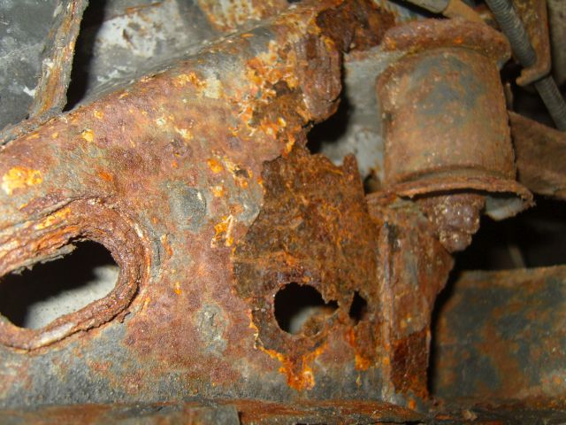

Dinsdale Posted October 24, 2014 Report Posted October 24, 2014 You are not alone ! The pic is of the passenger side, the other side of the 1991 Buick Regal coupe is completely okay.......I guess it's all a lottery. I decided to send the car to the guys at a workshop in town (I've known them for twenty years) for heavy stuff like this involving rusty bolt removal. I don't have a car lift or as many big hammers as they do, so I think they'll have a better chance of success than me laying on the ground to do this stuff. I decided on this course of action after seeing and reading about this kind of problem here in the forums, so thanks very much to all for the info and help! Quote
