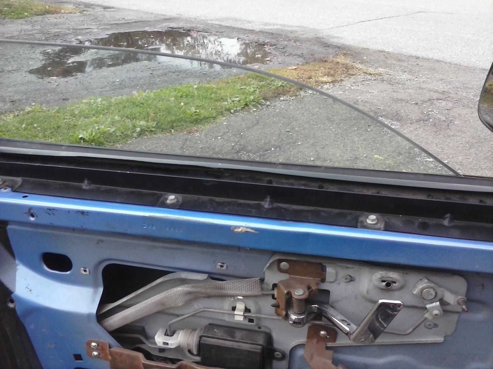

What happened was the front guide had broken, allowing the front of the window to drop and pulling the back guide out of the channel.
I went to a local window place and took my spare window hoping they had a generic guide I could glue onto the window and he just helped me put my spare in right there in the parking lot.
I can't go over how to remove a window from the tracks, because mine was already loose in the door. To pull it out we pushed the front down and rolled the rear up and out.
First remove the door panel, then plug the window switch back in so you can cycle the window regulator all the way down.
This black metal piece here didn't have to come off, but it took one person to hold the weatherstripping back while the new glass went in. He says one person can do this if you take the inside weatherstripping off.

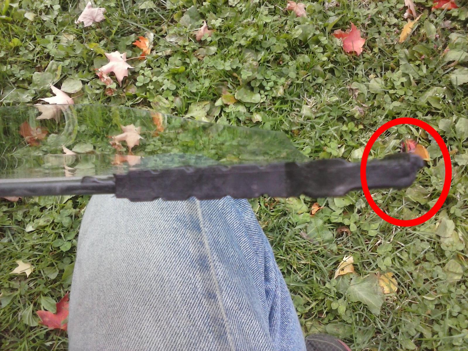

On my window the front guide was missing a chunk on one side, the guide is mounted to the underside and less than an inch of it is in the track so it really could have been engineered better.

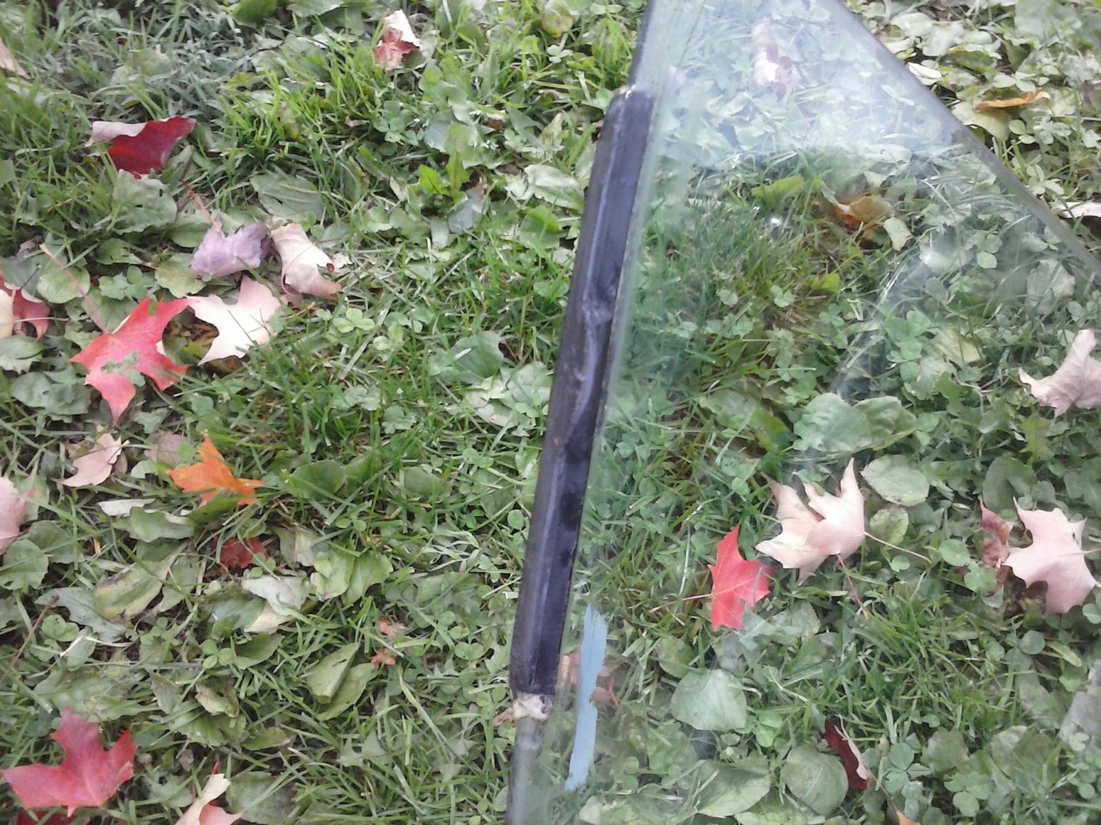

The Rear guide sits up high and kept pulling off, I thought it was the problem until I got it it on with the right adhesive. Epoxy and crazy glue failed miserably, but Gorilla Glue turned out to be the ticket. If you have to glue one on just be sure to clean the guide and glass thoroughly with something like Acetone or Alcohol first.

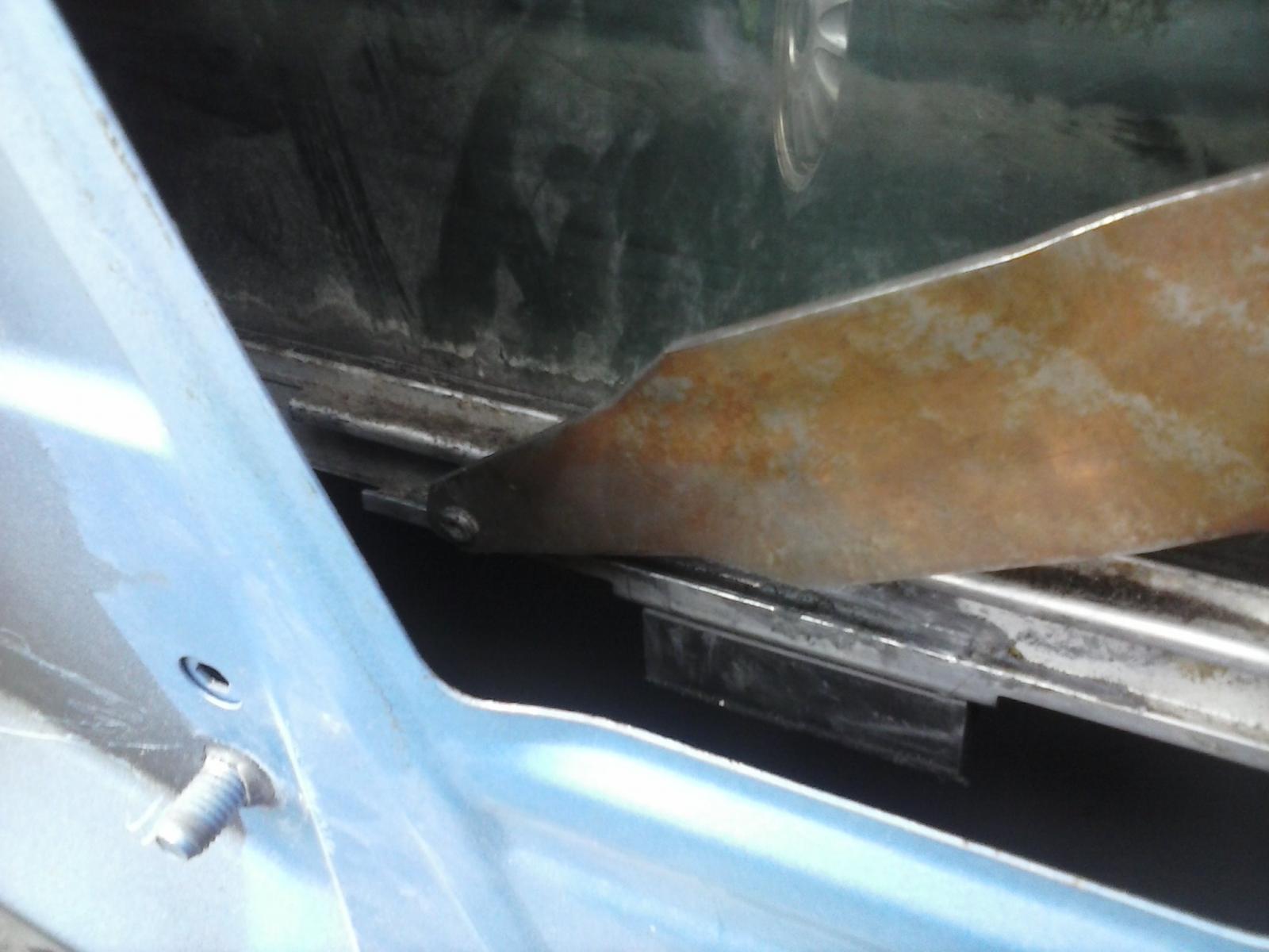

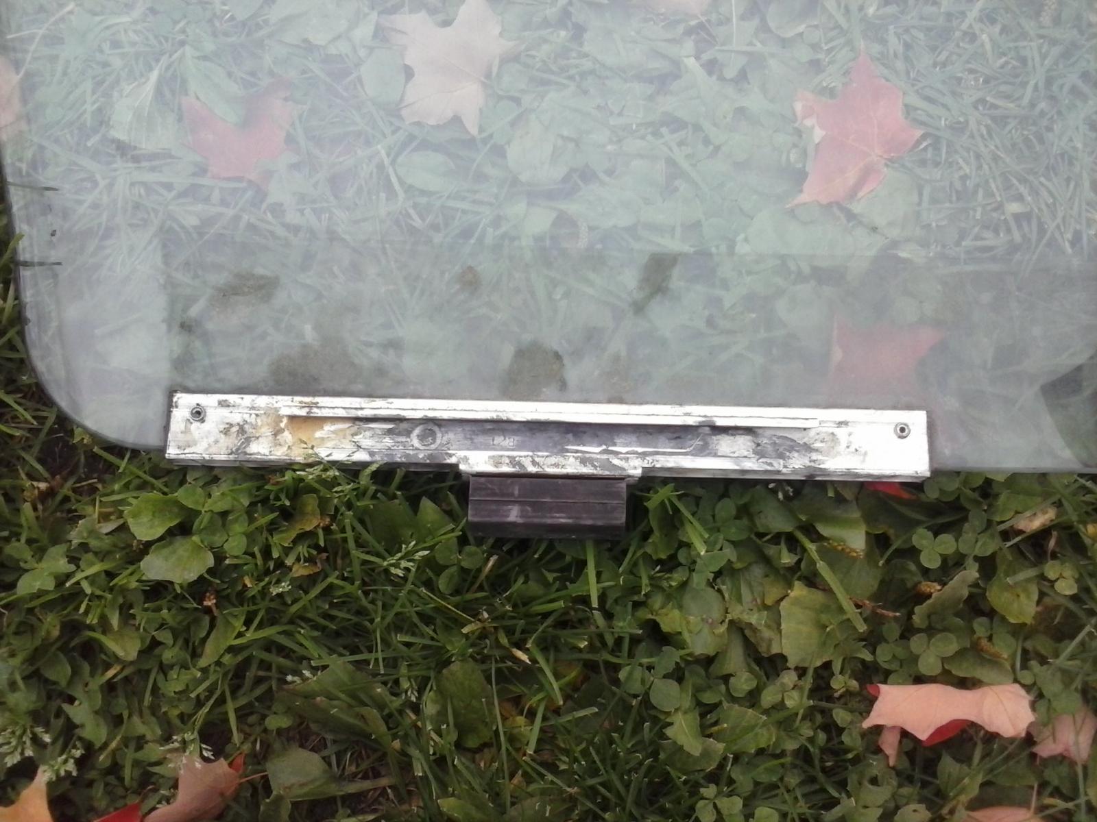

The window regulator has but one arm, and a wheel that goes into a track secured to the bottom of the window, when the window is being held linear in the front and rear tracks this wheel's range is limited so it doesn't extend out either end.

At this time we need to start thinking about that roller on the regulator, once the front guide is in the regulator arm won't be able to get to the end of the track on the bottom of the window.
Lower the regulator (Via Switch) all the way down if you haven't already.
Now tip the glass down a tad in the front and play with it some and you'll be able to get the wheel started in the FRONT OF THE TRACK, it will sit on the exposed upper edge there.
Now run the regulator up a few inches and you should be able to snap the front guide into the front track just like the rear one did. This takes a little effort and you'll have to feel it inside the door.
