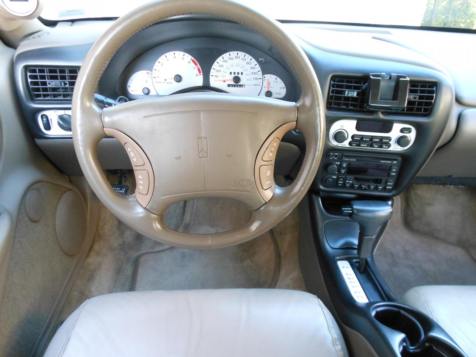

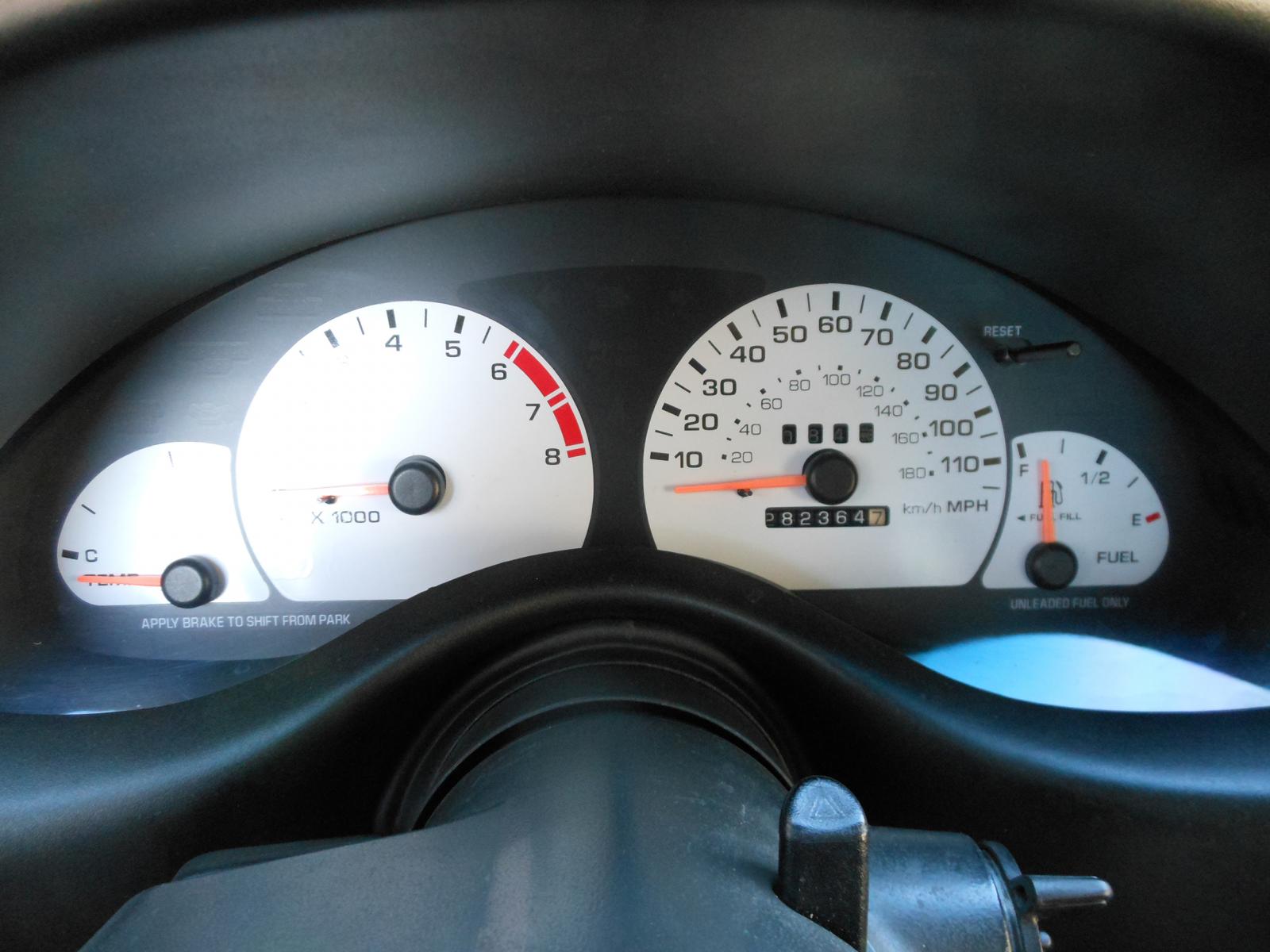

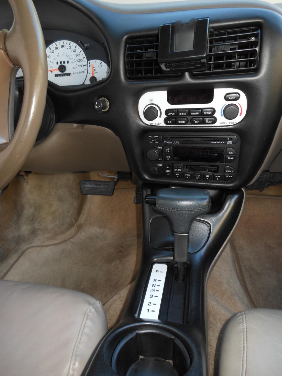

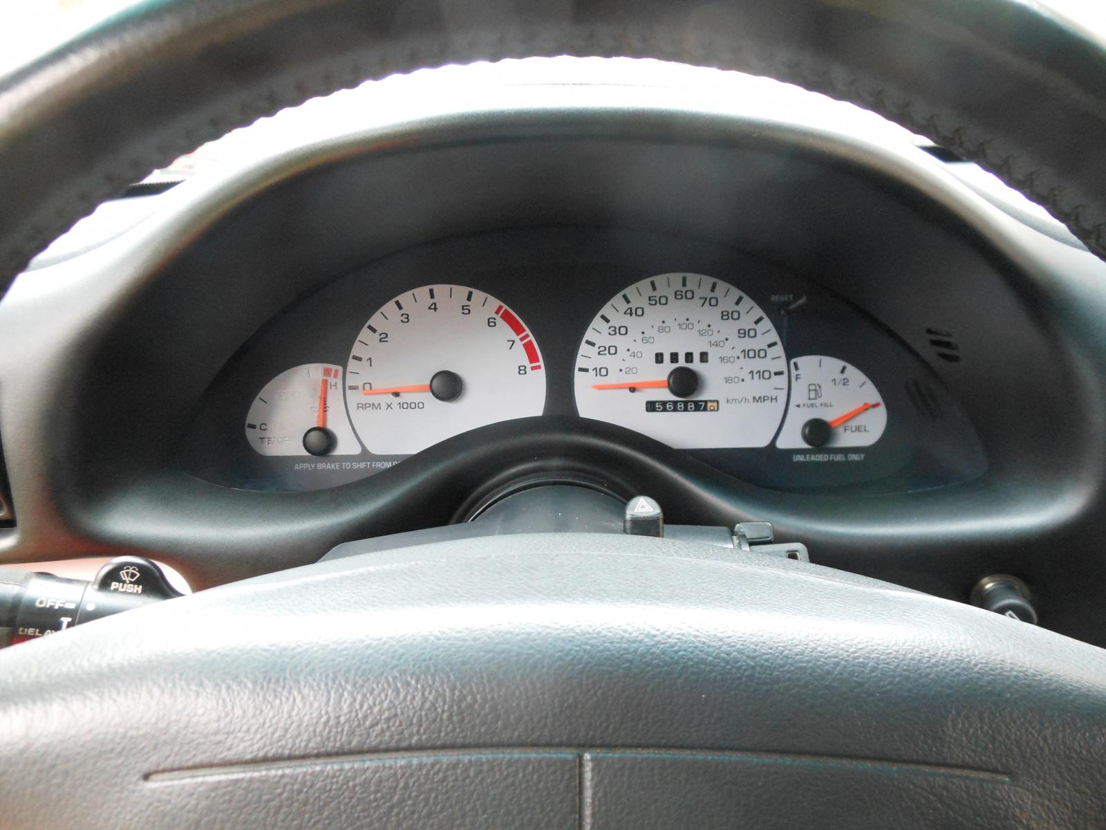

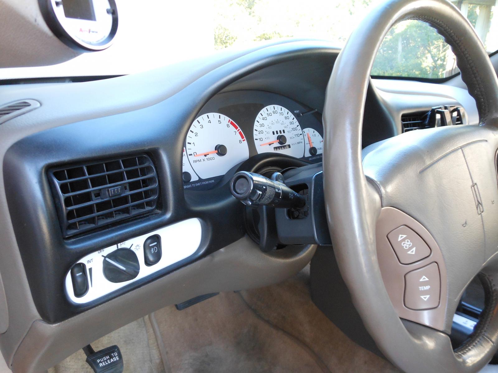

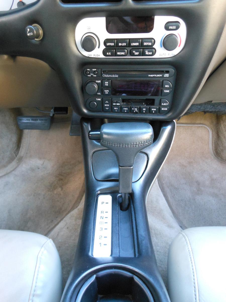

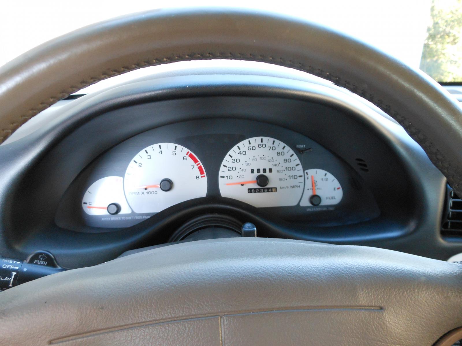

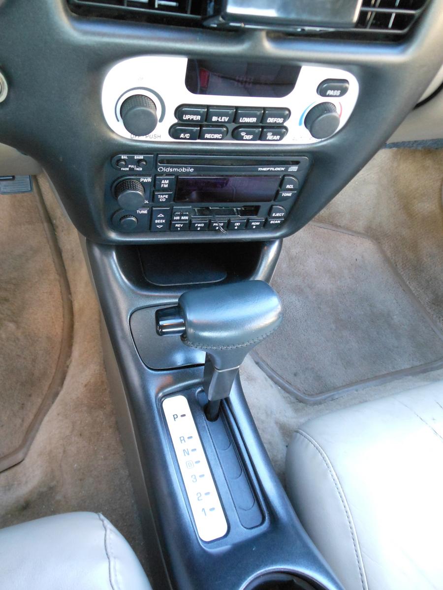

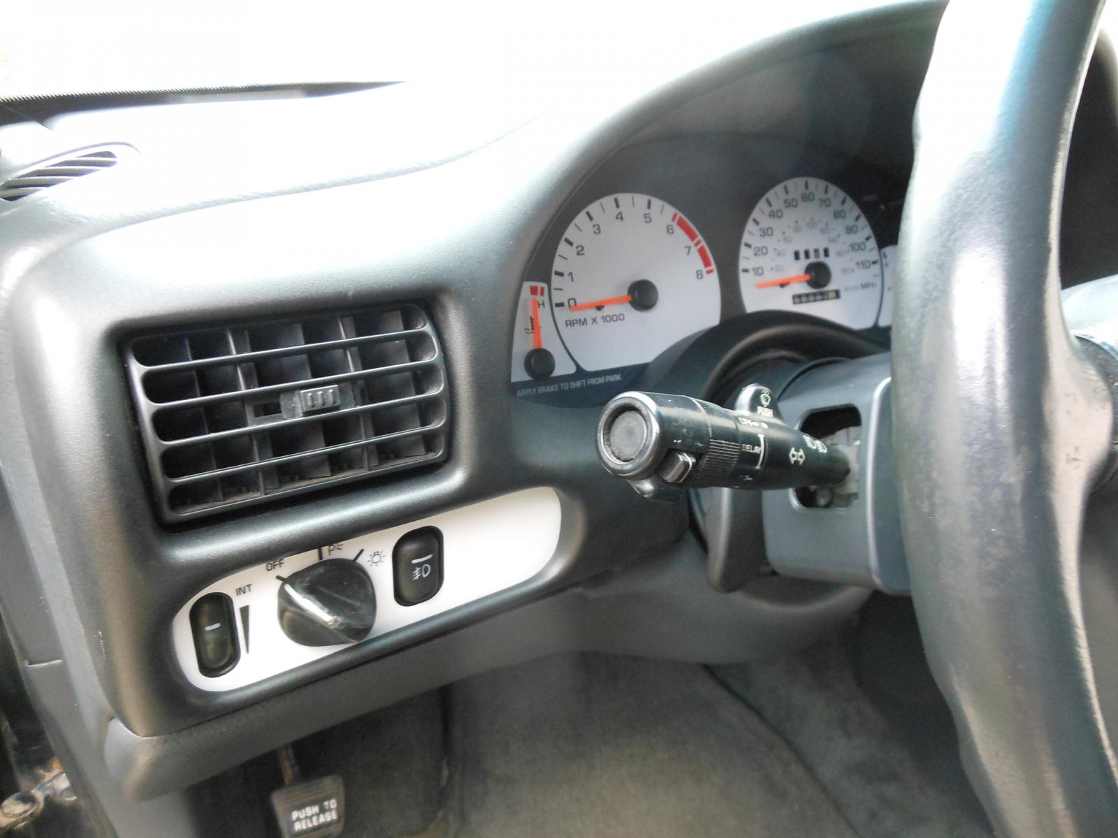

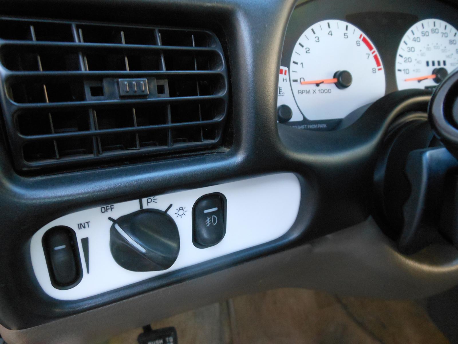

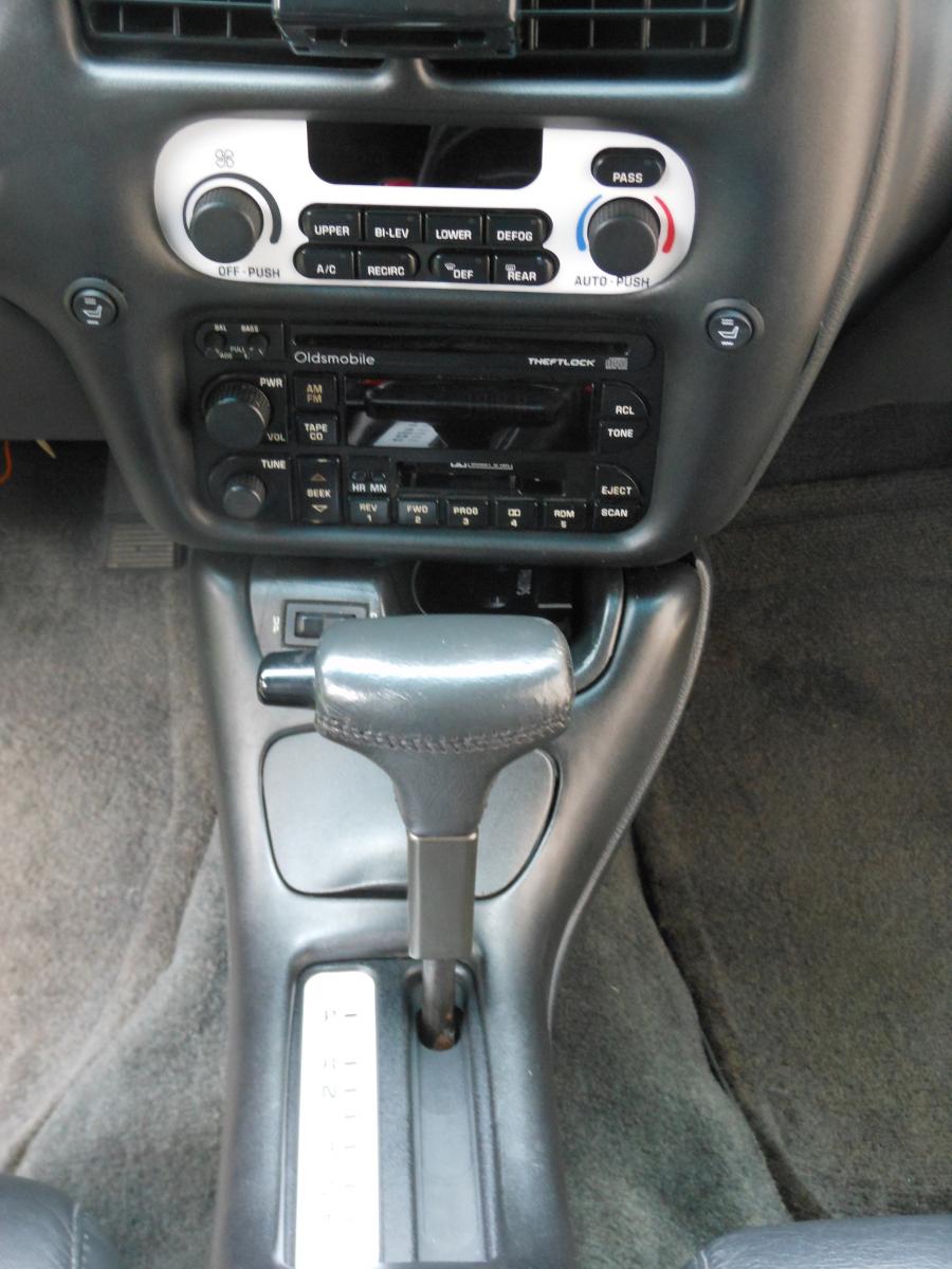

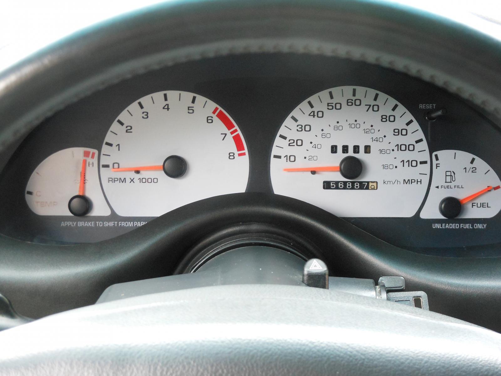

oldsl67 Posted October 9, 2014 Report Posted October 9, 2014 Do you want to update your dash of your 95-97 Cutlass? Check out what I found at WhiteGauges.net. They just came out with the Heater Control face overlay. I had them make the Console Shifter overlay for me. They will make any item you want. They did a very good job. The Headlight Switch is also a brand new product. Quote
Imp558 Posted October 9, 2014 Report Posted October 9, 2014 Wow, that looks pretty neat, looks like a pillar pod there too. Quote
GOT2B GM Posted October 10, 2014 Report Posted October 10, 2014 Hmmmmm gives me ideas for the white vert. Are those the stock needles? Sent from my Z30 using Tapatalk Quote
GOT2B GM Posted October 10, 2014 Report Posted October 10, 2014 They only list the cluster overlay, where do I find the others? Sent from my Z30 using Tapatalk Quote
oldsl67 Posted October 10, 2014 Author Report Posted October 10, 2014 Yes, you have to sand off the white paint and use orange so they will show up. They have other colors of gauges besides white also. Quote
oldsl67 Posted October 10, 2014 Author Report Posted October 10, 2014 They told me about them when I contacted them on the phone. I got the 194 LEDs also and the sockets they gave me at first (green) didn't work. If you get the LEDs make sure you ask for the Black sockets (they don't list these anywhere on the site). When I called them about that problem they told me they just got the headlight & heater control made and would I want a set. These people were great to work with for any info and they made the shifter overlay from a sample I sent in. Quote

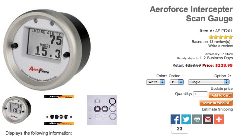

tsilney Posted October 10, 2014 Report Posted October 10, 2014 That looks good. I need some for my white 95. What gauge pod do you have as well? Sent from my SCH-I545 using Tapatalk Quote
oldsl67 Posted October 10, 2014 Author Report Posted October 10, 2014 I got the AeroForce gauge from ZZP. The price seems a little high but it does it all in 1 gauge. Look it up on YouTube and you won't believe all the stuff it does. Very Cool. Quote
tsilney Posted October 10, 2014 Report Posted October 10, 2014 (edited) Aero forces rock I have one for my gtp..i was wondering what gauge pod you used to put it in. Sent from my SCH-I545 using Tapatalk Edited October 10, 2014 by tsilney Quote
oldsl67 Posted October 10, 2014 Author Report Posted October 10, 2014 I don't remember what brand it is but I got it at Auto Zone. Quote
Turbocharged400sbc Posted October 12, 2014 Report Posted October 12, 2014 the 04+ gp needles will work, the clear red needles Quote

pshojo Posted October 17, 2014 Report Posted October 17, 2014 Quick question, how well can you see through the headlight and HVAC overlays? How much did it dim? I converted my instrument cluster to LED it was best thing to do. Quote
oldsl67 Posted October 17, 2014 Author Report Posted October 17, 2014 You really need the LEDs on the instrument cluster it dims it alot. The headlight and HVAC seem to be about normal but I just got a headlight switch that has the working backlight. I still can't get the 4 outside bulbs on the HVAC to work. Any tips on those. Those bulbs seem to be part of the board, can you change them? Quote
pshojo Posted October 18, 2014 Report Posted October 18, 2014 I'm going through a guy in Chicago to change to led. I did switch to led on the instrument cluster. Used white and the gauges look bright blue , love it. Tried blue last year and it turned odometer blue too, didn't like that as much. Quote
tsilney Posted October 18, 2014 Report Posted October 18, 2014 Just ordered the white face gauge and the other overlays. I did my cluster with white leds and it turned blue..not sure how I feel about it not matching everything else..I ordered green leds to see if they will match more like stock. Also did all the interior bulbs as well with white leds..looks sweet now. Sent from my SCH-I545 using Tapatalk Quote

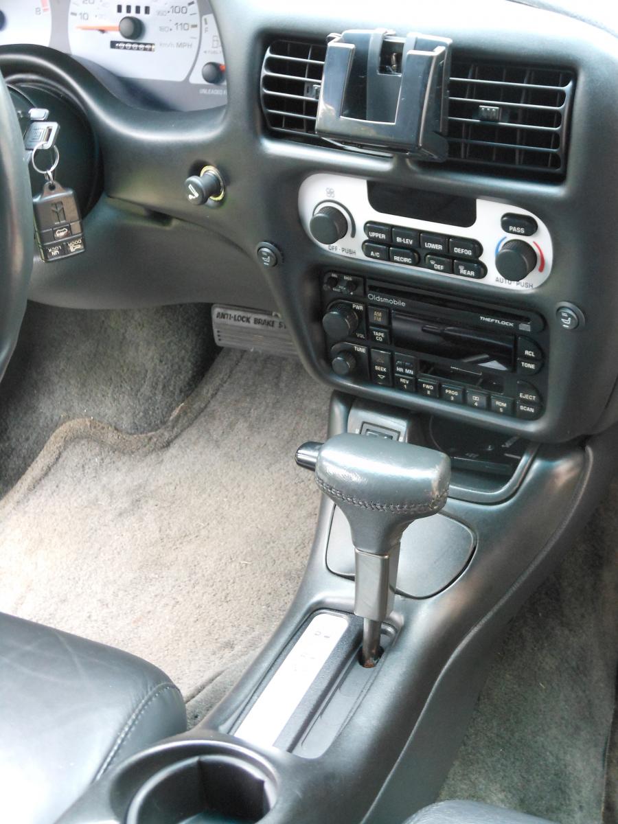

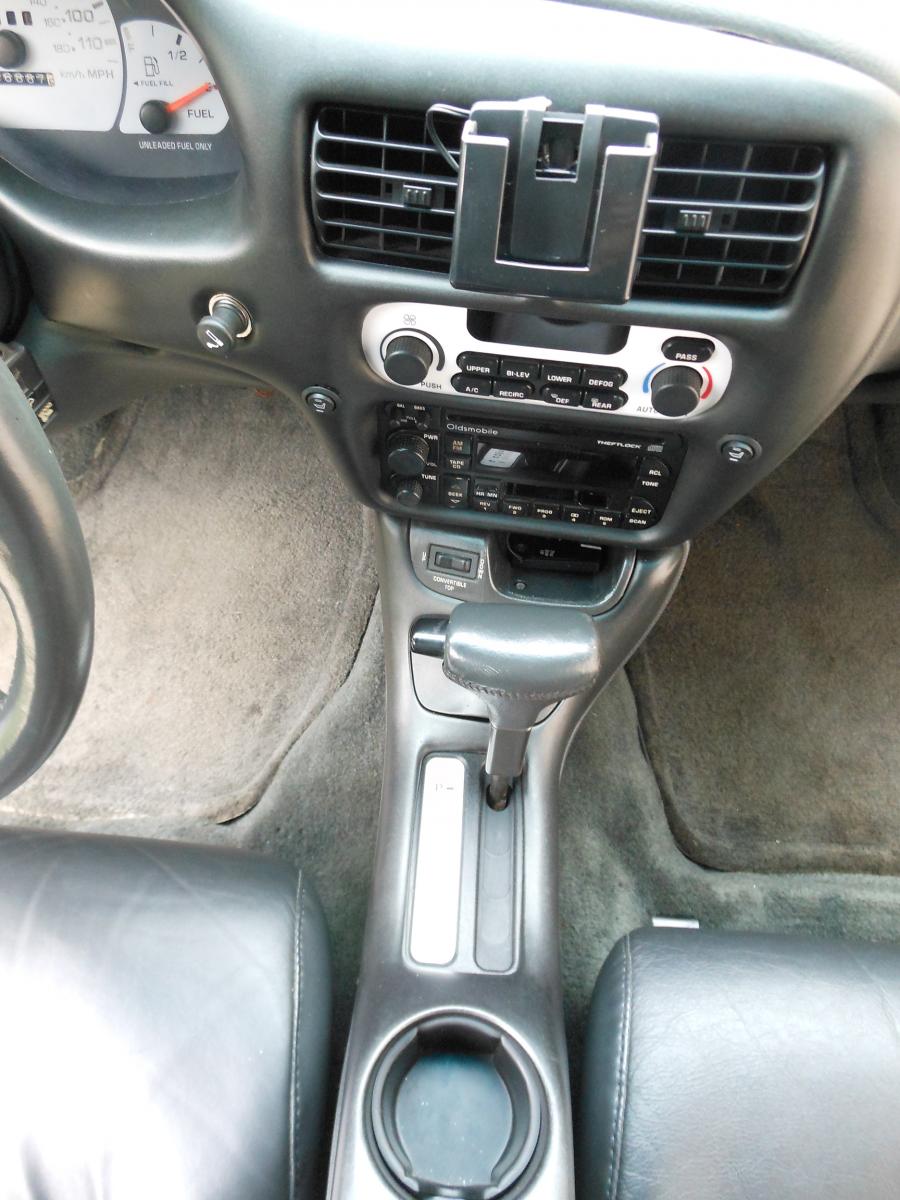

oldsl67 Posted October 21, 2014 Author Report Posted October 21, 2014 My dash lights aren't that bright with the overlays. I love the Roll bar lights. What bulbs does it take? I want to do that to my 95 vert also. Here are some pics of the white face in my vert with Gray interior. Notice the Seat Warmer Switches on each side of Radio. Cool add-on. Quote
tsilney Posted October 21, 2014 Report Posted October 21, 2014 I cant wait to get my overlays...i like the heated seats..I only use the vert in summer but its a sweat idea..I.got the leds for the roll bar with the new switches from a memebr on this forum that sells them..like 12 bucks...the others I got.on ebay pretty cheap...my vert is white so.think the white in the dash will look good. Sent from my SCH-I545 using Tapatalk Quote

The Guz Posted November 9, 2014 Report Posted November 9, 2014 Just ordered the white face gauge and the other overlays. I did my cluster with white leds and it turned blue..not sure how I feel about it not matching everything else..I ordered green leds to see if they will match more like stock. Also did all the interior bulbs as well with white leds..looks sweet now. Looks good. I'm interested in seeing how green LEDs turn out. The blue filter is what makes the bulbs look blue. My 02 Camaro is the same way. I had these overlays on my 99 Grand Prix in silver with the black lettering. The black lettering limited the light output and the dash looked dim. Just passing that along to others. Quote
