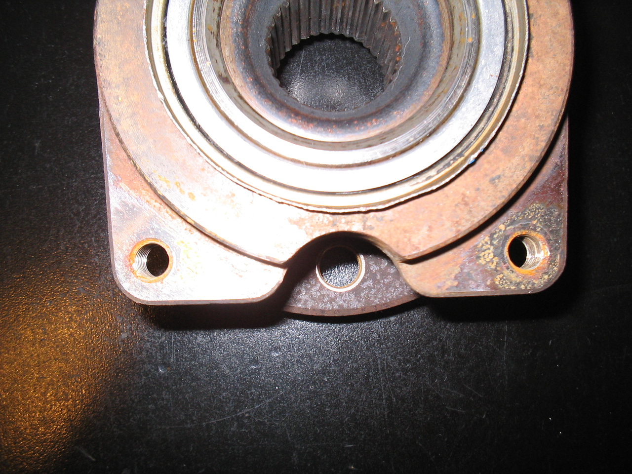

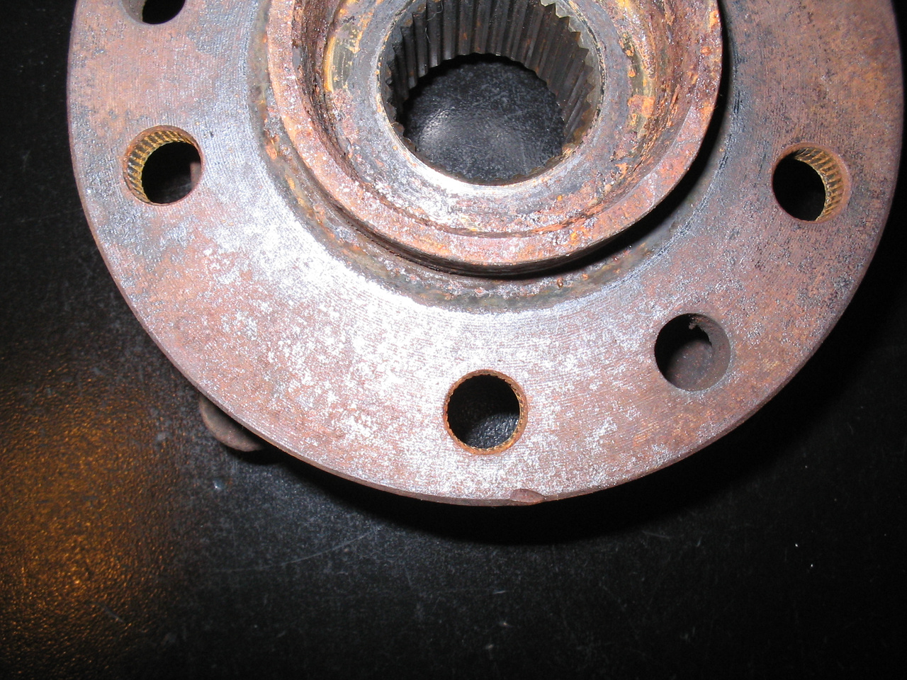

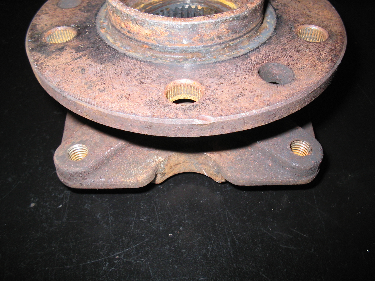

Quaraxkad Posted September 28, 2014 Report Posted September 28, 2014 Let's take a look around and examine that hub... Quote

Quaraxkad Posted October 1, 2014 Report Posted October 1, 2014 Standard length studs should not require removing the hub. As shown in the pictures above, the bottom of the hub has a cutout for exactly this purpose. It gives enough clearance for stock length studs to be installed and removed. Longer studs will require the hub to be removed. Quote
GnatGoSplat Posted October 1, 2014 Report Posted October 1, 2014 I'm aware of the cutout. It does not give enough clearance for stock length studs. If you look carefully at Deacon's pic, you will see he has the back of the stud resting against the knuckle. Quote
