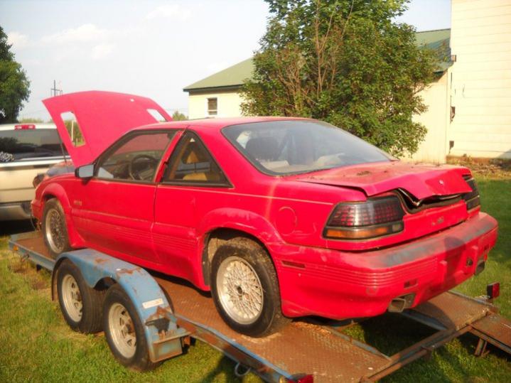

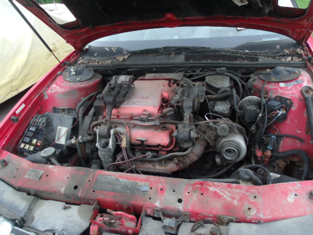

turbograndprix Posted September 15, 2014 Report Posted September 15, 2014 Hey guys, I picked up a 1990 turbo grand prix for parts. The body is completely shot , wish it wasn't. Anyways it appears someone switched out the front suspension and put a regular one back. Should I upgrade to a gen two subframe , control arms and struts? Also what do I need to swap over to a 92 go that was originally a 3.1 na. Thank you in advance. I am a owner of a 2002 gp turboed and getting back into gen one Quote
intern8tion9l Posted September 15, 2014 Report Posted September 15, 2014 What do you mean put a regular suspension back in? the motor swap is pretty straight forward, there is probably a list somewhere. I did the swap on a 2.8 cutlass supreme. if you can keep both cars for a while that would make it easier so you don't run into finding that you've forgotten a part Quote
turbograndprix Posted September 15, 2014 Author Report Posted September 15, 2014 Regular suspension as in off a non turbo model. Is there a known thickness of the spring. So I can measure it Quote
intern8tion9l Posted September 17, 2014 Report Posted September 17, 2014 I thought they were the same Quote
intern8tion9l Posted September 17, 2014 Report Posted September 17, 2014 (edited) Off the top of my head, it's been awhile: motor and everything bolted to it trans trans cooler located in right front fender intercooler and piping radiator radiator top support(the black plastic/fiberglass thing) Cooling fans coolant overflow bottle engine wiring harness from the firewall forward including ECM with memcal exhaust from the turbo back intake if you want to use it I'll add what I remember, others may chime in too Edited September 17, 2014 by intern8tion9l Quote

intern8tion9l Posted September 19, 2014 Report Posted September 19, 2014 Where outside of the city are you located? What are you basing it being shot on, besides the fubared trunk lid Quote
