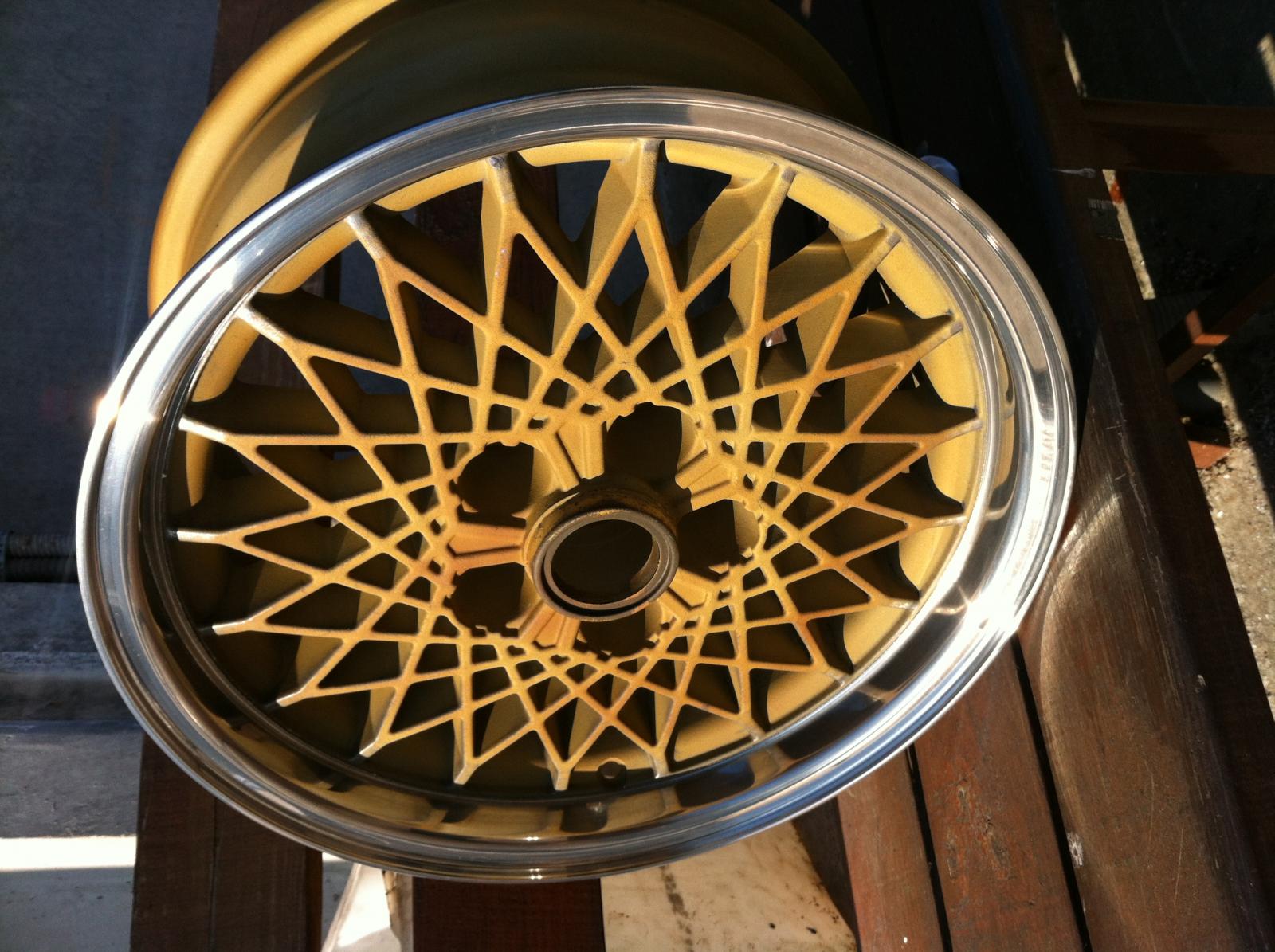

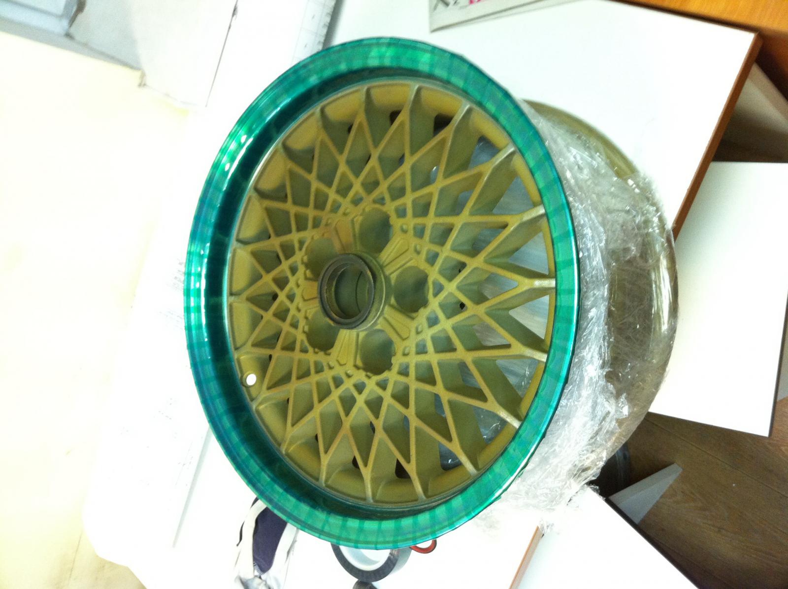

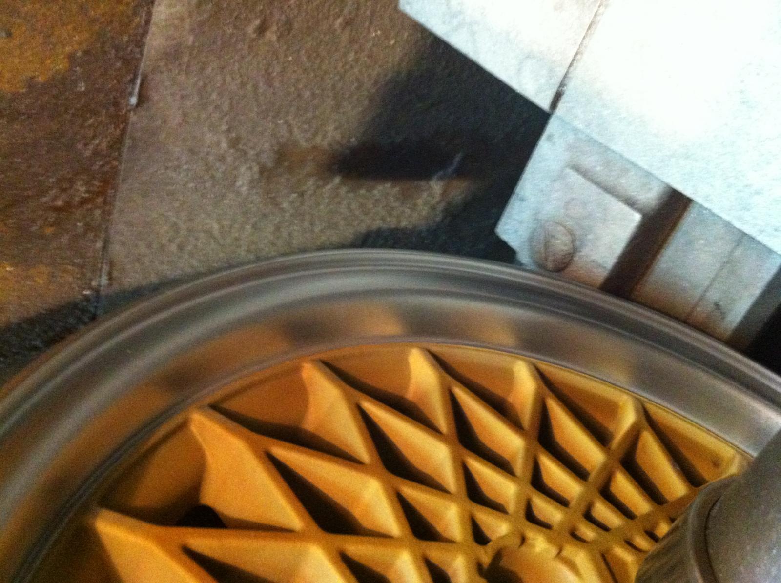

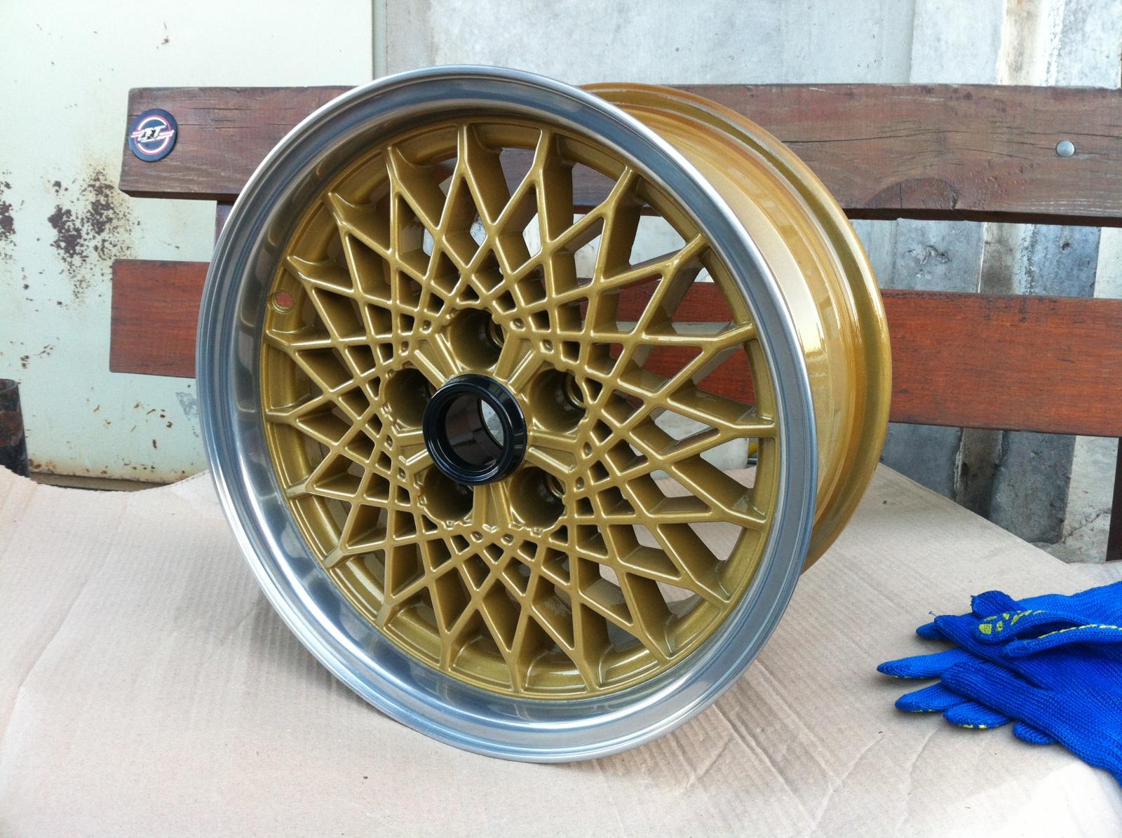

shurup Posted September 13, 2014 Report Share Posted September 13, 2014 Began the process of preparation for painting rims. The central part is painted in gold color, the shelf is polished. [video=youtube;8y-yER1bCYE] Quote Link to comment Share on other sites More sharing options...
94 olds vert Posted September 13, 2014 Report Share Posted September 13, 2014 That polished lip on those wheels looks amazing. Quote Link to comment Share on other sites More sharing options...
Heartbeat1991 Posted September 13, 2014 Report Share Posted September 13, 2014 WOW. . Puts mine to shame. . .I did mine by hand. I might have to get them done professionally on a machine seeing those. . . Quote Link to comment Share on other sites More sharing options...
Psych0matt Posted September 14, 2014 Report Share Posted September 14, 2014 I like that you called it the "shelf"! Great work though! Quote Link to comment Share on other sites More sharing options...

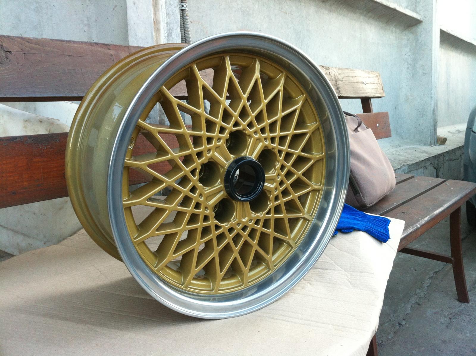

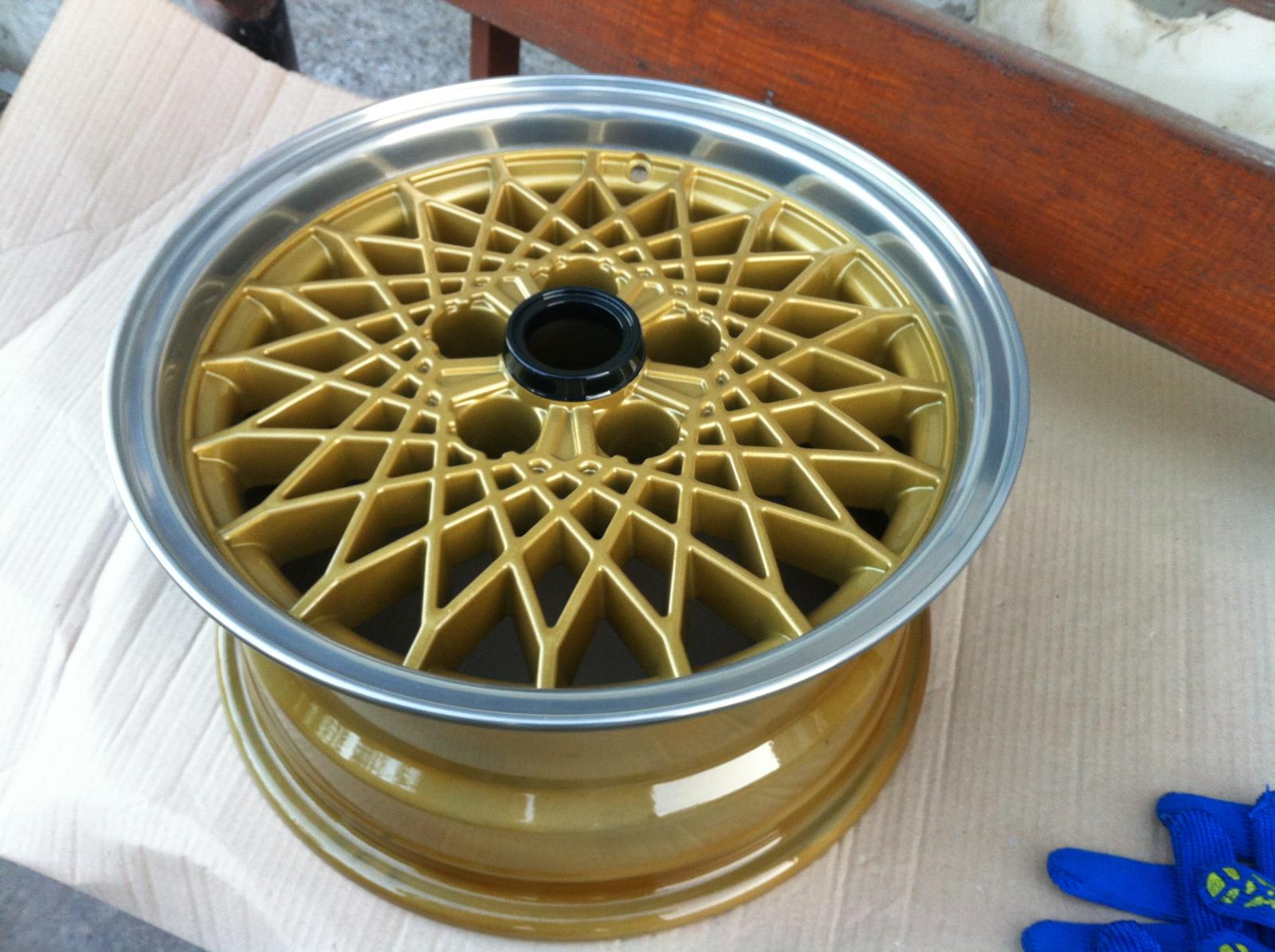

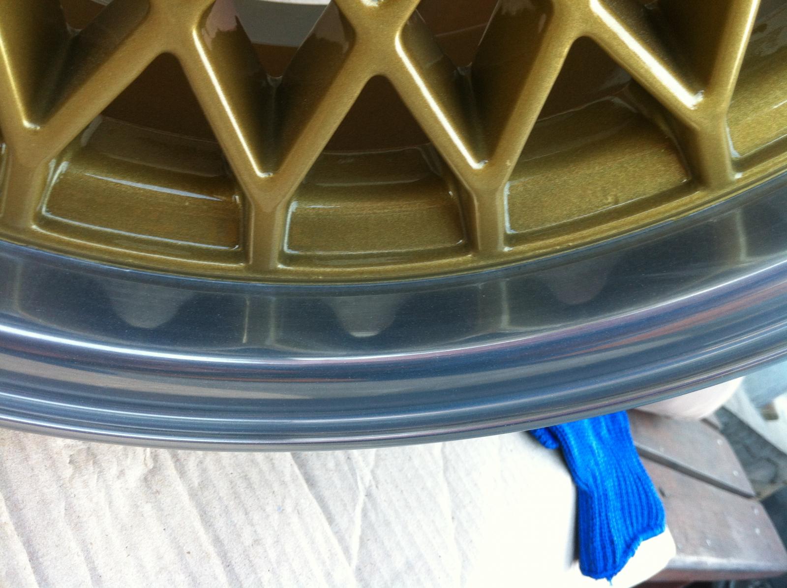

shurup Posted September 15, 2014 Author Report Share Posted September 15, 2014 Quote Link to comment Share on other sites More sharing options...
shurup Posted September 16, 2014 Author Report Share Posted September 16, 2014 yeah Quote Link to comment Share on other sites More sharing options...
94 olds vert Posted September 16, 2014 Report Share Posted September 16, 2014 Amazing! Quote Link to comment Share on other sites More sharing options...
Heartbeat1991 Posted September 16, 2014 Report Share Posted September 16, 2014 Is this painted or powder coated? Was it expensive to do? Quote Link to comment Share on other sites More sharing options...
shurup Posted September 17, 2014 Author Report Share Posted September 17, 2014 Is this painted or powder coated? Was it expensive to do? Â Its powder coated. It was inexpensive, because I did it all on your own production Quote Link to comment Share on other sites More sharing options...

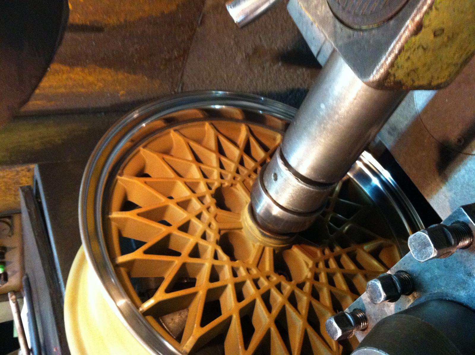

Heartbeat1991 Posted September 17, 2014 Report Share Posted September 17, 2014 What color was the powder you used? I don't have a machine to polish the rim like that. I might have to send them out. Quote Link to comment Share on other sites More sharing options...
55trucker Posted September 17, 2014 Report Share Posted September 17, 2014 What color was the powder you used? I don't have a machine to polish the rim like that. I might have to send them out. Â Â You can do the polishing with the wheel on the car, all one needs is to have the wheel spinning, use some 1500 & then 2000 grit wetpaper first & then polish with a buffer and some jewelers rouge. Quote Link to comment Share on other sites More sharing options...

Heartbeat1991 Posted September 17, 2014 Report Share Posted September 17, 2014 You can do the polishing with the wheel on the car, all one needs is to have the wheel spinning, use some 1500 & then 2000 grit wetpaper first & then polish with a buffer and some jewelers rouge. Â I tried it with metal polish. it didn't come out bad, but not as good as his. I might try again. Quote Link to comment Share on other sites More sharing options...
55trucker Posted September 17, 2014 Report Share Posted September 17, 2014 As the car is white, and gold discs, may be it makes sense to replace the door logos on gold? Â Â That would be a personal preference, it's a matter of choice and nothing more, I took off all the badges (logos) from my car, personally I like *white on white* badges, but you do what you feel comfortable with, it's your car, there's no real *right or wrong*. Quote Link to comment Share on other sites More sharing options...
55trucker Posted September 17, 2014 Report Share Posted September 17, 2014 I tried it with metal polish. it didn't come out bad, but not as good as his. I might try again.[ATTACH=CONFIG]17049[/ATTACH] Â Did you remove the clear coating before you attempted to polish the lips? Â That has to come off first or you're just putting polish on the clear coating and doing nothing to the aluminum itself. Â Â (not to hijack a thread)................. Â Â Quote Link to comment Share on other sites More sharing options...
Heartbeat1991 Posted September 17, 2014 Report Share Posted September 17, 2014 I actually stripped the entire wheel and repainted the gold/black. Quote Link to comment Share on other sites More sharing options...

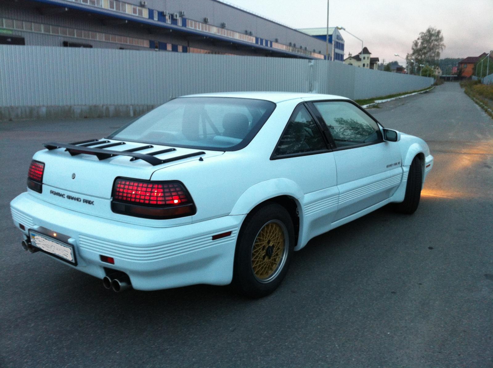

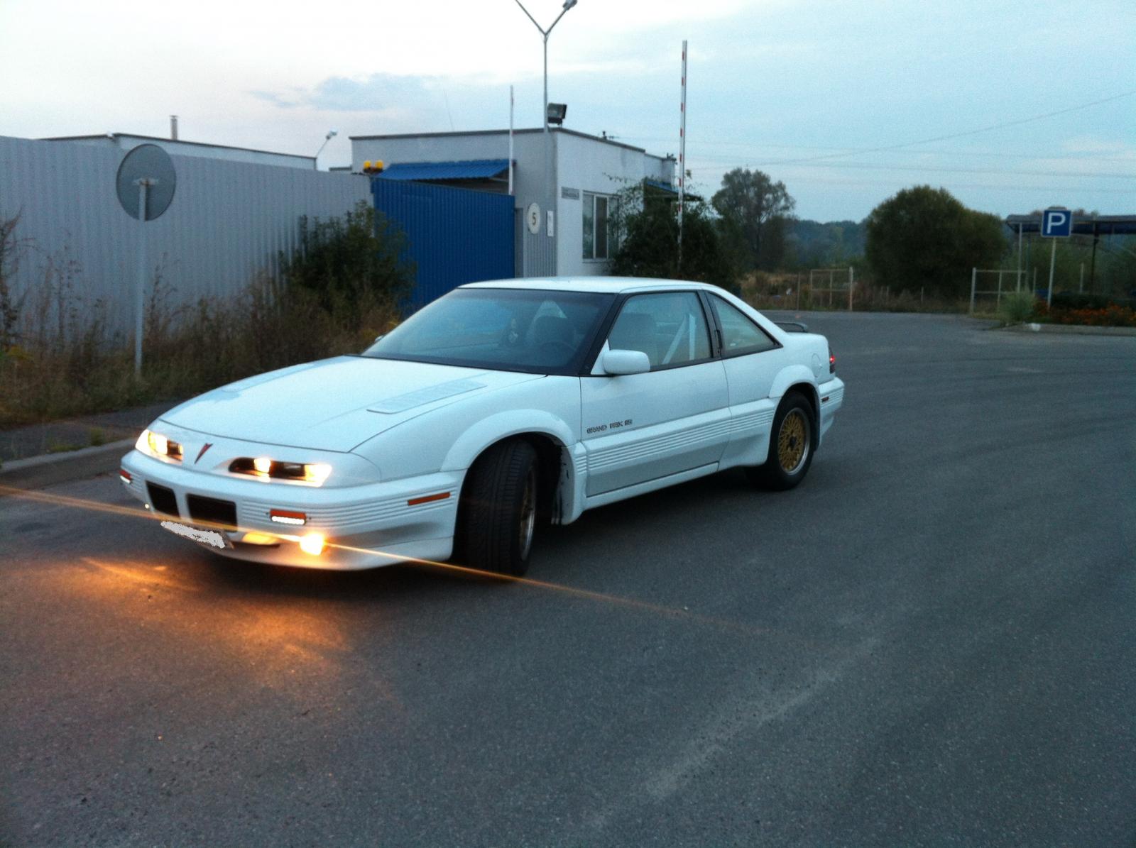

shurup Posted September 27, 2014 Author Report Share Posted September 27, 2014 Photo with rims Quote Link to comment Share on other sites More sharing options...
carkhz316 Posted September 27, 2014 Report Share Posted September 27, 2014 Woof. That thing is clean. I spy the 2nd gear switch. Quote Link to comment Share on other sites More sharing options...
shurup Posted September 27, 2014 Author Report Share Posted September 27, 2014 Woof. That thing is clean. I spy the 2nd gear switch. Â yes, last photo special for you Quote Link to comment Share on other sites More sharing options...
intern8tion9l Posted September 27, 2014 Report Share Posted September 27, 2014 So that's what a white tgp would look like. Almost.... Quote Link to comment Share on other sites More sharing options...
19Cutlass94 Posted September 27, 2014 Report Share Posted September 27, 2014 So that's what a white tgp would look like. Almost.... Â Do it. Quote Link to comment Share on other sites More sharing options...
94 olds vert Posted September 27, 2014 Report Share Posted September 27, 2014 Amazing looking car! Looks stunning. Quote Link to comment Share on other sites More sharing options...
