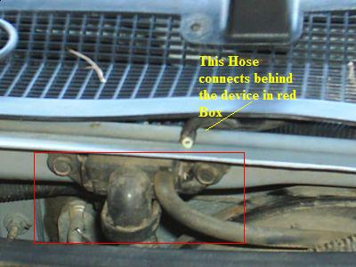

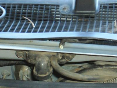

Well I fixed the problem. Instead of trying to remove the wiper arms and pulling off the cowl cover. I was going to consider drilling a hole, and buying a small plastic connector to fit through the hole and hook the hoses together. I found a existing hole from a bracket that was holding the wiring loom to the device in the picture. I used that access to hook up the hoses together. It was a cheap $4.00 part to hook the hoses together.
I'll post some pictures to show what I did.
