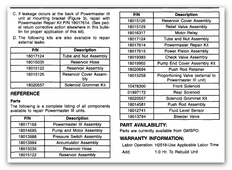

Heartbeat1991 Posted September 6, 2014 Report Posted September 6, 2014 Does anyone have a parts diagram of the PMIII that might show seals? Mine has a leaking seal in the motor/pump. There is a seal that keeps the fluid from traveling from the pump into the motor. I need that seal. Quote

Heartbeat1991 Posted September 7, 2014 Author Report Posted September 7, 2014 I'll look later today and see what I can come up with. Thanks. I was looking for a PMIII shop manual. But I haven't found on yet. I took apart another PMIII I have to make one good one between the two. But I still want to fix the other one, if I can. The seals on the pump seem to be in bad shape on it. Of course, I got it working, put it on the car, and found the plaid to be pumping out of a line in the rear. So I just put a new line on it. Thanks for looking for me. It would be nice to find some the seals I need to repair the spare one. Quote
55trucker Posted September 8, 2014 Report Posted September 8, 2014 (edited) From my '91 FSM....... Edited September 8, 2014 by 55trucker Quote
Heartbeat1991 Posted September 8, 2014 Author Report Posted September 8, 2014 Yeah, I've got that. I was hoping for a more comprehensive list. I am looking for the seals that are in the pump/motor assembly. I might be up a creek for them. I don't know yet. Quote
