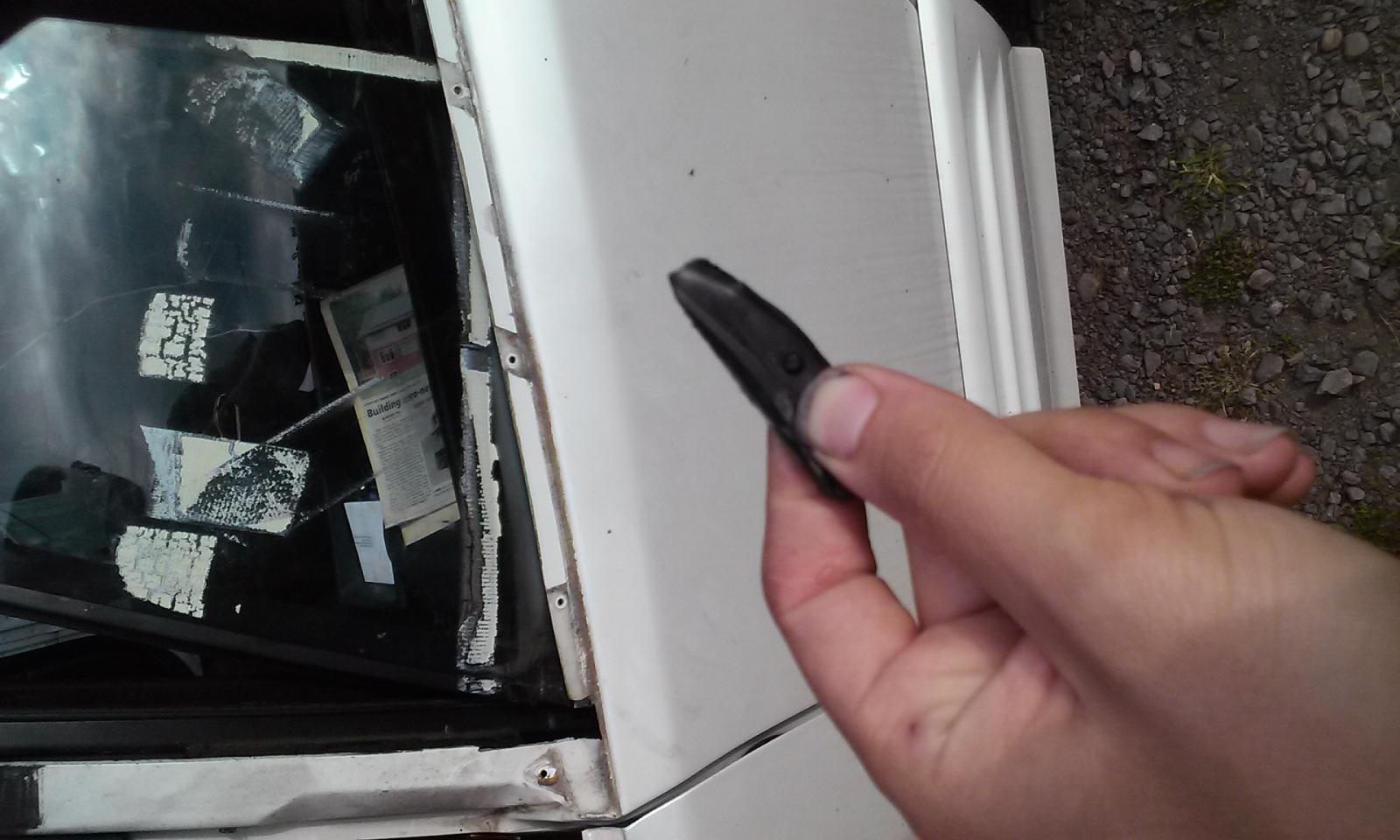

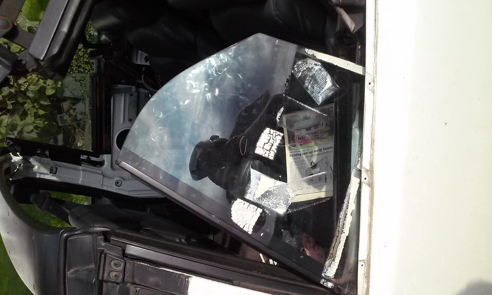

My drivers side rear quarter window isn't going up or down without fighting it and it always jams because there is so much play that I can literally pull the window back. It even ripped the guides that are secured to the front window, but the window is in the guides. Any help would be greatly appreciated.

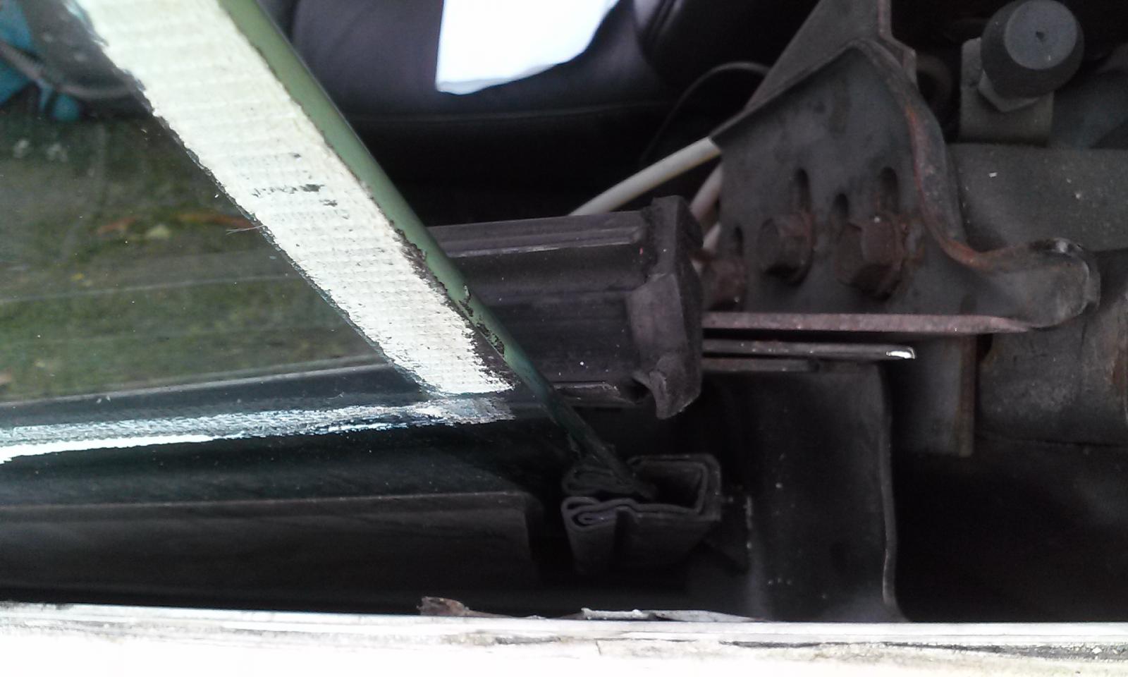

Ok I figured it out. It turns out that the guides on the front of the window broke somehow which was why the window was moving all around. Luckily there was a vert in my local yard so I used them to fix the issue. Are these guides vert specific or can i get them off of any gm car?
