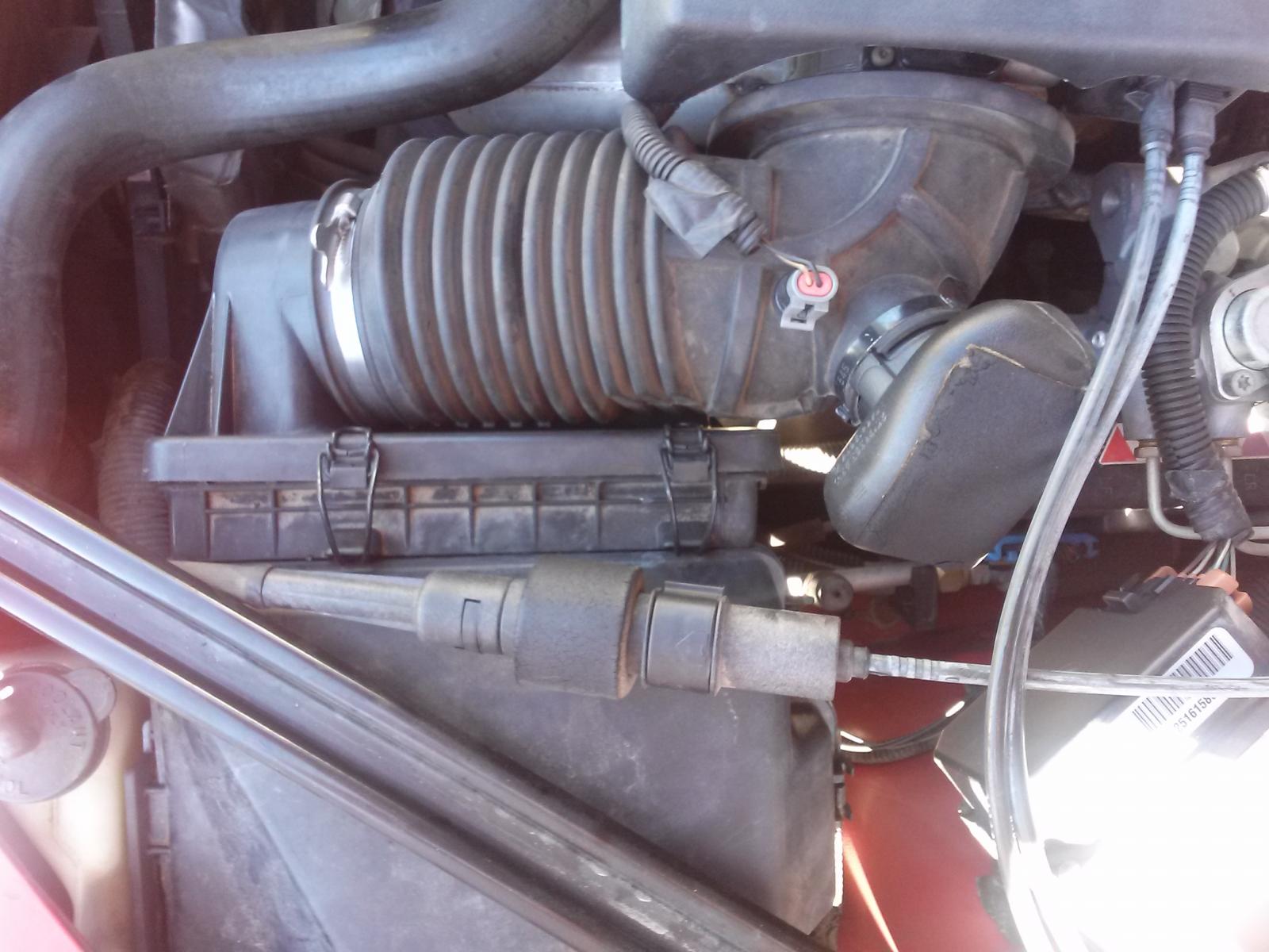

Yeah that's what I want, to increase the whine. It isn't noticeable at all unless it's a cold day or at higher RPMs. On my 97 GTP though the stock system is not fine. It has two big bends on each side of the intake tubing and the PCM blocks about 3/4 of the intake opening. That's why a drop in filter would do no good.
97s and 98s had an inferior intake compared to the 99+. The newer intakes have no bends.

This is what the stock intake box looks like. A big bend to get through the filter, with the PCM right in front of the filter then into the tubing then a small bend going to the throttle body. post-10811-143689167246_thumb.jpg
I know I would get a closed iintake like that like from ZZP or Thrasher but then I also gotta buy a 99+ coolant bottle and move it. I wish I had a 99 or newer it would be so much simpler.
