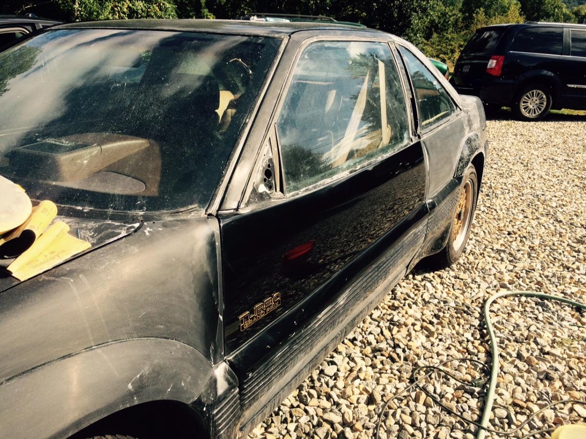

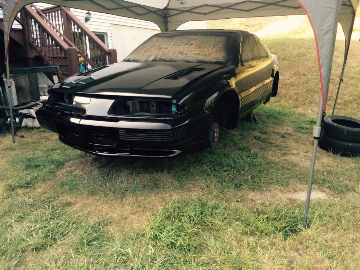

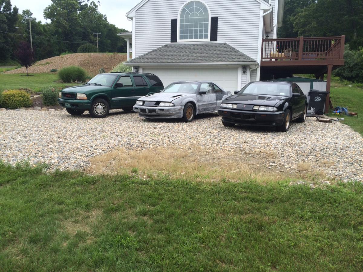

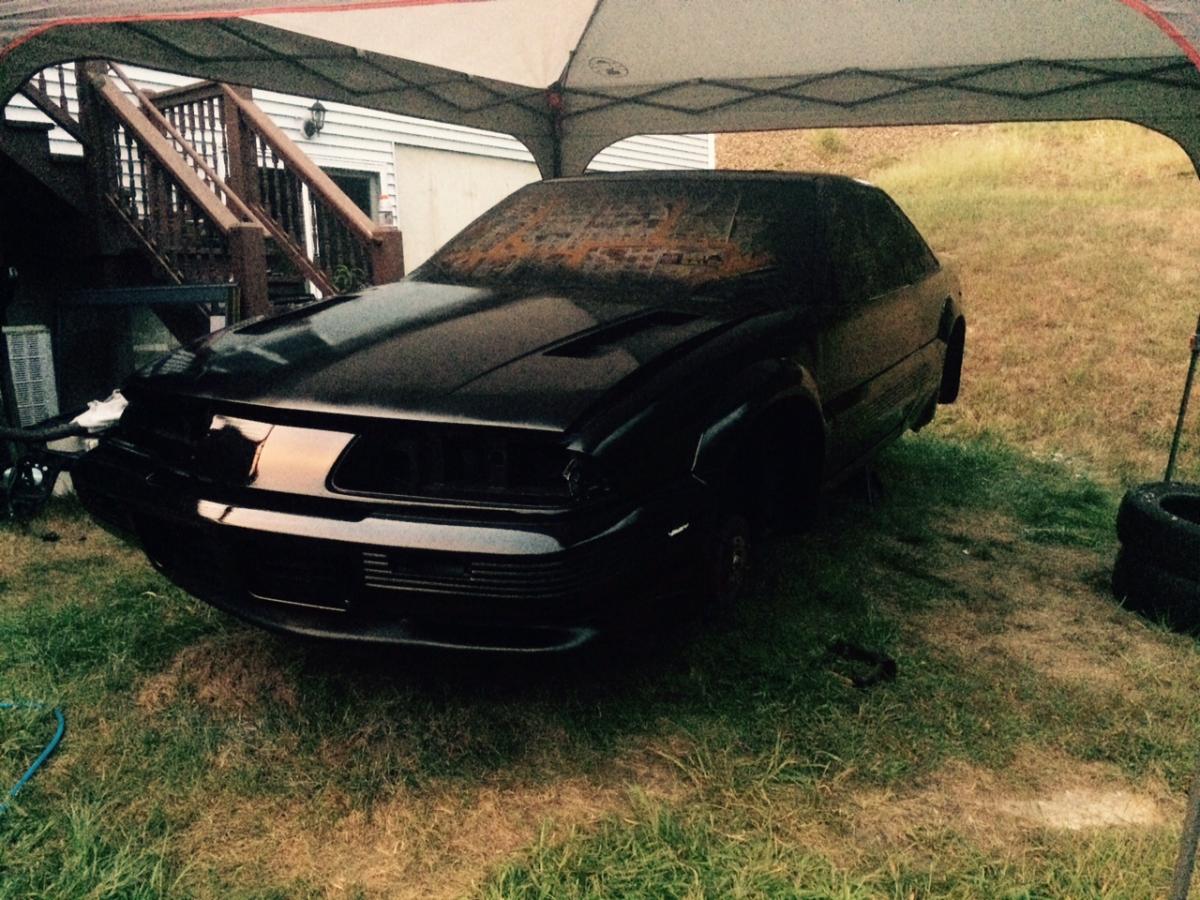

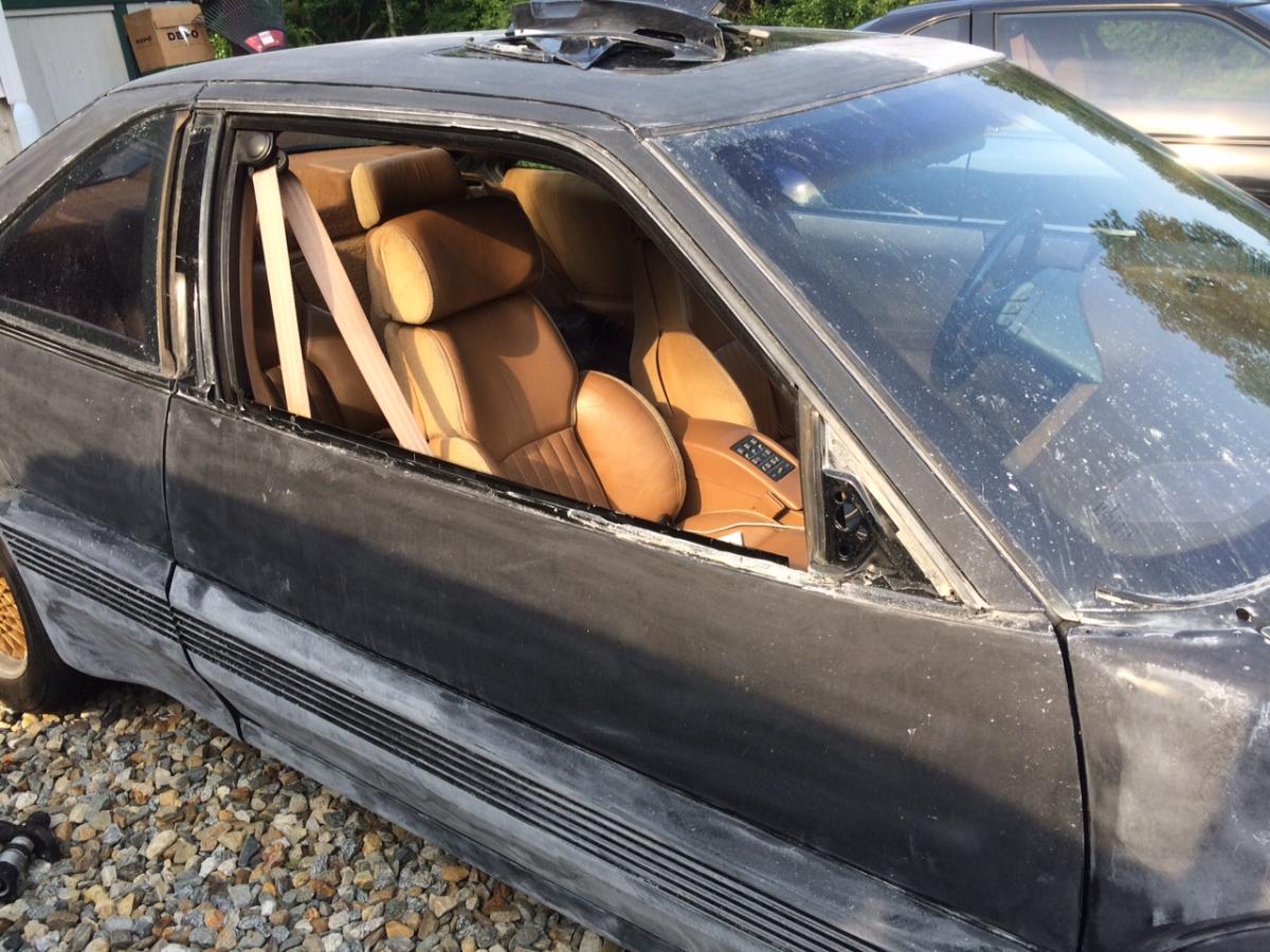

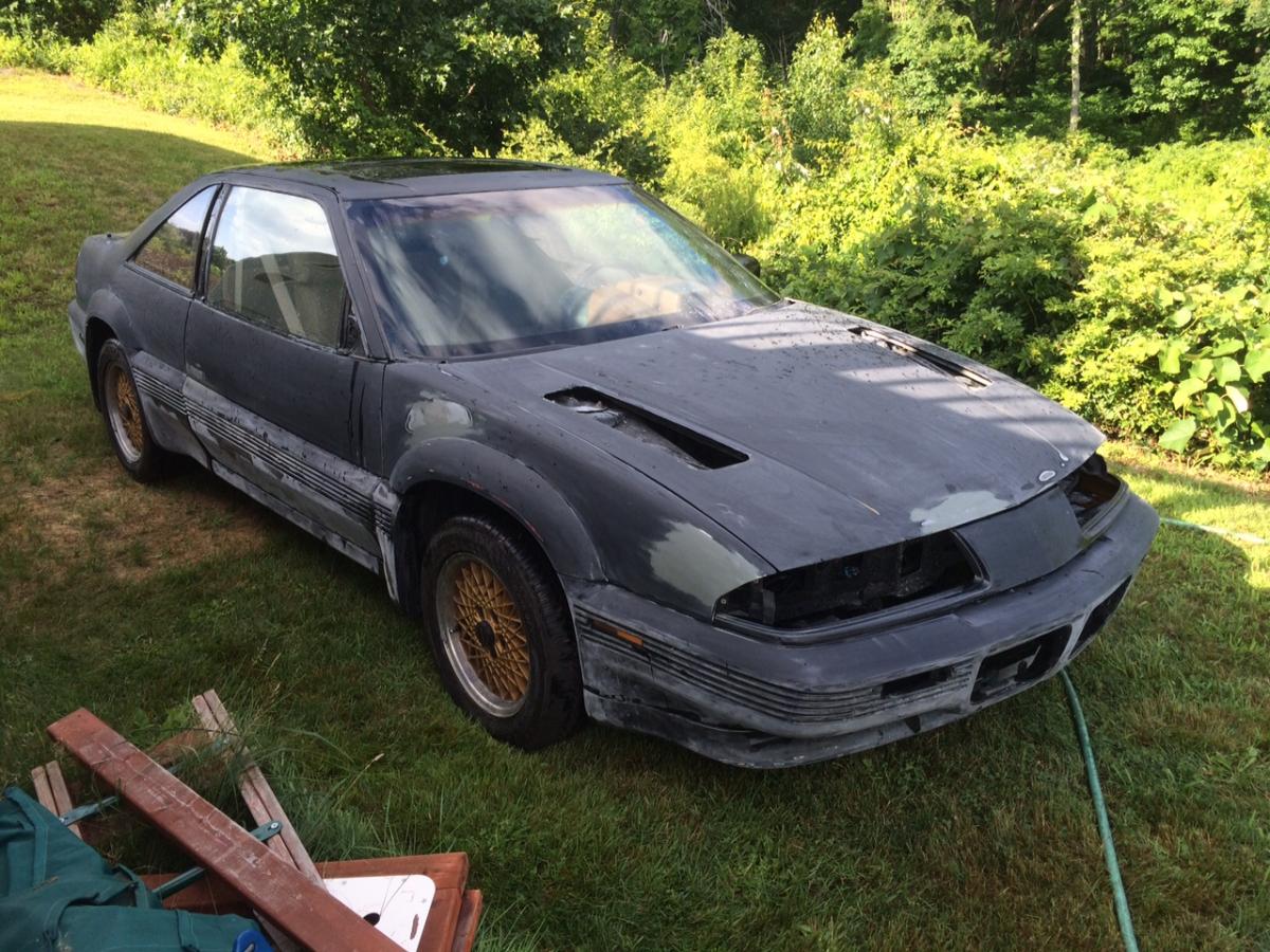

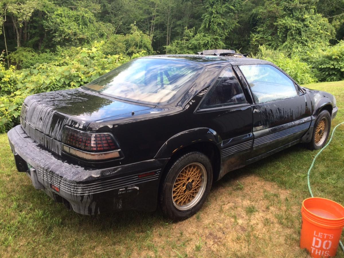

Heartbeat1991 Posted July 25, 2015 Author Report Posted July 25, 2015 What a coincidence, I just googled this thread to update it. I am in the process of painting the car again. As I had stated once before, I wasn't happy with the paint job from last year. I also bought TGP #3 a couple months ago, so I am likely going to sell this one soon. I picked up some parts to take care of a few odds and ends before it goes up for sale. It's nearly perfect, so I plan to complete it. I'll post up a couple pics of the current work on it. Quote

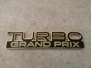

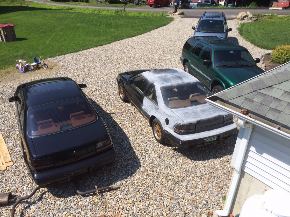

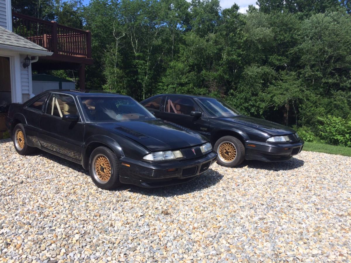

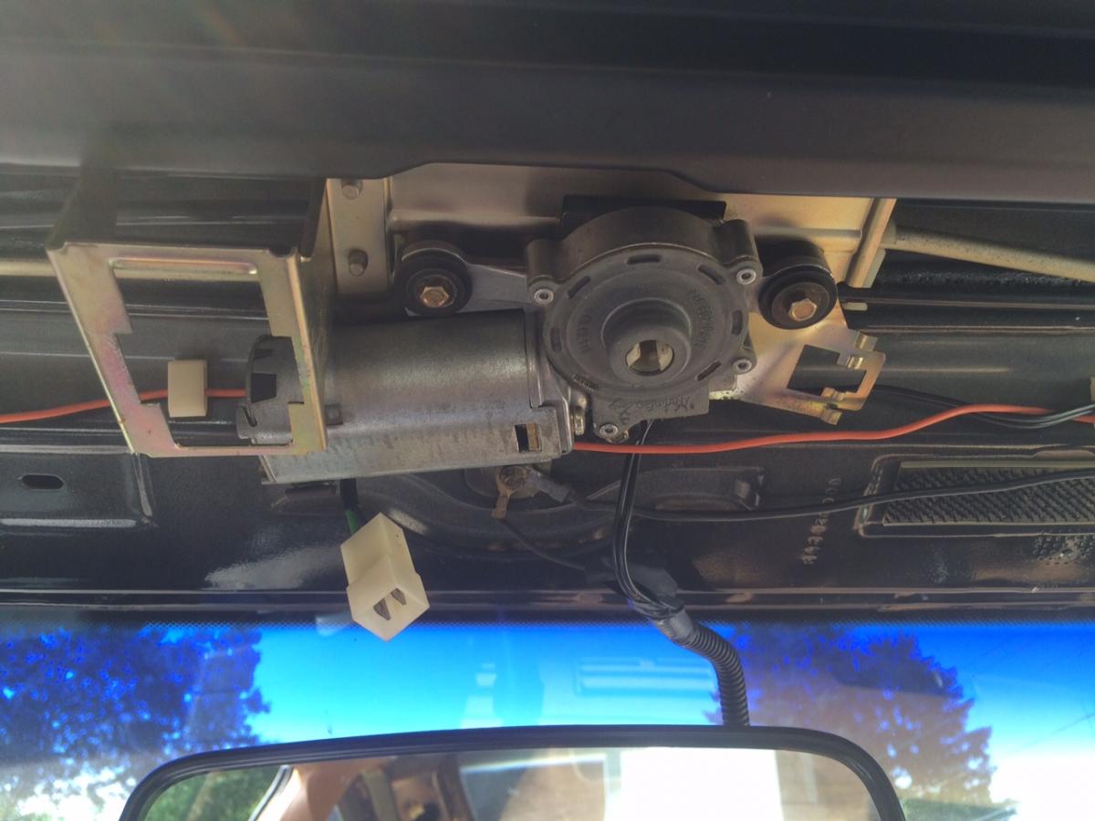

Heartbeat1991 Posted July 25, 2015 Author Report Posted July 25, 2015 Here are some pics. The sunroof motor seems to have quit, so I am replacing it. I bought new Turbo emblems for it. The last pics are as it was before I started the sanding to repaint it. The one in the foreground is #2, and #3 is in the background. Quote
jman093 Posted July 31, 2015 Report Posted July 31, 2015 Nice progress. Have you found a sunroof motor? Quote
Heartbeat1991 Posted July 31, 2015 Author Report Posted July 31, 2015 Nice progress. Have you found a sunroof motor? Yes. The Shantz house of W had one. Thanks. Hoping to spray it in a couple hours. I'll update soon. Quote

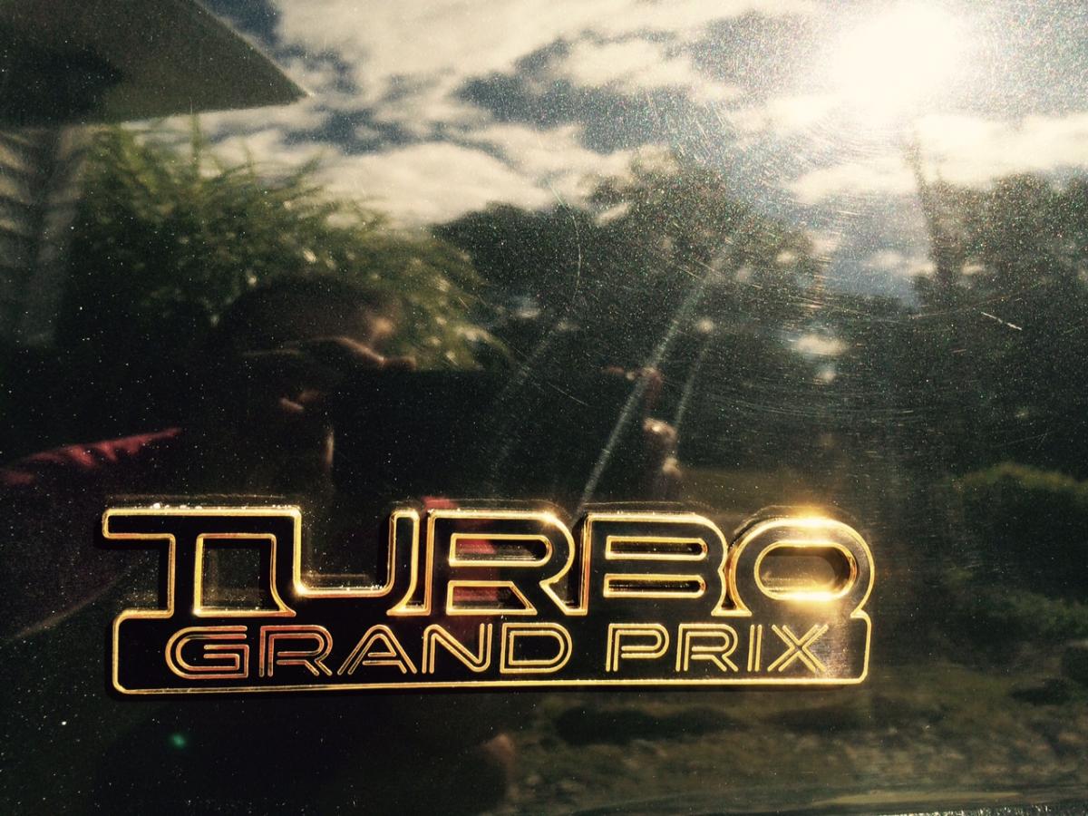

Heartbeat1991 Posted September 14, 2015 Author Report Posted September 14, 2015 Some rubbing to and polishing done. New TGP badge looks pretty nice on there. Quote
