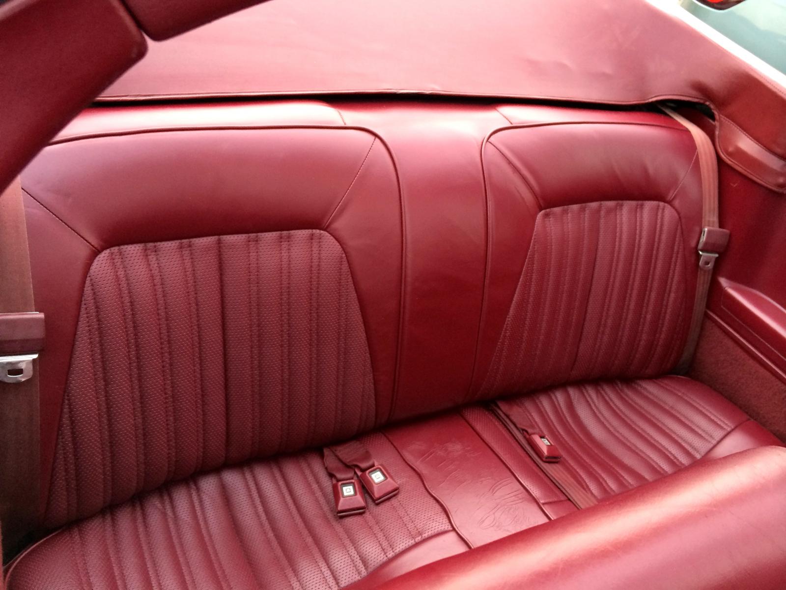

GOT2B GM Posted August 12, 2014 Report Posted August 12, 2014 3.4 93-94 convertibles had rear buckets. All others had solid non pass thru benches. Rear trim is the same. I installed a pass thru rear bench from a coupe into my 93 vert I had, bolted right in, although the pass thru wasn't good for much more than top pump access. Sent from my Z30 using Tapatalk Quote

GOT2B GM Posted August 13, 2014 Report Posted August 13, 2014 pass thru bench in my old 93 vert Quote
