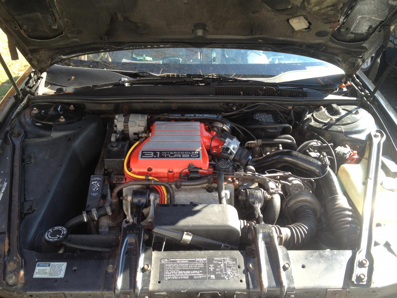

Z34-5speed Posted August 3, 2014 Report Posted August 3, 2014 Hey everyone! Been away from the forum ever since I sold my 92 Z34. I think i've popped in a few times with some updates to my Turbo Geo Metro project, but have been absent otherwise...until now! I picked this up last night for $500. 1990 TGP. Arizona Car. 72,000 miles. Couldn't get any good pics due to shitty lighting and my cell phone, but here's what I have: Story behind the getting the car: I was driving to deliver a part to my Girlfriend's dad's shop for her truck. They live in the middle of nowhere Alabama, which I can assure you, is in the middle of nowhere. I'd only been to their "town" at night. This time it was daylight. When I pulled into her house, I noticed the GP sitting in a driveway across the street. I asked the GF who's it was and she said it was her 19yr old Nephews (they live across the street). She said something was wrong with it and that it had been sitting. I then asked to go look at it and about fell over when I did. Turns out: The brake system is acting up. Needs a hydroboost setup (don't know shit about it). Is able to be moved around, but not actually driven. It is using a 96 Geo Metro master cylinder ATM, lol. My GF's dad has done the work on the car. It has a new Fuel Pump (not sure if they used the correct one, or just a regular GP pump), new Alternator, and new belts. I asked if they'd be interested in selling it. I was told $500 would take it, since they just wanted to get another car ASAP. I practically threw the money at them. It has a few other minor issues: The drivers side of the seat is torn. Other seats are very clean. Carpet is coming up, but also is clean. They don't know the combination to the glovebox. The gauges are a bit wonky. Tach is way off, as is the speedo, however the HUD works perfectly and the speed on it is correct. A/C works great, but the climate control panel is broken in a few spots. CD player WORKS. I've moved it to his shop for storage till I can either fix it there, and drive it home, or tow it here. I'll be keeping this updated! Such excite! Wow! Kyle Bonus Pic of the Geo as of the other day, my current car, and my old Lumina: Quote
Nas Escobar Posted August 3, 2014 Report Posted August 3, 2014 Congrats on your purchase!!! The GP... not the FT... lmao What's wrong with the passenger's side door though? It looks as if it has holes there. Quote
mfewtrail Posted August 3, 2014 Report Posted August 3, 2014 Nas Escobar said: What's wrong with the passenger's side door though? It looks as if it has holes there. Faded clear/bad paint most likely. Quote
Heartbeat1991 Posted August 4, 2014 Report Posted August 4, 2014 Looks good. I don't know about that brake setup, but it's fixable. LOL. Quote

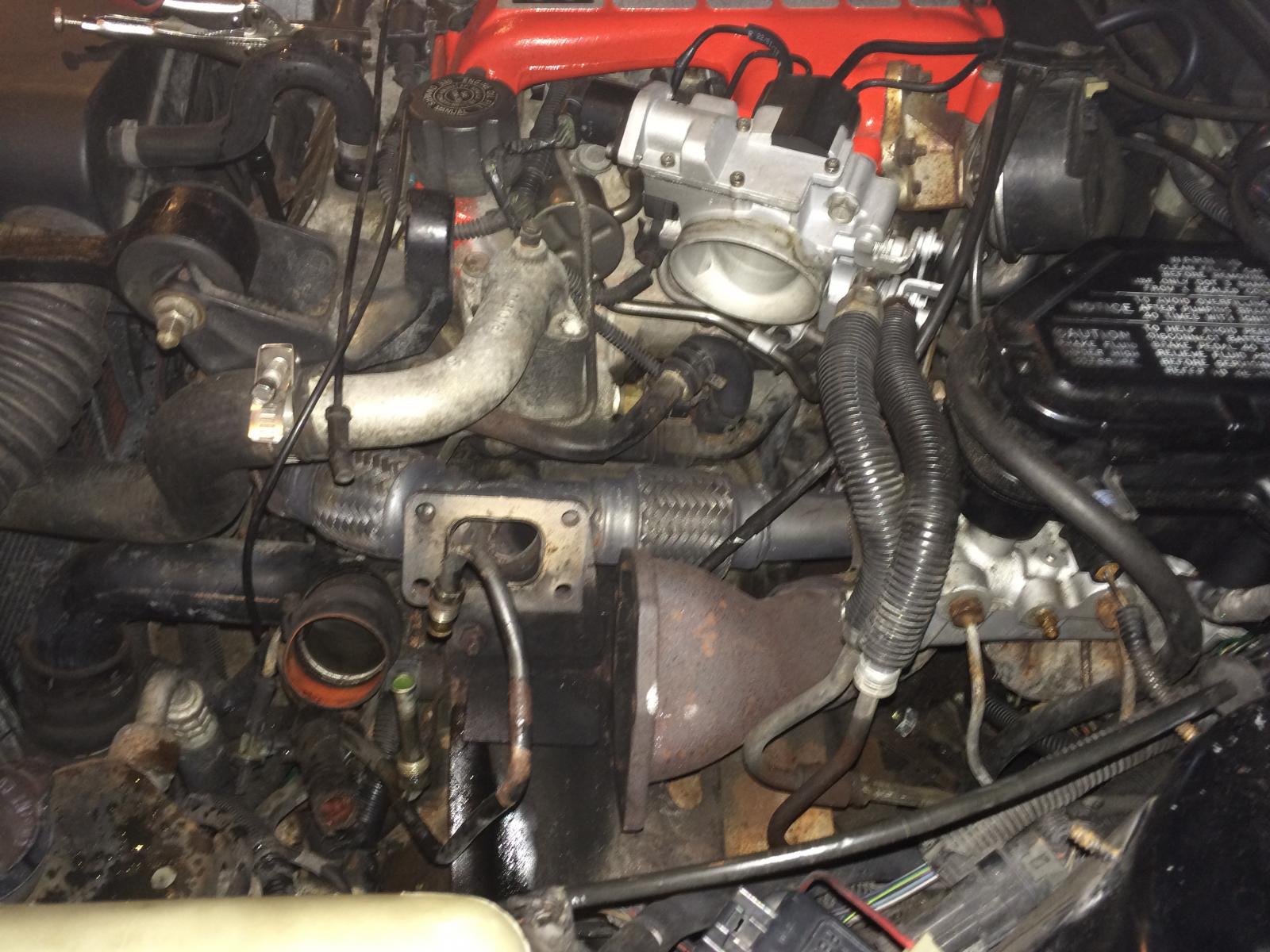

Z34-5speed Posted August 4, 2014 Author Report Posted August 4, 2014 Went back and toyed with it today. Spent the vast majority of time on cleaning the bay. Here are the results! These are a few pics of before/after: Before: After: Quote
Heartbeat1991 Posted August 4, 2014 Report Posted August 4, 2014 Wow. . What did you clean it with? And what's going on with the brakes? What are those marks on the pass side door? They kinda look like they are holes. Quote
Z34-5speed Posted August 4, 2014 Author Report Posted August 4, 2014 I used "Mean Green" degreaser, from Dollar Tree They're not holes, just tape remnants from when they had the window covered with a tarp. Should come off with some effort. The hydroboost (I was told) went out and they decided to put a Geo Metro master cylinder and booster on it. It kinda works, but the brakes are dragging at the moment, and the brake aren't working well enough to drive safely. That's my #1 priority on the car at the moment, so that i can drive it home. Quote

Nas Escobar Posted August 4, 2014 Report Posted August 4, 2014 Z34-5speed said: I used "Mean Green" degreaser, from Dollar Tree They're not holes, just tape remnants from when they had the window covered with a tarp. Should come off with some effort. The hydroboost (I was told) went out and they decided to put a Geo Metro master cylinder and booster on it. It kinda works, but the brakes are dragging at the moment, and the brake aren't working well enough to drive safely. That's my #1 priority on the car at the moment, so that i can drive it home. You should paint that plenum or have that plenum power coated. It would look so much better with a new finish. Quote

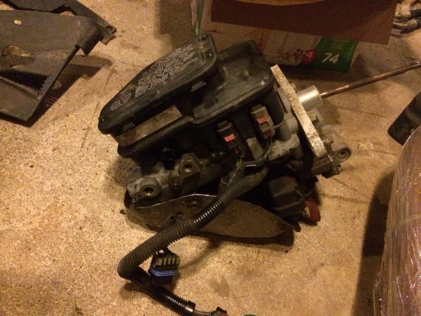

Z34-5speed Posted August 5, 2014 Author Report Posted August 5, 2014 Can someone post a picture of the stock PM3 setup in their car so that i know what to look for in le Junkyard? Thanks! Kyle Quote
Heartbeat1991 Posted August 5, 2014 Report Posted August 5, 2014 Be aware that you may need the mounting plate off the firewall as well. I have serious doubts that you find one in a junk yard. But ya never know. Quote

Z34-5speed Posted August 7, 2014 Author Report Posted August 7, 2014 The price isn't really my worry to be honest, it's just the availability...or lack there of. I see that RockAuto offers an exchange on one for the low price of $1200. Not really wanting to spend THAT kind of money, however it comes with a 3 year 36k warranty, and I do plan on keeping the car. I was just told that the original PM3 was placed in the trunk of the car. Next time i'm down there i'll grab it and bring it home to see if maybe there's something that can be fixed on it. I'm clueless about them though. Kyle Quote
Garrett Powered Posted August 7, 2014 Report Posted August 7, 2014 I have never had to pay that much for one, but I know other guys that have had to. That is a pretty good warranty Quote
Heartbeat1991 Posted August 7, 2014 Report Posted August 7, 2014 Z34-5speed said: The price isn't really my worry to be honest, it's just the availability...or lack there of. I see that RockAuto offers an exchange on one for the low price of $1200. Not really wanting to spend THAT kind of money, however it comes with a 3 year 36k warranty, and I do plan on keeping the car. I was just told that the original PM3 was placed in the trunk of the car. Next time i'm down there i'll grab it and bring it home to see if maybe there's something that can be fixed on it. I'm clueless about them though. Kyle Put it back on, and pull codes from it. Most of the time, you can replace the accumulator and be good to go, after a 30 step bleeding process, that is. LOL Quote
