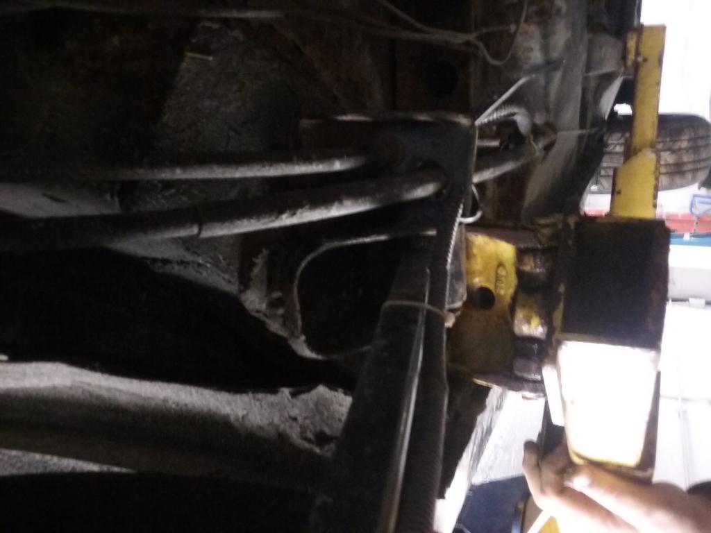

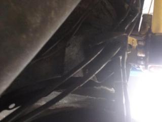

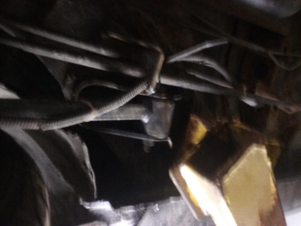

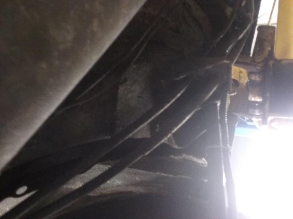

Phone pics but you can see more of the area that was affected by the refit:
