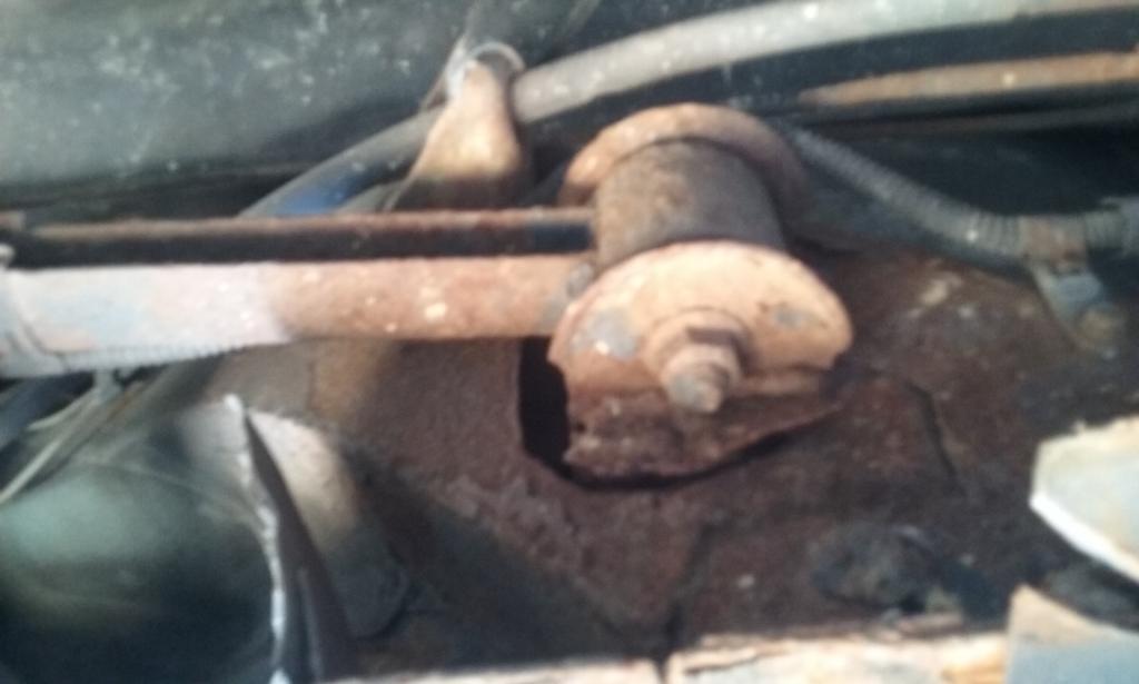

Imp558 Posted July 27, 2016 Report Posted July 27, 2016 You jinxed me, I want under my car to take a picture and it's broken again on the left side. I'm going to order a 2nd gen mount tonight and I already talked to the cat at the Fab shop about welding it in next week. Quote
Q-Ball Posted July 28, 2016 Report Posted July 28, 2016 Jason, I'd love to help but it seems I dont have anytime for anything anymore. Â Jamie may be interested in taking on the job. Text him at 226-971-9384 In all honesty, I was kidding. I know everyone is busy these days. We all are. I still haven't heard back from the shop so looking to reach out for advice. I will see what Jamie is up to lol. You jinxed me, I want under my car to take a picture and it's broken again on the left side. I'm going to order a 2nd gen mount tonight and I already talked to the cat at the Fab shop about welding it in next week. Sorry, but thank me for saving your life. Did you get pics? I'd like to see both and if you ever get the 2nd gen mount on too. Quote
