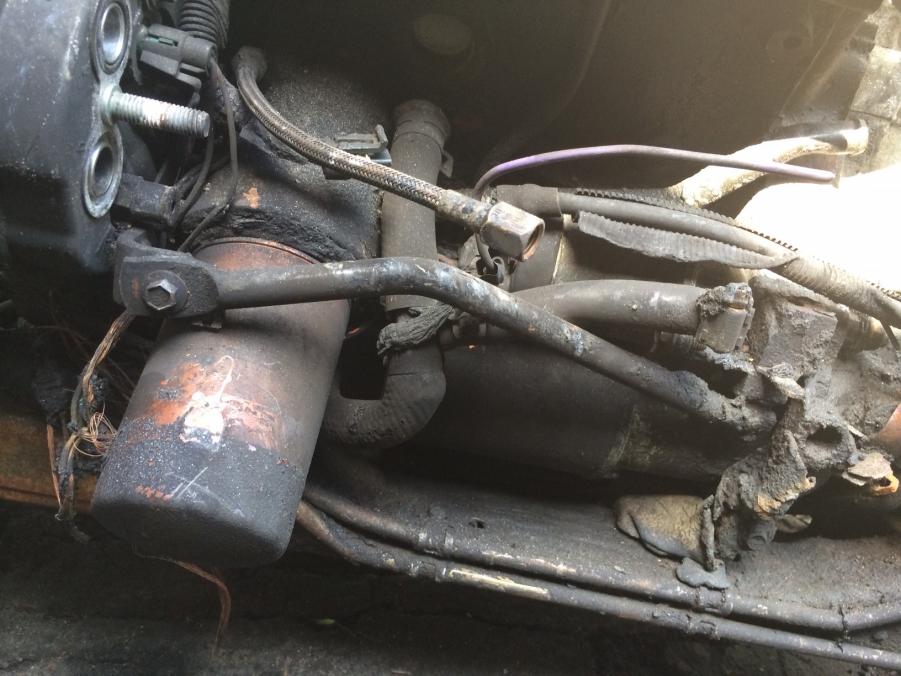

I restored the oil filter cooler adapter...bought new hoses and such.
Now I had a brain fart because I procrastinated.
Anyone have a quick pick of the way the hoses go?
I think the T junctionwheelchair threw me off.
Tks ahead of time for any info.
Might be done some day...could use the room...lol
Brian.
There is a T fitting near the water pump that feeds the side of the oil cooler closest to the AC compressor. The hoses (shown below) come off the oil cooler, and into the block, with a T fitting going to the turbo.
