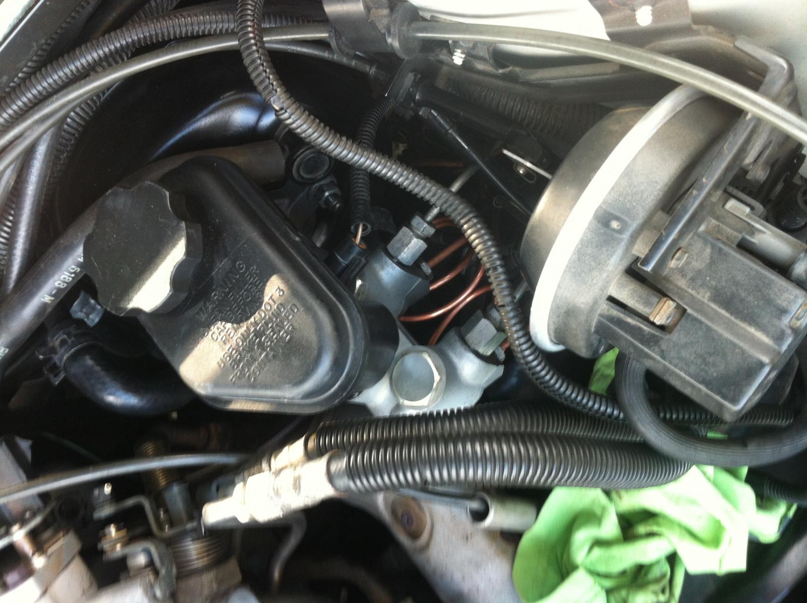

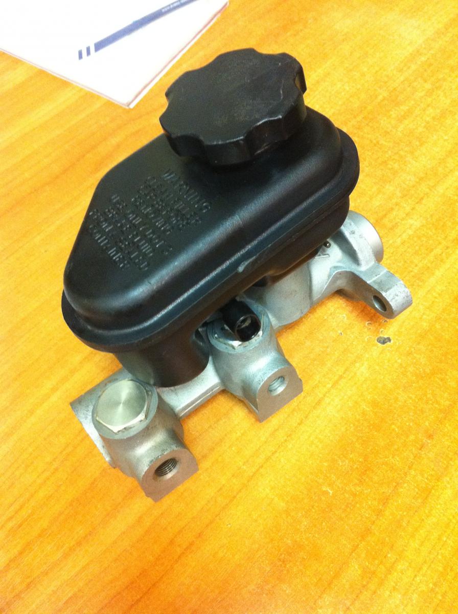

opablo1 Posted August 14, 2014 Author Report Posted August 14, 2014 wow this looks nice. OK. What kind of mastercylinder and accumulator do You have? Where to find thats adapters, or You made it your self? and what to do with ABS computer? Quote
shurup Posted August 14, 2014 Report Posted August 14, 2014 wow this looks nice.OK. What kind of mastercylinder and accumulator do You have? Where to find thats adapters, or You made it your self? and what to do with ABS computer? The system that I set no ABS. Master cylinder from lumina. I cut the adapter plate from the factory plate Lumina. Quote

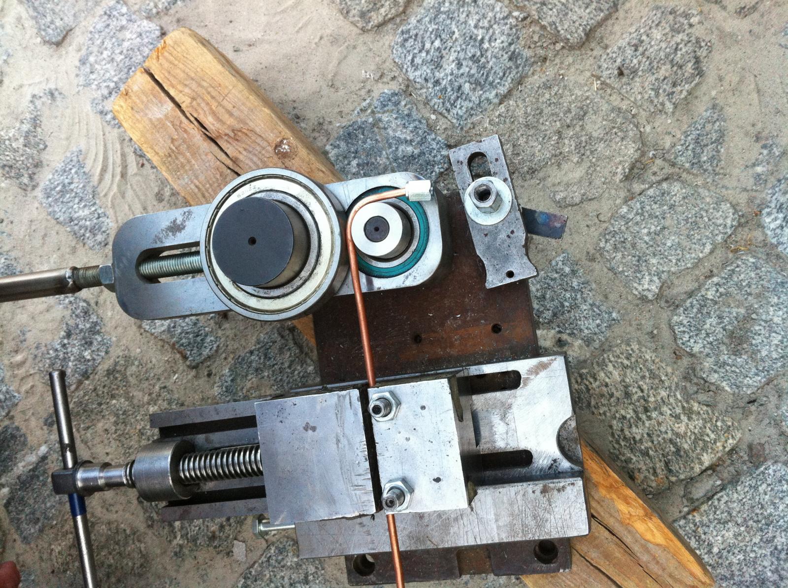

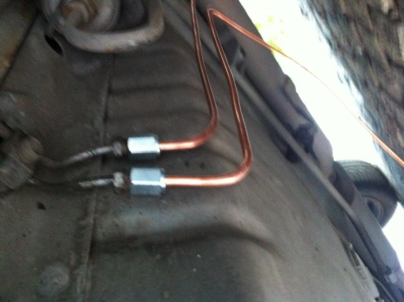

shurup Posted August 14, 2014 Report Posted August 14, 2014 Began to bend tubes for the rear brakes Quote
55trucker Posted August 14, 2014 Report Posted August 14, 2014 ^ please tell me that's not copper tubing I see in those pics........ Quote
shurup Posted August 14, 2014 Report Posted August 14, 2014 ^ please tell me that's not copper tubing I see in those pics........ Â yes, it's copper tubes Quote
GnatGoSplat Posted August 14, 2014 Report Posted August 14, 2014 Copper brake lines isn't safe, but copper-nickel alloy is okay. Quote
shurup Posted August 14, 2014 Report Posted August 14, 2014 These tubes are sold in special shops for brake systems Quote
55trucker Posted August 14, 2014 Report Posted August 14, 2014 We have a product here in Canada which is marketed by FMSI which is a copper/nickel/iron brake line, great for resisting corrosion, Â as long as what you have there is a similar tubing (it sure looks like all copper) you should be safe. Quote
