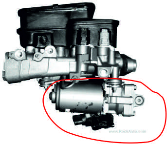

opablo1 Posted August 2, 2014 Author Report Posted August 2, 2014 You right that price suggested this part is unavialable. Anyway I read a lot of times that people usualy change modulator could it be a solution? Can this modulator leaks and the brake pedal is hard and no brakes at all? in this place i see a lot of brake fluid but I cant find a source of this drain. Could it be this modulator? Quote

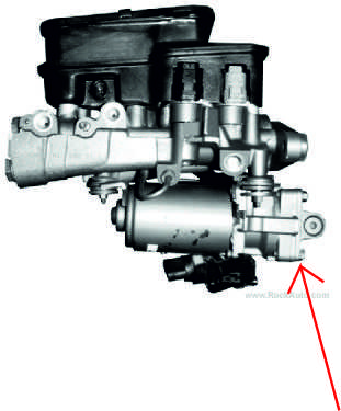

mfewtrail Posted August 2, 2014 Report Posted August 2, 2014 You right that price suggested this part is unavialable. Anyway I read a lot of times that people usualy change modulator could it be a solution? Can this modulator leaks and the brake pedal is hard and no brakes at all?[ATTACH=CONFIG]16653[/ATTACH] in this place i see a lot of brake fluid but I cant find a source of this drain. Could it be this modulator? Your photo is pointing to the rear housing of the unit. This is a known area to crack on these master cylinders. Quote
opablo1 Posted August 2, 2014 Author Report Posted August 2, 2014 (edited) ok so it isn't modulator but master cylinder? Can we say that only this part is broken? Edited August 2, 2014 by opablo1 Quote
