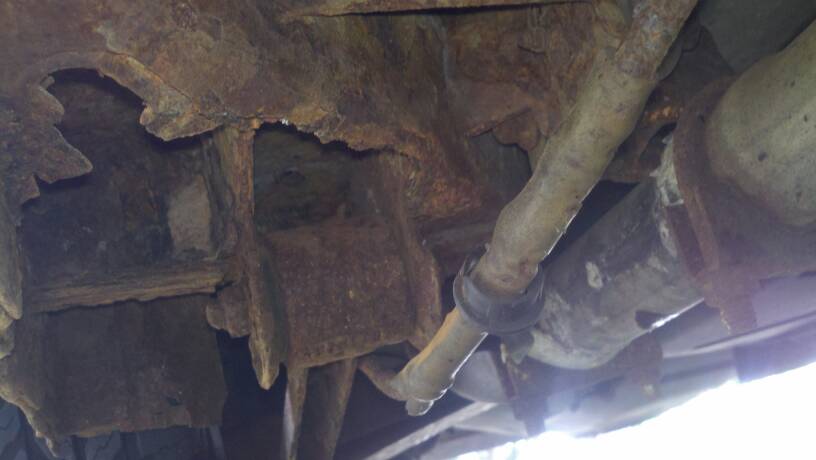

1990lumi Posted July 27, 2014 Author Report Posted July 27, 2014 worse then i thought :/ still save able? Quote
Imp558 Posted July 28, 2014 Report Posted July 28, 2014 Find a small welding shop and get a quote. Quotes are free, if everything works out I'll be having one done here soon, found a 1998 SSEI with every option including a sunroof and leather interior, black on black with X-laces! It needs a trailing arm pocket repaired so we're getting it for next to nothing. Quote

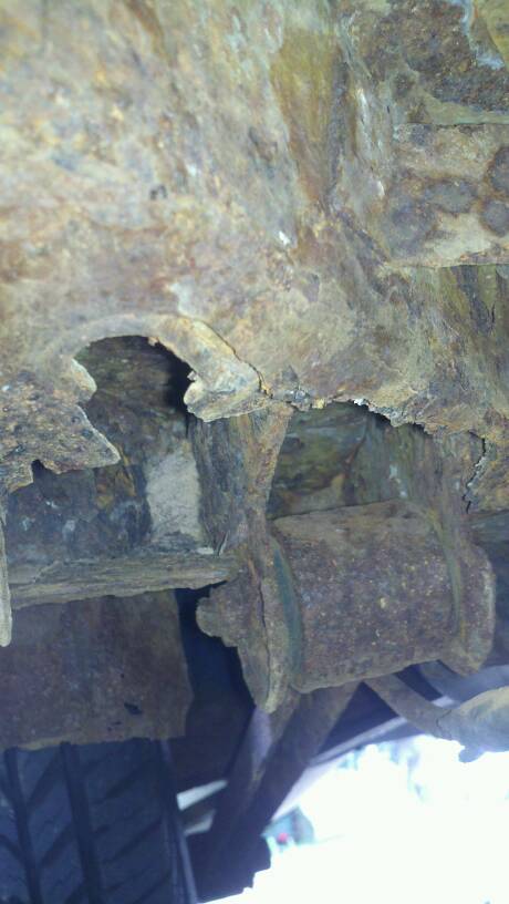

1990lumi Posted July 28, 2014 Author Report Posted July 28, 2014 it wasnt that bad but i could pull chunks or rust off Sent from my DROIDX using Tapatalk 2 Quote
