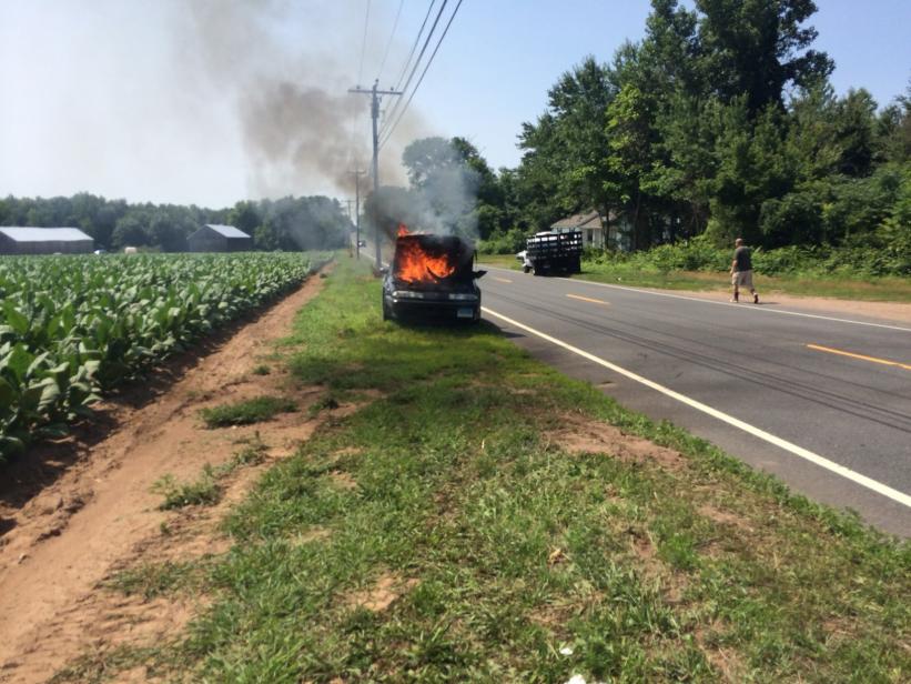

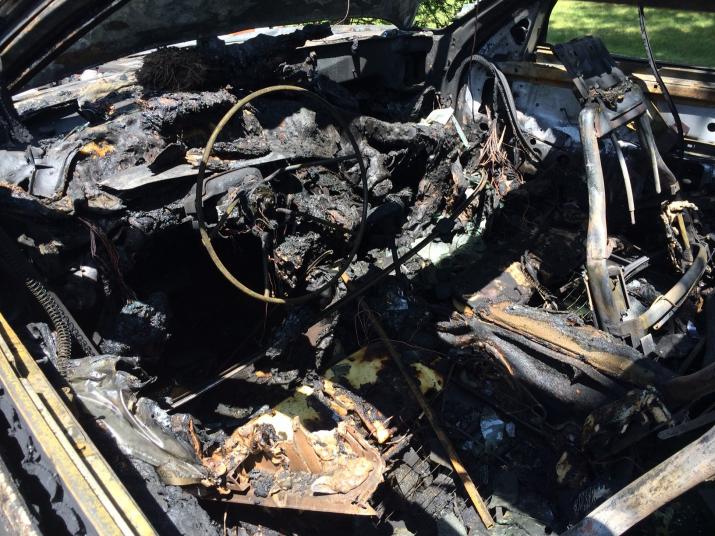

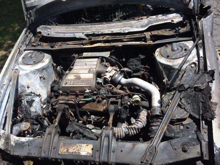

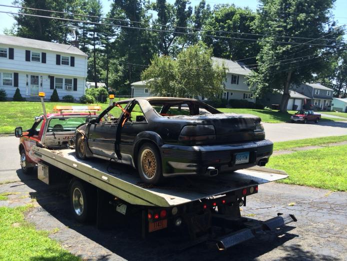

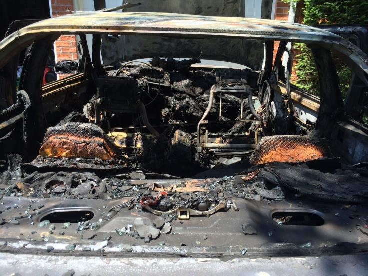

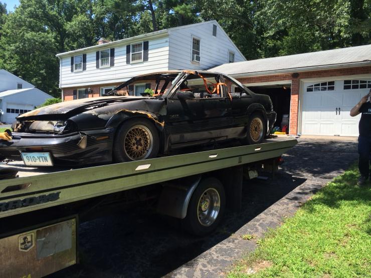

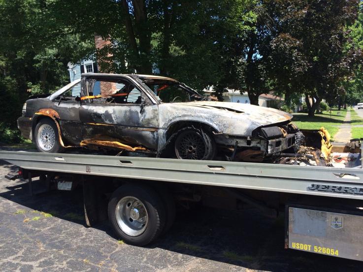

Heartbeat1991 Posted July 22, 2014 Report Posted July 22, 2014 (edited) So this morning my TGP caught fire. The Hydac accumulator doesn't thread far enough into the PMIII housing to hold it well enough under pressure. I installed the accumulator about 4-5 months ago or so. I heard a loud thump this morning as it finally blew off the housing. It hit the crossover, leaving a decent dent in it, and landed on the trans shift linkage. The resulting brake fluid leak caught fire on the down pipe. I could not get the fire out, and by the time the fire department got there, it was too late to save it. I removed the freshly rebuilt turbo this afternoon. It seems to be unaffected by the fire. The engine and trans also seem to be largely ok. I will hook my spare harness to it this week and make sure it runs before I pull it out, along with the rear suspension. That's about all that can be saved. Sad Day. . Edited July 22, 2014 by Heartbeat1991 Quote

Heartbeat1991 Posted July 22, 2014 Author Report Posted July 22, 2014 I am ok. The car was barely smoking when I pulled over. There was only a small flame, but with no way to put it out, it grew and grew. Quote

GP1138 Posted July 22, 2014 Report Posted July 22, 2014 Oh man, those pictures made my heart sink. I'm glad you're OK though! Quote
