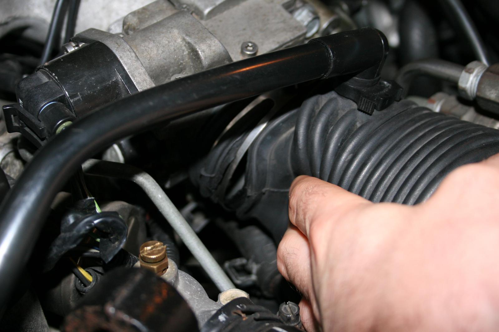

HEMI-V8 Posted July 25, 2014 Author Report Posted July 25, 2014 Okay, good to know. Today I´ve seen that my air intake hose ist on the throttle body side broken. Could that be a possible error source ? Quote
RobertISaar Posted July 25, 2014 Report Posted July 25, 2014 unless you're running an 88 car with the MAF still enabled(i don't know how well recalls get done overseas for something like this), the only thing that will do is allow unfiltered air into the engine, which isn't a good thing, but it wouldn't effect drivability. Quote

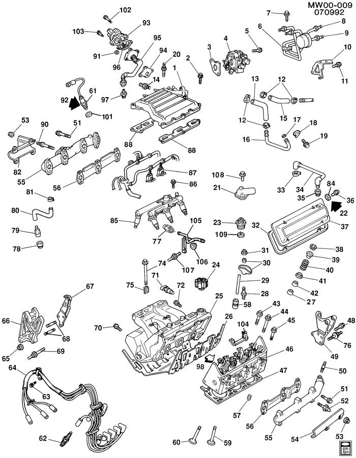

HEMI-V8 Posted July 28, 2014 Author Report Posted July 28, 2014 (edited) Good to know. Thank you. I will report when I got some news after installing the new manifold gasket. Additional question: Should I change only the plenum gasket (no.88) or also the gasket of the lower manifold ? (No. 26) Edited July 28, 2014 by HEMI-V8 Quote
RobertISaar Posted July 29, 2014 Report Posted July 29, 2014 i didn't see the edit. generally, the 2.8/3.1 lower intake gaskets don't require replacement, they'll last the life of the engine. the later 3100/3400 engines did have issues with the lower intake gaskets. i would say that unless you see some kind of indication that it is at fault to leave it. Quote
