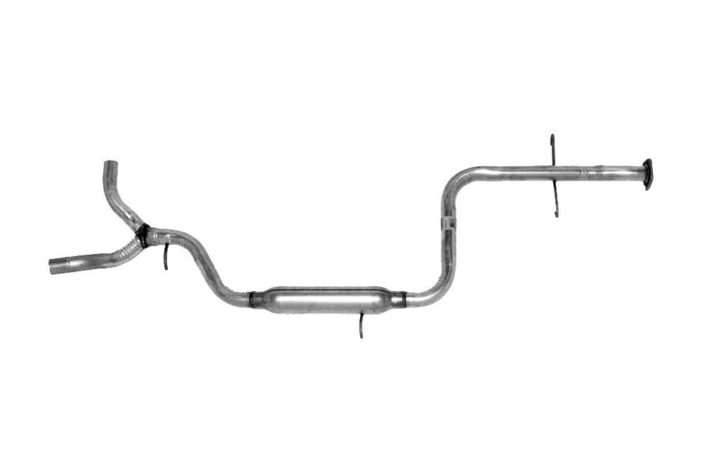

redmetrix Posted July 19, 2014 Report Posted July 19, 2014 I am thinking about changing the stock dual exhaust system on my 90 Grand Prix to the newer style that was used 92-96. What is my ultimate goal? It's to have a quiet dual muffler setup. I plan to change everything that's after the catalytic converter. Right now the car has this setup (diagram from Walker muffler) I had a 93 GTP which of course had the newer setup with the resonator that goes to a y-pipe then to the mufflers. I was happy with the sound level of that setup. I'm hoping if I put this style setup on my 90, I will get the same/similar result. I plan to use new Walker parts: as far as I know, I will need the resonator/y-pipe which is all one piece, and then the left and right mufflers. I would also need to get mounting hardware from a 92-96 GP. The resonator/y-pipe can be bought as one piece, it looks like this: If anyone has some advice for me on this switchover, as far as what to keep in mind or things I will need, let me know. Will I run in to any issues trying to put the newer style exhaust on? Quote
