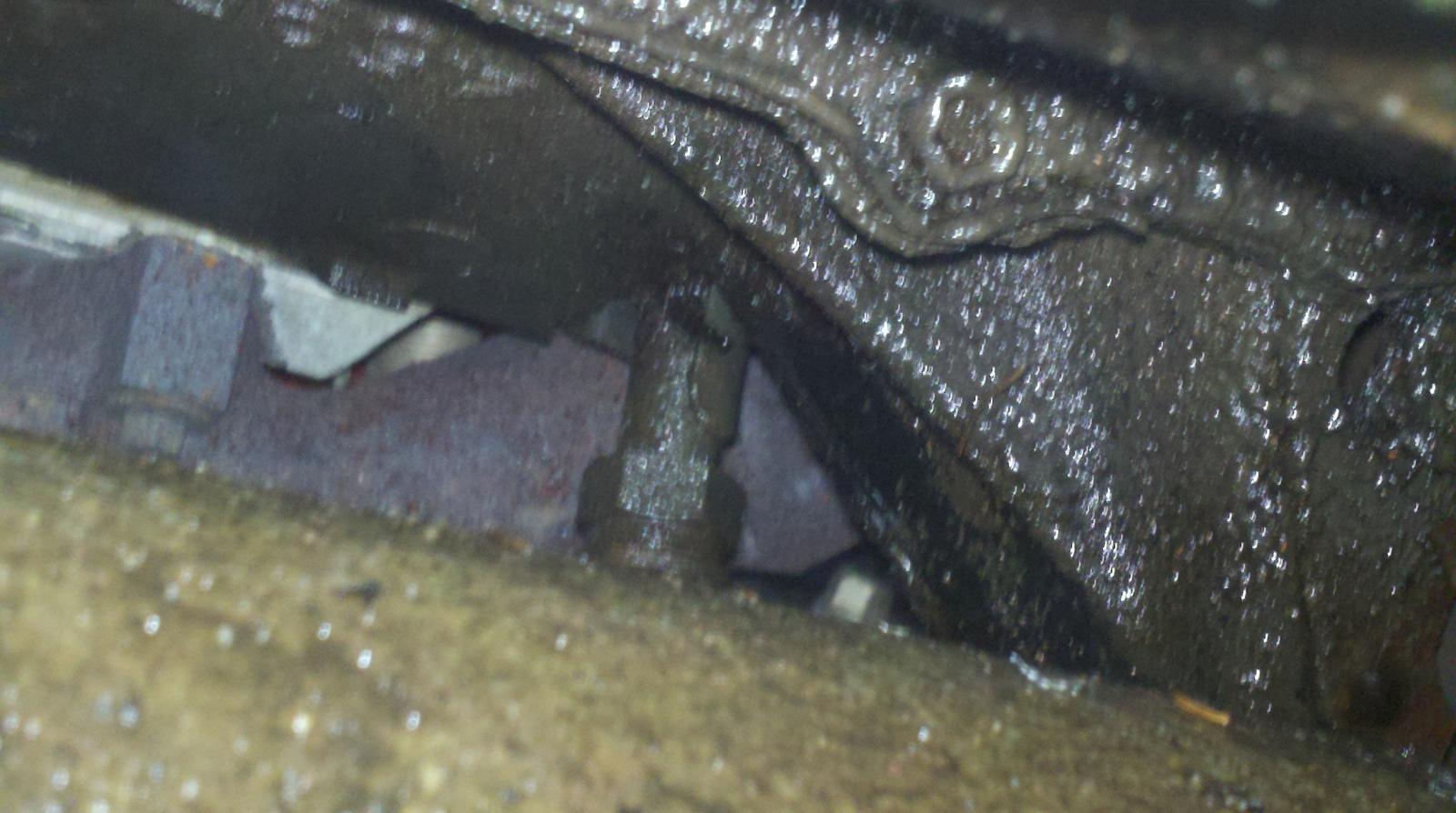

i was under my car (1990 chevy lumina 3.1l) today looking for a oil leak thinking it was my oil pan gasket but well my car is running i notice no oil (from what i can see) leaking from the gasket but i do notice a clean spot from this line coming out of my motor above the oil pan and between the trans under the exhaust manifold and im guessing its clean do to a leak post-10600-143689163821_thumb.jpg
That looks like just straight up seepage from the oil pan gasket. Take a 10mm socket and very, very carefully tighten the bolts you can access on it (you won't get 'em all!). Give it as much of a cleaning as you can, and you shouldn't leak as much.
i thought it was seepage also but my motor is wet all the way up to that oil line in the picture that is why i was wondering what it was and where it went to
