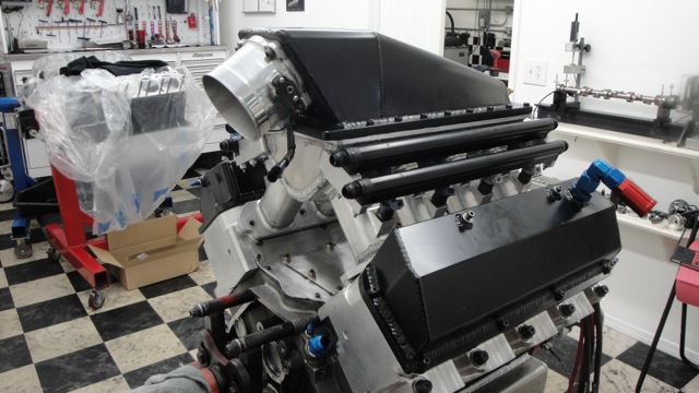

One of these (which is very similar to the ausie IM) will do much better because the intake charge stays much cooler. This will be my next project after I get the car going.
