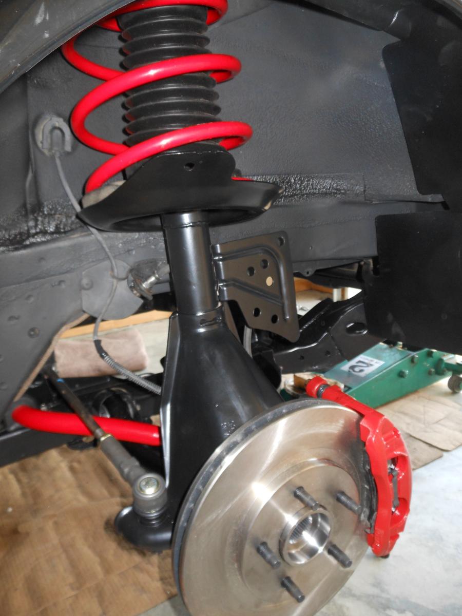

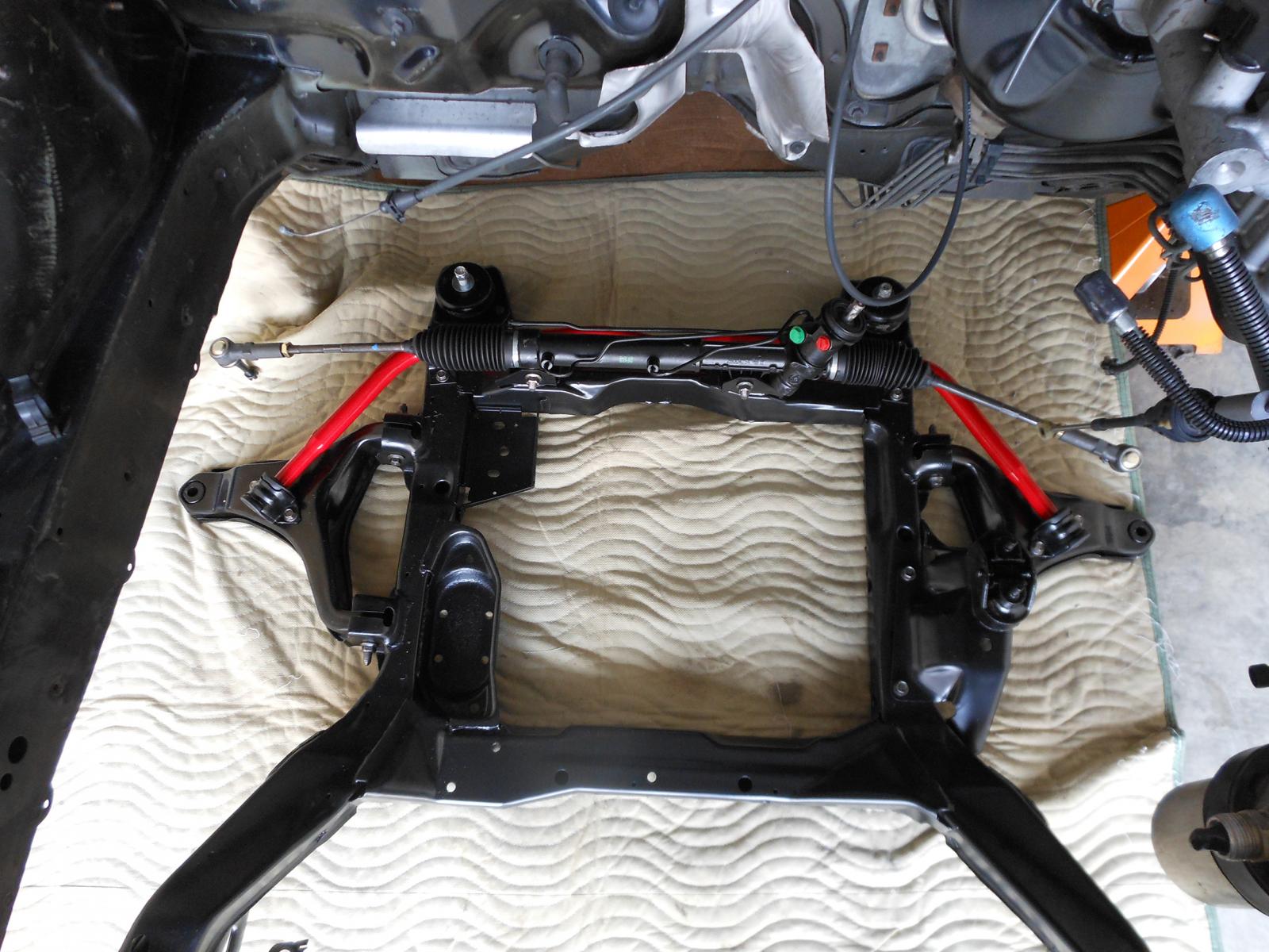

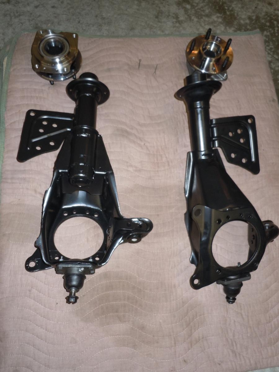

I just went through the front end on my 95 vert. I swapped a 96 in place for the bigger brakes. I found the strut tool at a O'Reilly store near me. They do have it on-line also. I chose to powder coat my parts and replace the struts.
Thx.. I had the whole thing powder coated. The springs and sway bar are stock but had them done with RED powder coating to look special. New Rack also. most everthing was shot when I started getting into it. Struts were gone etc.... So I had to go all the way!
