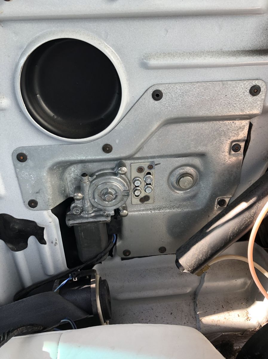

xennith Posted April 6, 2020 Report Posted April 6, 2020 Hey everyone, I hope it’s ok to jump start this topic. I have a 95 with a stuck window. I spent a few hours today banging on the rear window motor and it finally went down but it will only come back up about an inch. I finally took the trim off so I’m thinking I should just replace it now that I’m this far in and it’s still stuck. Can anyone recommend a good replacement that you’ve found online? Also, if I’m understanding instructions correctly, the 10 outer rivets come out first. Then the three rivets that holds the motor to the plate? Any trick to pulling it off once the rivets are out? Thanks for any help! jiggity76 1 Quote

xennith Posted April 8, 2020 Report Posted April 8, 2020 So I ordered a motor from rockauto.com and I removed the motor and regulator today, that was a real bitch. I drilled out the rivets as best I could and then had to use a chisel to finish them off. I’m a little worried about getting it all back together. I’m thinking it might be easier if I lower the top before trying to put the regulator back in because of the position of the top piston. I’ll know more after Friday when the motor gets here. Quote
xennith Posted April 14, 2020 Report Posted April 14, 2020 So the rockauto.com motor worked perfectly but it was nearly impossible to get the regulator in and out with the motor attached. When I took it out I removed the motor from the regulator first, but since the new one gets screwed on to the regulator first it all has to go in as 1 piece. I actually cut a bigger hole in the plastic shield to get it in and reattached to the window . Quote

mybluecutty Posted September 14, 2020 Report Posted September 14, 2020 This irritating problem has come up again on my convertible. I’ve tapped it with a hammer for 2 hrs without any up movement... Has anyone every ground the rivets off and replaced the motor without taking the regulator off? Quote
