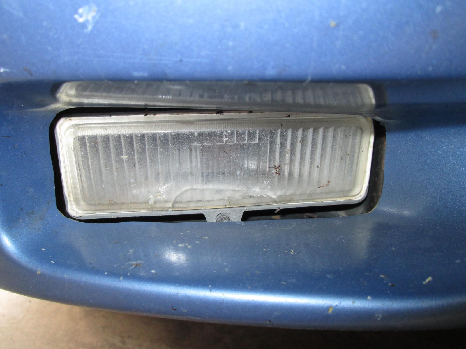

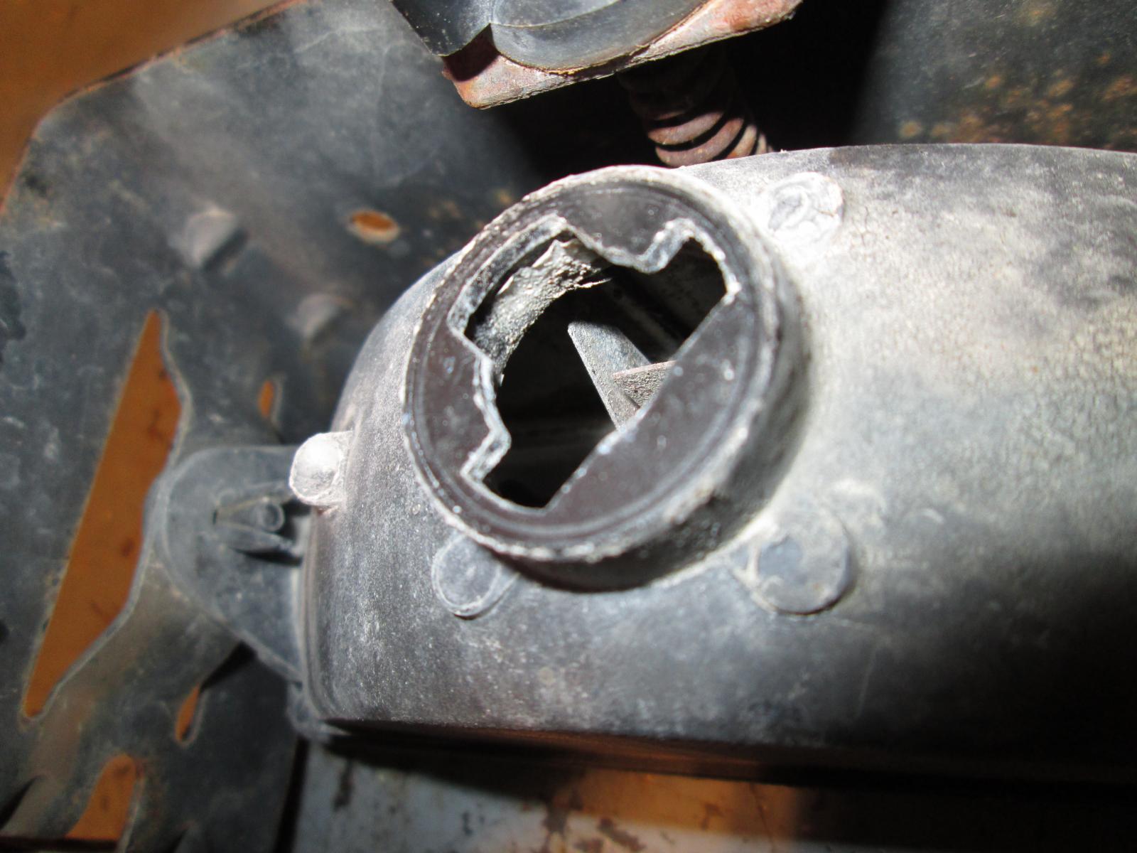

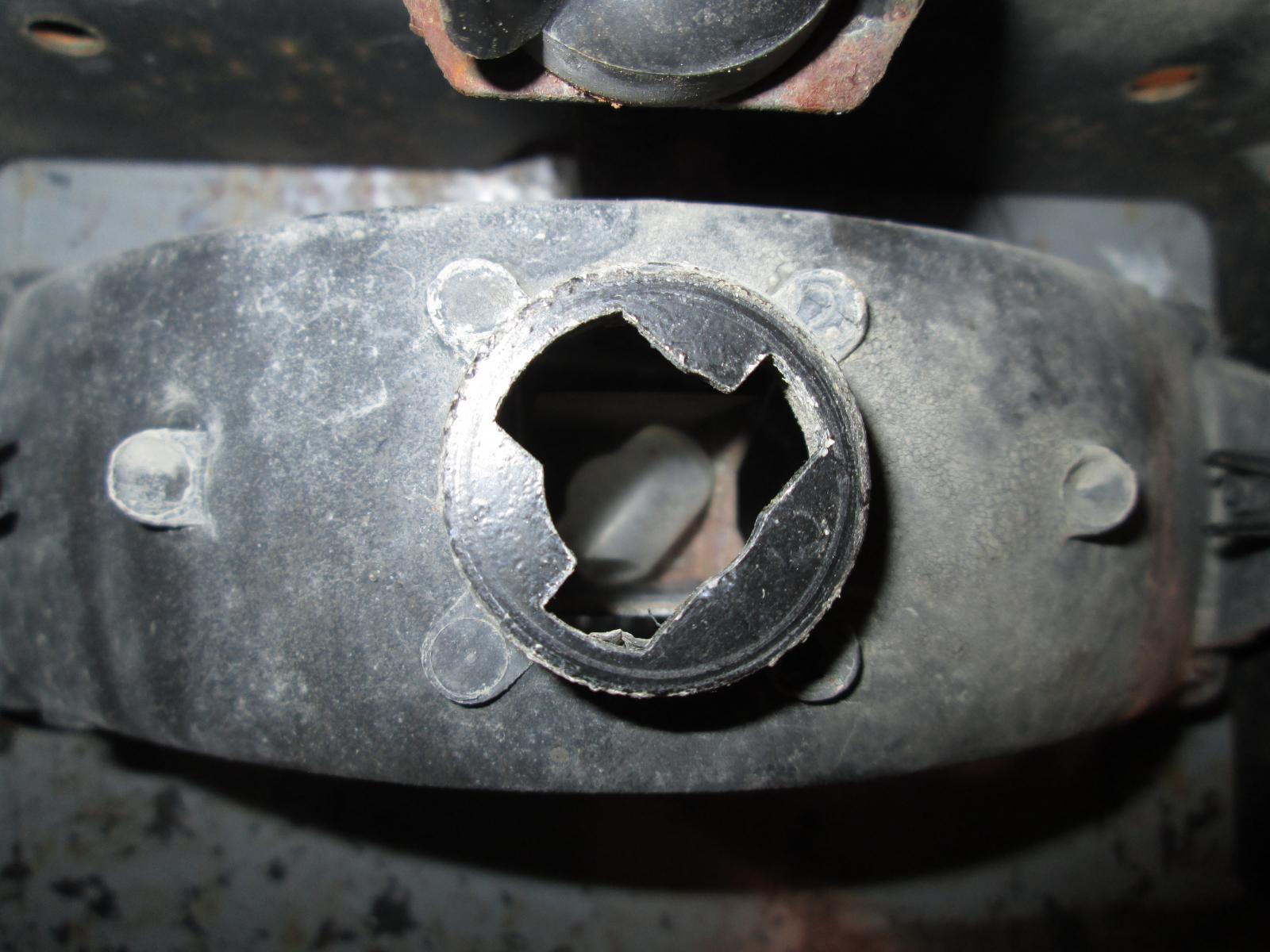

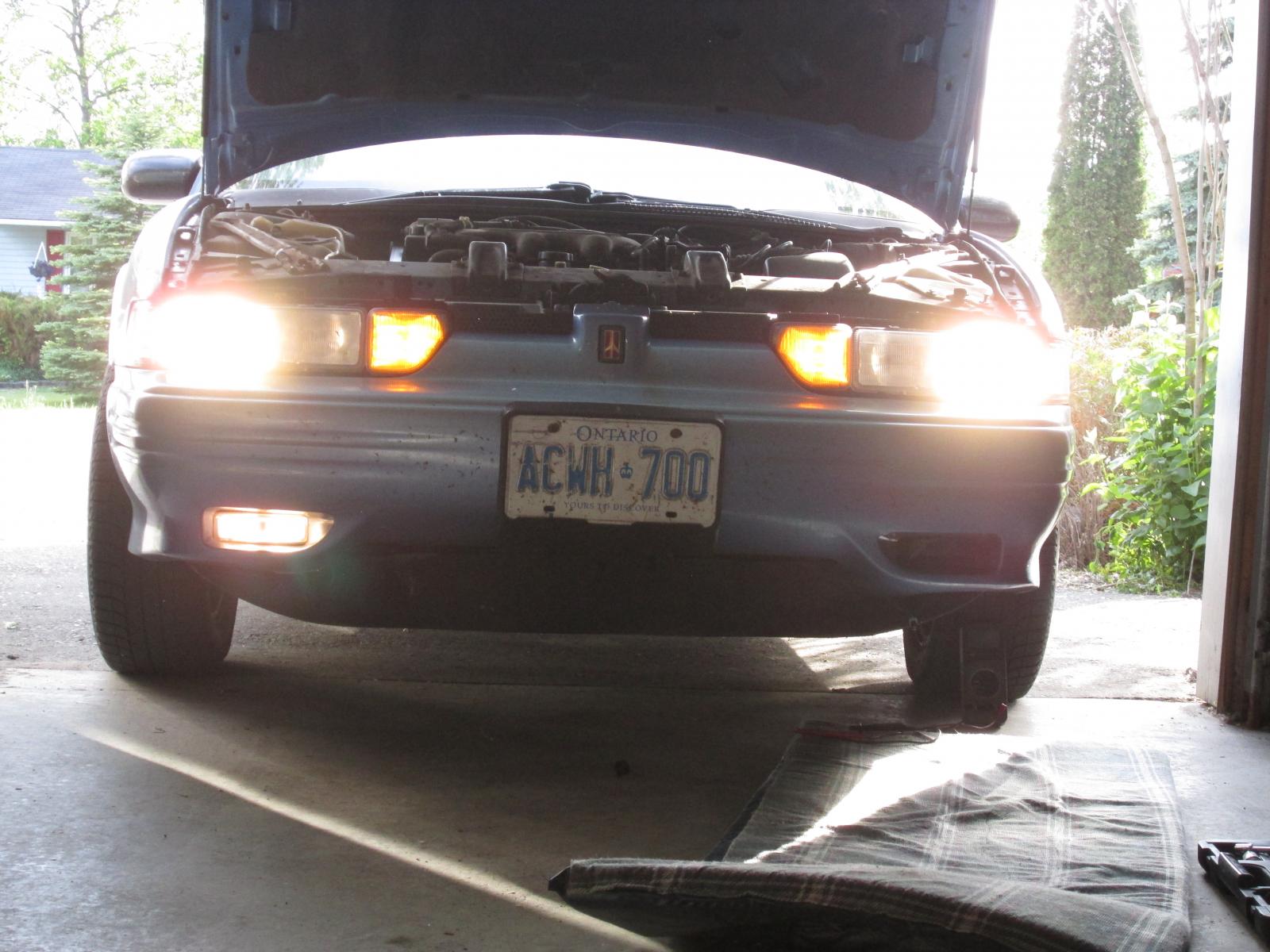

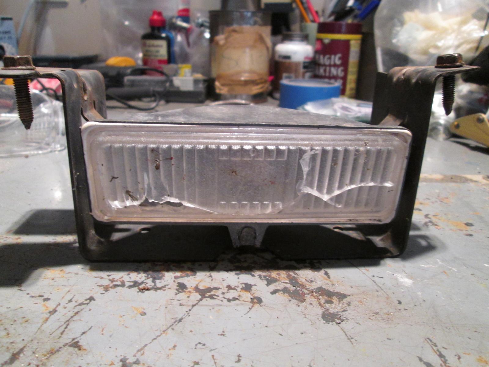

derkach99 Posted June 1, 2014 Author Report Posted June 1, 2014 (edited) Today I went under the car and I managed to take off the driver side fog light. It was a bit of a pain in the but to get it off but I managed to do it. I also took a volt meter and there is 11.7V going though the wire when the fog lights are on and and car not running. I don't understand why I blew the fuse when I added the light bulb on that side. Maybe bad luck or a weak cheap fuse? Below are some images of the fixture I took out as well parts of the old bulb in the fixture. Below is pictures of the working fog light in action but it is not very bright. I am replacing this fixture as well. Note the cracks in the glass. There should be glass shards in this fixture as well. Edited June 2, 2014 by derkach99 Quote
