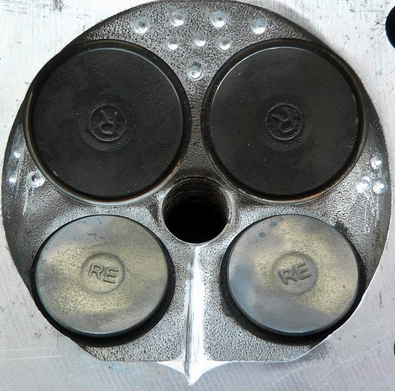

I've cut the Somender-Singh grooves into two pair of cylinder heads. No before-after testing, though so I can't say if they helped. Lots of internet opinion on whether or not they help; I don't know of anyone who claims they've hurt performance.

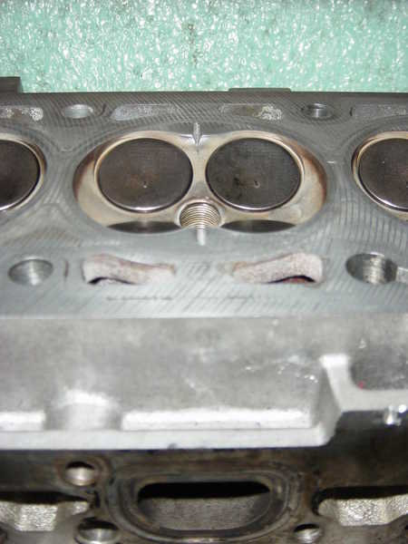

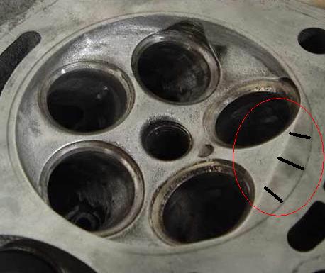

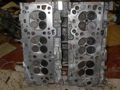

Most modern 4-poppers have multi-valve heads, there's essentially no quench pad to cut a groove into.
Most DOHC engine have quench areas, they're just really small. The vid is with a Holden 2.0L, which is in my Suzuki Forenza. Minis, Miatas, and Civics too are examples. Even 5 poppers. And, of course, the 3.4L.
