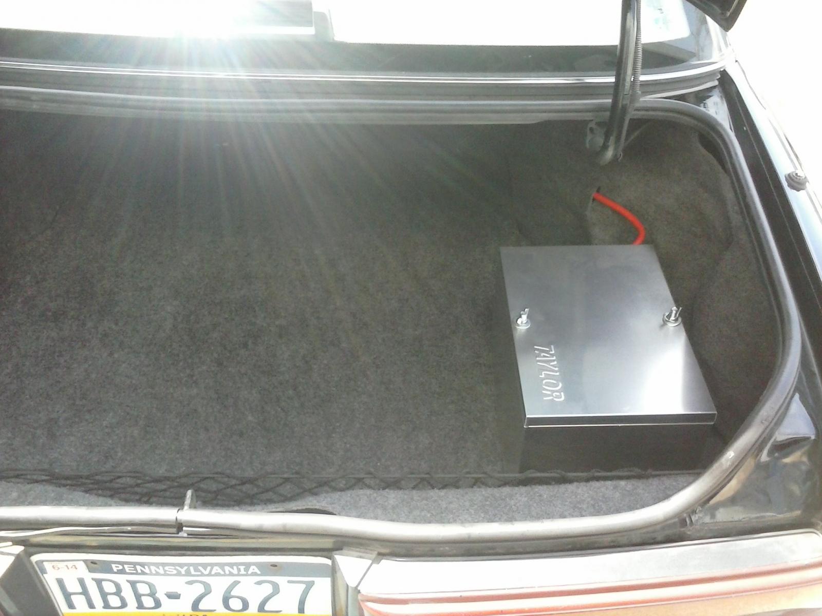

I've been driving with the trunk mount for a while now, some of you guys saw it in Toledo. On the way back through Cleveland I got the rest of my trunk carpeting from Pull-A-Part West. Cleaned everything up at the car wash and finally got the trunk done so I have pics of the trunk to post that I'm not ashamed of:
I've since slid a piece of split loom on the wire which makes it as natural as a big aluminium box in the trunk of a car can look.
