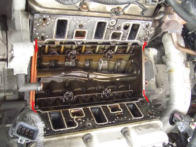

carkhz316 Posted April 27, 2014 Report Share Posted April 27, 2014 (edited) You only need any RTV on the corners of the valley where the heads meet the block, for about a .5-1 inch overlap. Also small overlap on top of the gasket where it meets the block. This is how I've done it and I've never had leaks. Edit: found and edited a pic in Paint. I used red for contrast. A small bead like indicated before you put the gaskets on, and then overlap a bit on top of the gasket. Feel free to concur or disagree. Edited April 27, 2014 by carkhz316 Quote Link to comment Share on other sites More sharing options...
Night Fury Posted April 27, 2014 Report Share Posted April 27, 2014 ^^^^I'm with this guy, that's what the GM service manual calls for, that's what I do/did. Never had a problem. Quote Link to comment Share on other sites More sharing options...
Andrew Posted April 27, 2014 Report Share Posted April 27, 2014 x3. Thats what ive done too. Quote Link to comment Share on other sites More sharing options...
