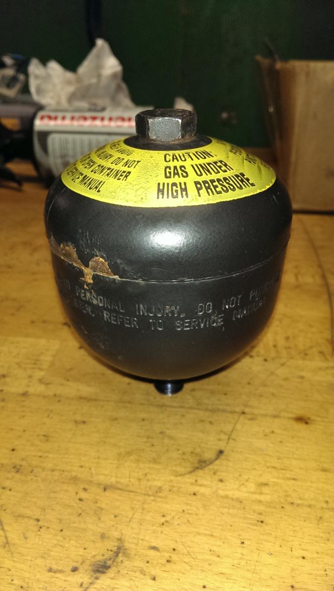

mfewtrail Posted November 8, 2014 Report Posted November 8, 2014 Is it an problem (ecept the space) when the new accumulator is bigger than the original ? Original 0.25 l New 0,32 l [ATTACH=CONFIG]17892[/ATTACH] So long as it physically will fit on the car, the container being larger will not be an issue. I run a Hydac accumulator that's larger than the orginal AC Delco on one of my cars. It's been on there 10 years(or longer) now. Quote
