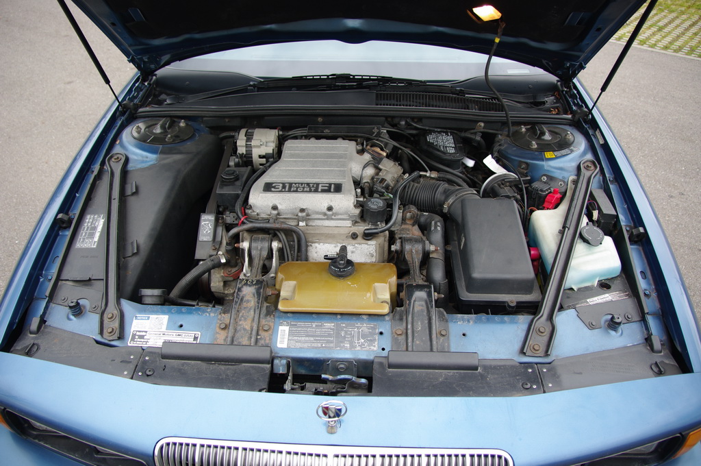

HEMI-V8 Posted April 23, 2014 Author Report Posted April 23, 2014 Sorry I don´t know. Maybe you can see it on this pic: If you want can I make a better detail photo. Quote
RobertISaar Posted April 23, 2014 Report Posted April 23, 2014 that is the powermaster III all right..... i hope for your sake that you don't need to actually replace anything, sourcing good replacement parts is already difficult enough in the US. Quote

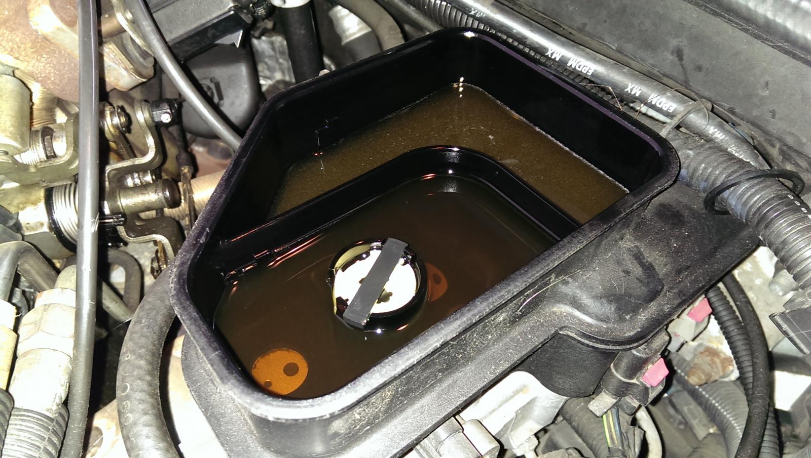

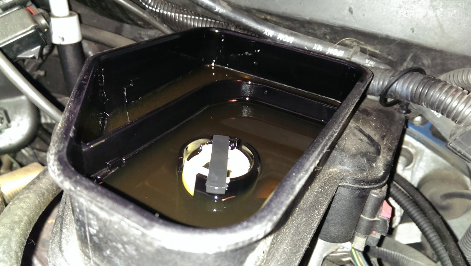

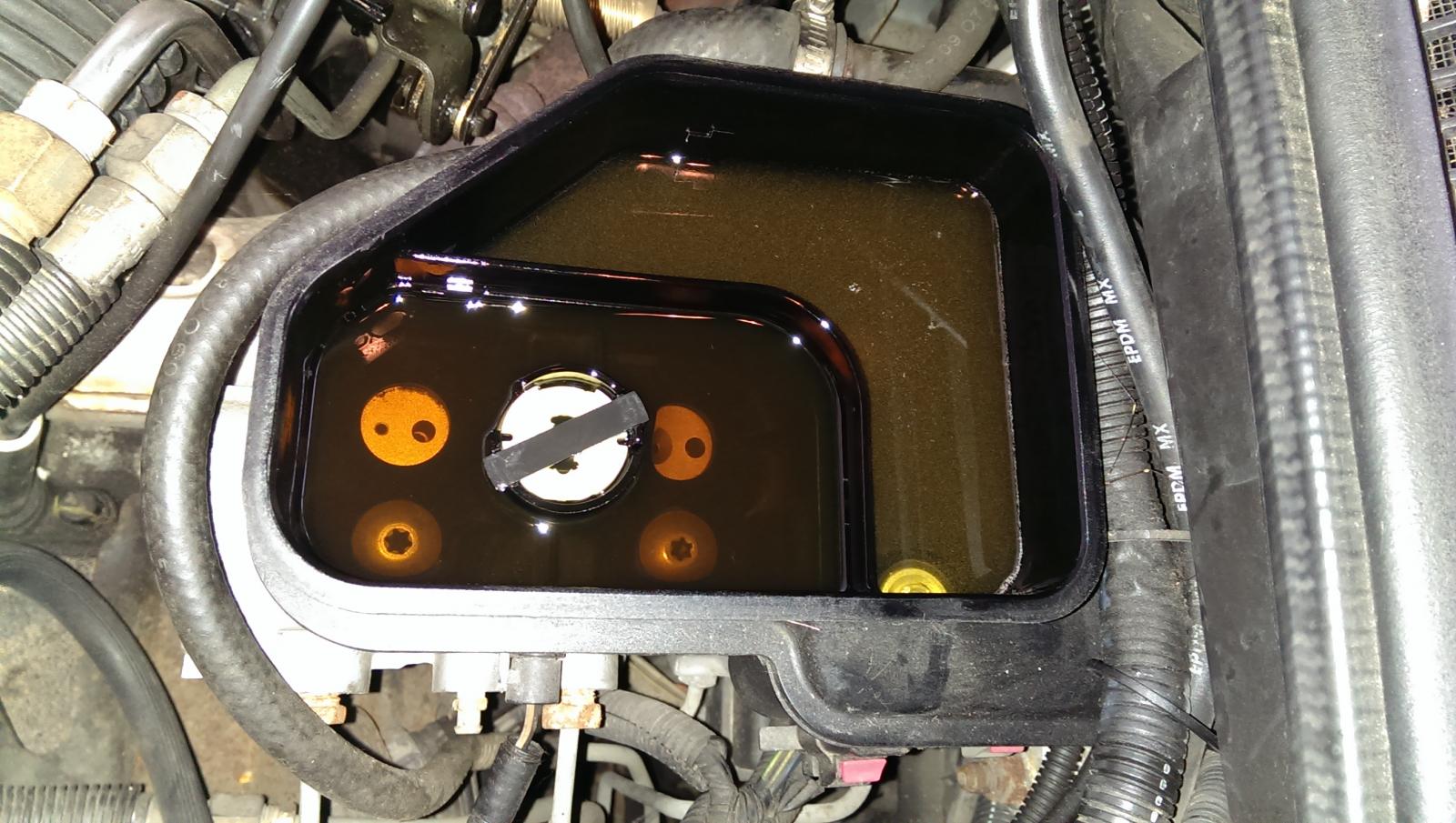

mfewtrail Posted April 25, 2014 Report Posted April 25, 2014 Are there any brake lights illuminated on the instrument panel? Have you checked the fluid level? Depress the brake pedal around 40x before pulling the cap off the master cylinder to check the level. Quote
HEMI-V8 Posted April 26, 2014 Author Report Posted April 26, 2014 (edited) And likely what you're hearing is just the accumulator pump running. Does it run all the time? It should only run once every 3-5 brake pumps It runs in every touch that I give on the brake paddle. Are there any brake lights illuminated on the instrument panel? Yes, the amber "Anti-Lock" is flashing the whole time. Because that any pre-owner had removed the bulbs in the dash and I hadnt noticed that. Have you checked the fluid level? Depress the brake pedal around 40x before pulling the cap off the master cylinder to check the level. Ignition ON or OFF ? -------------------- Heres a youtube vid where you can here the pump when Im press the paddle: [video=youtube;NlsnbeA-Kyk]https://www.youtube.com/watch?v=NlsnbeA-Kyk&feature=youtu.be -------------------- A good friend with an SnapOn scan tool said he can readout the system to see mayby the mistake. Beforehand he meant the accumulator is bad. Is this really possible ? THX Edited April 26, 2014 by HEMI-V8 Quote

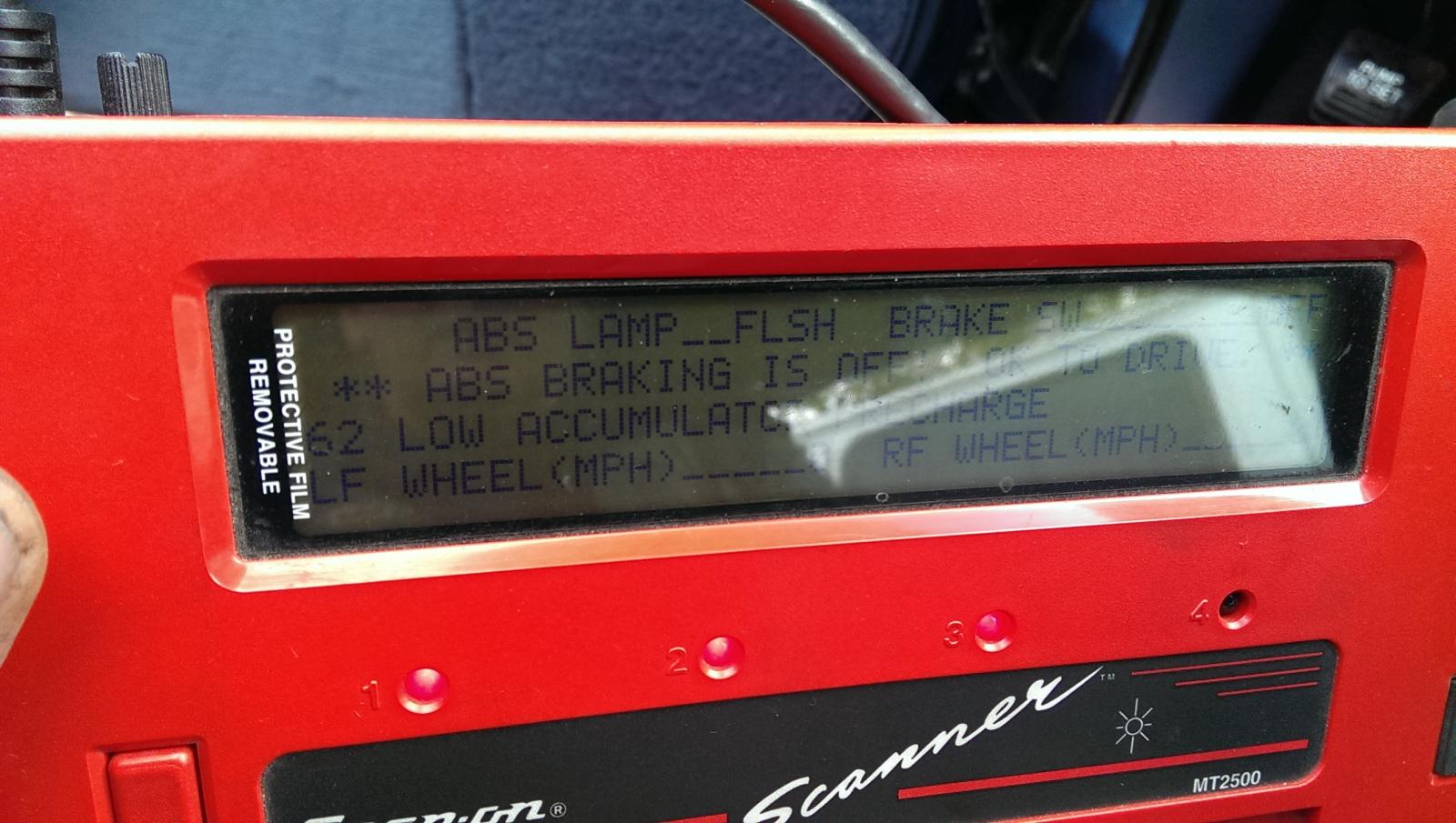

mfewtrail Posted April 26, 2014 Report Posted April 26, 2014 (edited) Leave the ignition off when pressing the pedal that many times before checking the brake fluid level. The flashing amber light indicates that there is a fault, but abs is still operational. Often times it's a low accumulator charge that will cause the light to flash. That snap-on scan tool should be able to pull the fault codes and lead you in the right direction. If you or your buddy need access to diagnostic information, let me know. I have access to factory repair manuals, alldata, etc. I've been meaning to scan the entire Powermaster III/Delco Moraine ABS III section out of the factory manual for sometime now, but haven't gotten around to it. I may start on that very soon and will link it to be shared w/ everyone here. Edited April 26, 2014 by mfewtrail Quote
HEMI-V8 Posted April 27, 2014 Author Report Posted April 27, 2014 (edited) Leave the ignition off when pressing the pedal that many times before checking the brake fluid level. So it looks like after the procedure: The flashing amber light indicates that there is a fault, but abs is still operational. Often times it's a low accumulator charge that will cause the light to flash. That snap-on scan tool should be able to pull the fault codes and lead you in the right direction. If you or your buddy need access to diagnostic information, let me know. I have access to factory repair manuals, alldata, etc. I've been meaning to scan the entire Powermaster III/Delco Moraine ABS III section out of the factory manual for sometime now, but haven't gotten around to it. I may start on that very soon and will link it to be shared w/ everyone here. Alright, I will report when I was by my buddy. That you got an access to all this stuff is great. thank you. UPDATE: 62 - LOW ACCUMULATOR PRECHARGE Means that I need a new accumulator oe another stuff ? Edited April 27, 2014 by HEMI-V8 Quote
mfewtrail Posted April 27, 2014 Report Posted April 27, 2014 Yes, low charge means the accumulator is weak and needs to be replaced. There's a part number thread around here that lists compatible part numbers from American suppliers. They're generally around $125-150 US. Depending on shipping, import tax, etc. you might want to price out an accumulator like this that "Shurup" from Ukraine recently posted about: http://www.w-body.com/showthread.php/79283-Delco-Moraine-ABS-III-Manual-GM-book Quote
