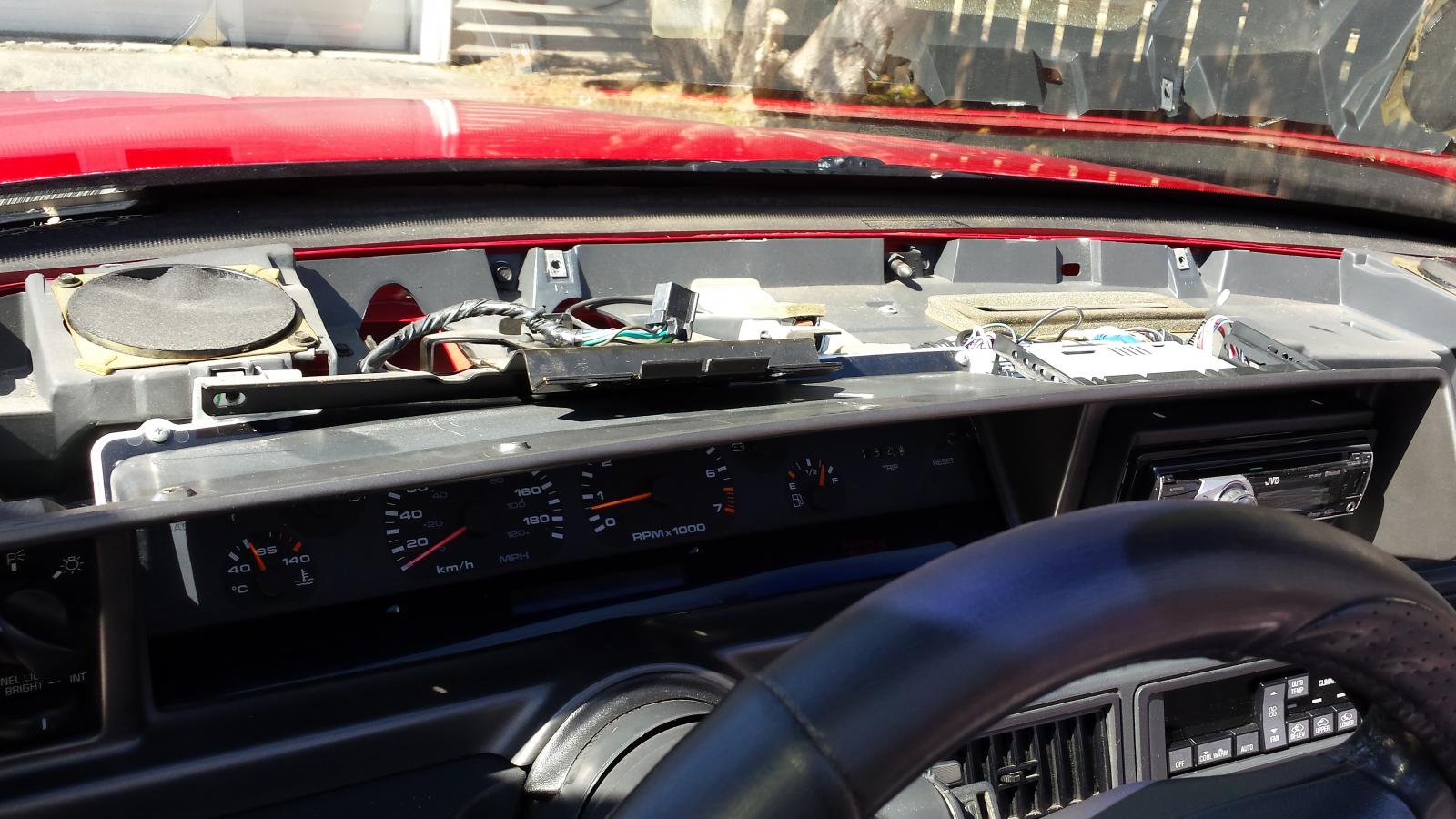

sleepy34 Posted April 20, 2014 Report Posted April 20, 2014 I was wondering if anyone had a solution for how I can change my hud to metric as I am a Canadian. I curently have it off as I am doing a dash repair and thought now would be good time to tackle it while the wires are exposed in case it involves moving one around?????? I also recomend if you go to all the trouble taking dash off change stock speakers . It is the only way to get at them. Quote

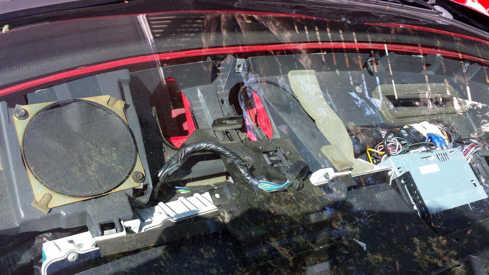

sleepy34 Posted April 20, 2014 Author Report Posted April 20, 2014 1994. it is the light blue wire . it need to be spliced to the black wire. problem is I have 2 light blue wires and 2 black wires on the harness. both of different gauges. I need diagram to know which is pin h to be spliced to pin b Quote
RobertISaar Posted April 20, 2014 Report Posted April 20, 2014 the connector doesn't have small letters cast into it? i'm certain mine did. Quote
White93z34 Posted April 20, 2014 Report Posted April 20, 2014 at least on my Bonneville there is an extra ground wire that normally goes nowhere, and just grounding it will change it to KM/H from MPH And they might be hard to see, but the connector will have ABCDE and FGHIJ or some variation of that printed on either side to let you know what pin is what. Quote
sleepy34 Posted April 20, 2014 Author Report Posted April 20, 2014 found list of colors in order on the pin. grounded both end of light blue wire (h) to black wire (. worked like a charm . all back together. tks guys:biggrin: Quote
