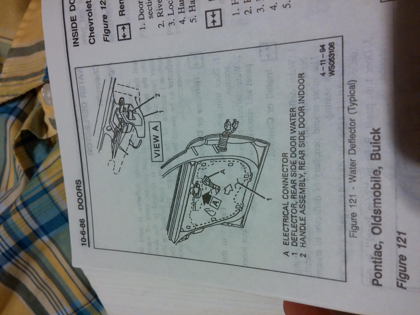

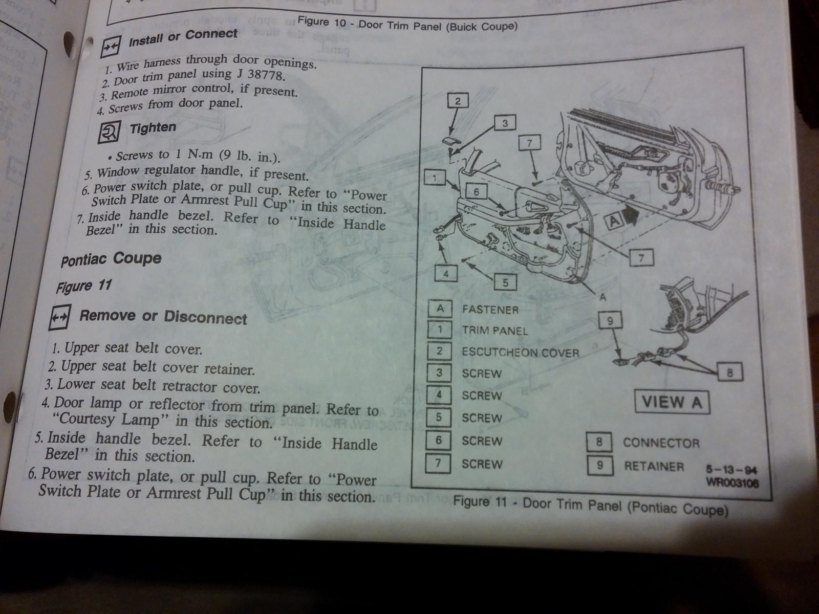

I took the liberty of looking this up in the service manual to give some direction on how to do this. I could use one of these in my GP however it's just a bit of noise still holds alright.
