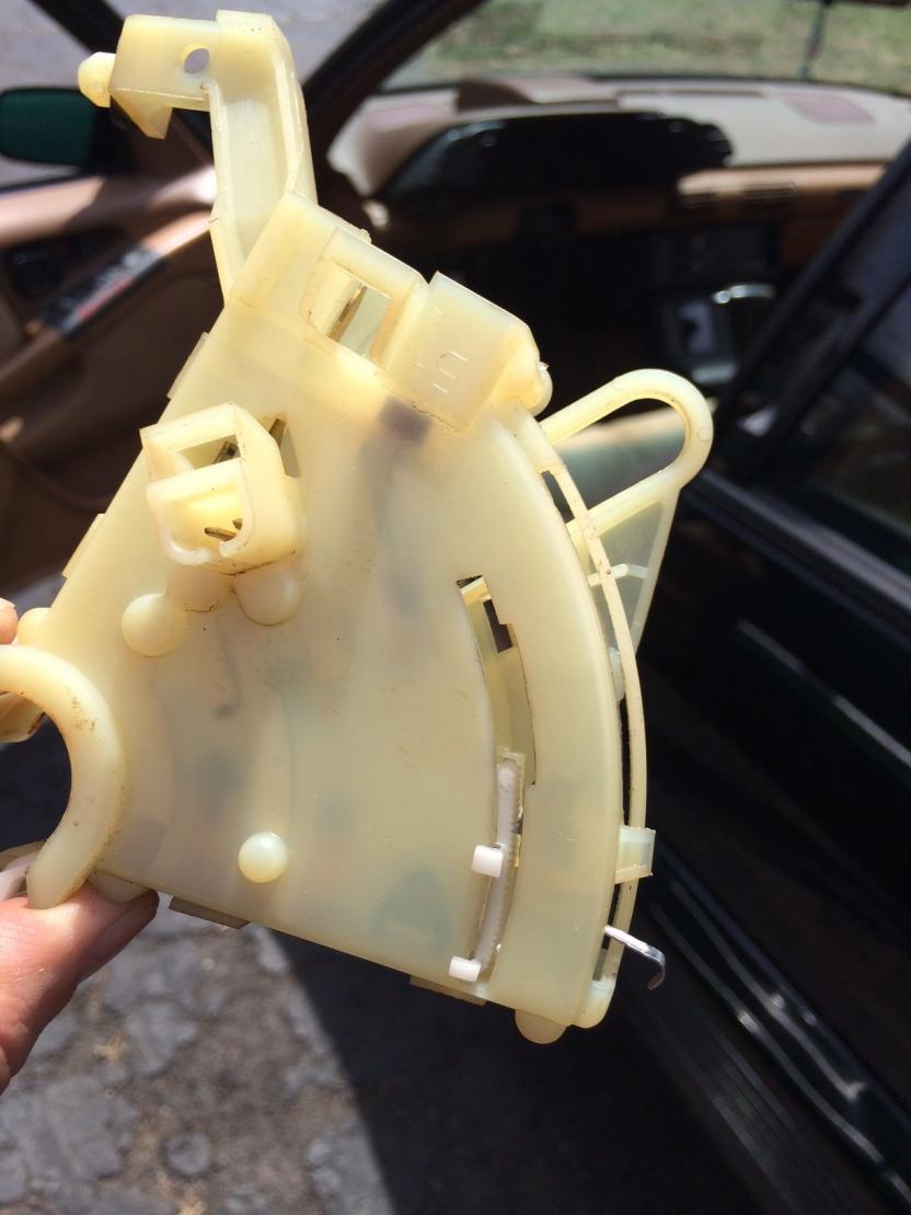

Heartbeat1991 Posted April 12, 2014 Author Report Posted April 12, 2014 Chris, I take it this metal hook at the bottom is what you speak of? It looks like it would be some kind of adjustment. Also, can anyone verify what the smaller 2 pin connector is for? It was disconnected on mine when I pulled it out. I assume that's been the phantom problem causing my cruise control not to work.
RobertISaar Posted April 12, 2014 Report Posted April 12, 2014 looks like you're correct about the cruise switch. http://imgur.com/XyPSKZA
Heartbeat1991 Posted April 12, 2014 Author Report Posted April 12, 2014 Thanks, Chris. I have no idea how you get that done without pulling the switch out. But I got them working right again. I see how easy it is for someone to pull up on the pedal and screw it up too. I had to re-adjust the cruise control vacuum release too, but the lights work right now.
White93z34 Posted April 13, 2014 Report Posted April 13, 2014 its a total pain, I use a small hook tool to get at it. Glad you got it fixed!
