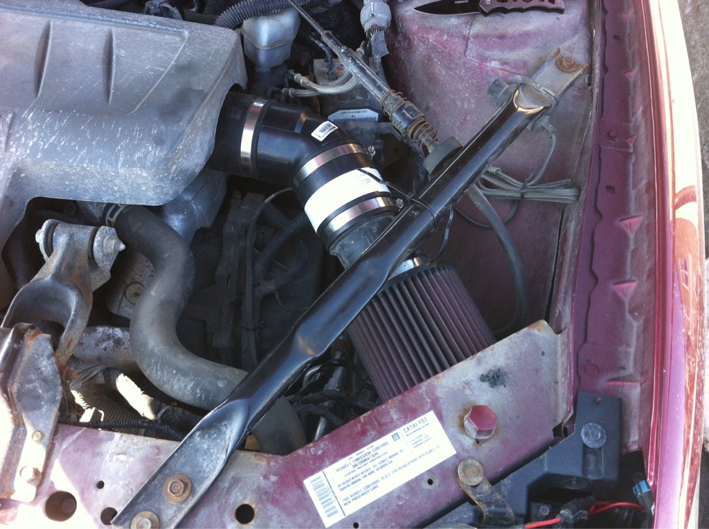

2k2cse Posted April 4, 2014 Report Posted April 4, 2014 If you're fine with something that looks a little plain, make your own. You can easily make it for under $100 with a good filter. Mine was just over $100 but my filter cost $60. Quote

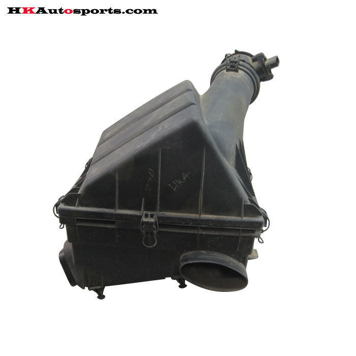

Imp558 Posted April 4, 2014 Report Posted April 4, 2014 I'm thinking about cutting the bottom out of a filter box from a trucck and mounting it on it's side in that corner with the nice purolator filter in it. That should be fairly easy to seal off so none of the air comes from under the hood. Quote
RobertISaar Posted April 4, 2014 Report Posted April 4, 2014 both of those are hilarious as "cold air" intakes, sucking hot air right off of the exhaust manifold and otherwise underhood air. the stock box draws from behind the headlamp and actually does draw cold air. I'm thinking about cutting the bottom out of a filter box from a trucck and mounting it on it's side in that corner with the nice purolator filter in it. That should be fairly easy to seal off so none of the air comes from under the hood. the tube-like ones? i'm trying to remember how they look on my father's 96 and 99 yukon/tahoe with the 5.7, if that is what you're referring to. Quote

Imp558 Posted April 5, 2014 Report Posted April 5, 2014 the tube-like ones? i'm trying to remember how they look on my father's 96 and 99 yukon/tahoe with the 5.7, if that is what you're referring to. No, the same style ours came with that use the flat filter just MAMMOTH so it has a lot of surface area. The flat underside of the box should be easy to rivot to a piece of sheetmetal. It would be sealed against the inside of the fender and the entire underside would be open and facing right into the fender. Quote
Imp558 Posted April 5, 2014 Report Posted April 5, 2014 This is like what I was thinking, this one's off a Mercedes SUV, cut the entire bottom out leaving just an inch or so and shove it up against the fender opening, sheet metal everything closed around it. Quote

RobertISaar Posted April 5, 2014 Report Posted April 5, 2014 This is like what I was thinking, this one's off a Mercedes SUV, cut the entire bottom out leaving just an inch or so and shove it up against the fender opening, sheet metal everything closed around it. that could certainly work. setting up some ducting to steal some air before the radiator doesn't seem that out of place either. Quote
