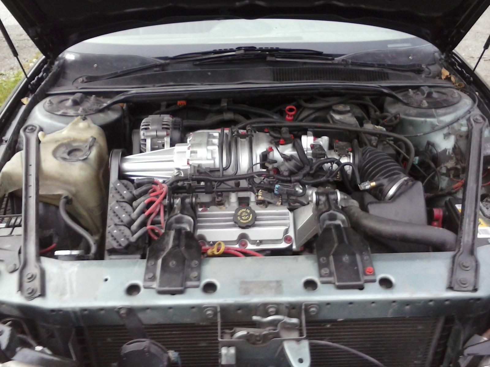

City_Slycker Posted April 19, 2014 Author Report Posted April 19, 2014 Here's the motor. City Slycker !☆¡☆! Quote
Imp558 Posted April 21, 2014 Report Posted April 21, 2014 Damn that looks like a 96! You're missing the washer res that uglies up the area over top the battery, and two diagonal braces that go from the core support to the strut towers. The layout is the same under the hood though, which is good. A 96 Harness would be OBD-II, but you have to add a handfull of wires to it for the 4T65E-HD if you want to run it. But for the most part a 96 harness is compatible with your car, and a 7797 PCM from an L67 car is a 99% plug-in to that. Not bad odds. Look at my photos. What part of the country are you from? Quote
Nas Escobar Posted April 21, 2014 Report Posted April 21, 2014 Damn that looks like a 96! You're missing the washer res that uglies up the area over top the battery, and two diagonal braces that go from the core support to the strut towers. The layout is the same under the hood though, which is good. A 96 Harness would be OBD-II, but you have to add a handfull of wires to it for the 4T65E-HD if you want to run it. But for the most part a 96 harness is compatible with your car, and a 7797 PCM from an L67 car is a 99% plug-in to that. Not bad odds. Look at my photos. What part of the country are you from? Is he running any risks driving around without those diagonal braces? I assume they're there for a reason. Quote
City_Slycker Posted April 21, 2014 Author Report Posted April 21, 2014 (edited) It was manufactured 3/95. I'm trying to do as little as possible as far as mods go. Those braces you talk about, never had em. What risks are you talking about Nas? I took the washer res off to get to the battery. I noticed the power steering pump is no longer in the stock location on yours Imp. Where is it now and what block did you use? Series I or Series II Edited April 21, 2014 by City_Slycker Quote
Nas Escobar Posted April 21, 2014 Report Posted April 21, 2014 (edited) It was manufactured 3/95. I'm trying to do as little as possible as far as mods go. Those braces you talk about, never had em. What risks are you talking about Nas? Then your car is an MY95, not a MY96. Although the Riviera and California Camaro did get the S2 3800, yours is supposed to be S1. The only reason it wouldn't be is because someone else swapped it before you, in which case you would have a lot of digging in to do. What I observe though is that it seems that you're simply mising the beauty cover and that's why it looks like an S2 3800. BTW, You're supposed to have a diagonal brace on each side of the car. It looks like this. Just so you know, a stock S1 3800 looks like this. and as far as the washer bottle, I don't have it either. It never made a difference. Ive heard you can use a 1993 - 2002 Camaro bottle and mount it in between the headlights. Doesn't work on mine because of my light set up, but it might work on yours. Edited April 21, 2014 by Nas Escobar Quote
City_Slycker Posted April 21, 2014 Author Report Posted April 21, 2014 Then your car is an MY95, not a MY96. Although the Riviera and California Camaro did get the S2 3800, yours is supposed to be S1. The only reason it wouldn't be is because someone else swapped it before you, in which case you would have a lot of digging in to do. What I observe though is that it seems that you're simply mising the beauty cover and that's why it looks like an S2 3800. BTW, You're supposed to have a diagonal brace on each side of the car. It looks like this. Yeah, haven't had any since I got the car. I knew it was a S1, that's why I want a S2 and want to know what all NEEDS to be done in order for me to achieve that goal. I don't want to take the easy way out and go find a 96 with a S2. The only reason I said as minimal as possible cause I'm a broke mo fo trying to get this vinyl decal business going. Without that cover it is deceiving, for sure! Quote
Nas Escobar Posted April 21, 2014 Report Posted April 21, 2014 Right, I was just saying if you somehow were upgraded, which I doubt as well. But yeah, check out pshojo's thread that I posted for OBD2 conversion and I think lmp has done it as well... You could also make a new thread... it would get more people with the conversion interested... and possibly annoyed for not using the search button, but I digress on that one. Quote
Imp558 Posted April 22, 2014 Report Posted April 22, 2014 I don't think it's a S2, they had 2 dogbone mounts, a lower power steering res, and the fuel rail wrapped over top of the UIM because the L36 had that big obnoxious cover. That's a S1 with the silly little cover missing. As far as the diagonal braces go, mine were in the trunk when my car came to me. I don't think it really needs them but in the event of a front impact it may be safer, and they probably do stiffen up the front somewhat during cornering. As easy as they are to find at a yard you really should have them. Quote

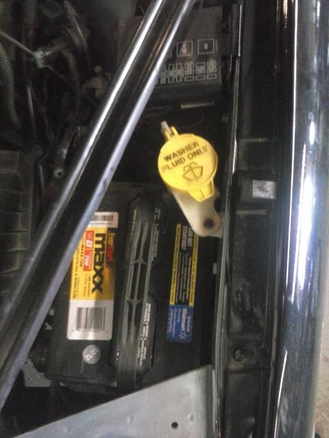

Nas Escobar Posted April 22, 2014 Report Posted April 22, 2014 [ATTACH=CONFIG]15962[/ATTACH]For reference, These are my stock accessories and mounts from the L36. LMP, that looks really nice. You should really consider a CAI. You can mount the battery sideways if you want. I know someone on here did that to their Grand Prix long long ago. There's a write up of it floating around somewhere. City Slycker, also note the big gap where the hood latch and horn is. You can easily get a Camaro washer bottle and put it in there if you want that feature back. I'm SOL thanks to the way my headlights are. Quote
Imp558 Posted April 22, 2014 Report Posted April 22, 2014 (edited) If you walk around a wrecking yard for a while there are other things out there. This one has a flexible neck and the bottle fits well in my fender. I'm trunk mounting the battery and doing a CAI Edited April 22, 2014 by Imp558 Forgot the picture, lol. Quote

Nas Escobar Posted April 22, 2014 Report Posted April 22, 2014 If you walk around a wrecking yard for a while there are other things out there. This one has a flexible neck and the bottle fits well in my fender. I'm trunk mounting the battery and doing a CAI I know there are, I've done the same thing... I've thought about using a Jeep Grand Cherokee bottle but they have 2 pumps. I don't want to put a bottle in the fender since I'll eventually make a real CAI and I don't want to relocate the battery into the trunk. While it would be better as I wouldn't have to run long wires for my sound system, I still would need to run 0 gauge wiring from the AUX post to the trunk, not to mention the grounds. Quote
