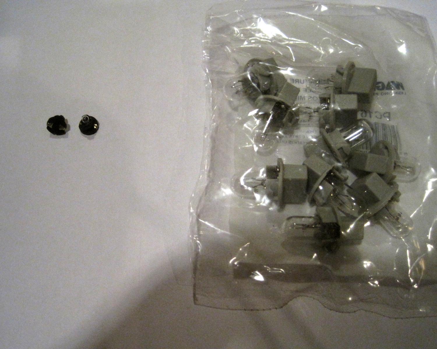

Here's a pic of the two side by side:

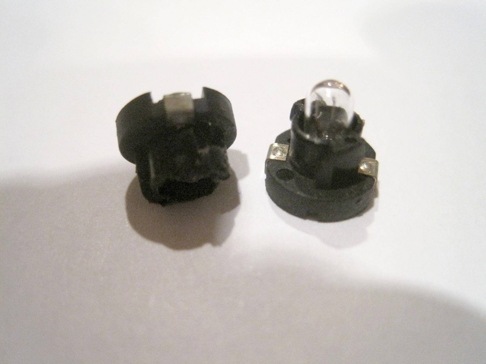

Here's a close up of the bulbs I need:
These are from the steering wheel switches. They twist into the switch circuit board and take 1 per button (4 buttons). They twist in from the underside hence the solder buttons are the contacts.
The bulb and socket are 1 piece (the part on the left had the bulb broken).
I cannot find a reference any where for the part number. Examining the bulbs, on the bottom side I find the number 70 on both, and on one the number 7, on the other the number 12?

Wow, Dude, those are wierd! If the dealer can't get them you may be able to desolder them and solder some small bulbs in there. I truly imagined these being the tiny bulbs inside out HVAC switch assy, which, incidentally can be purchased at the place that fixes stereos and then you solder them in.
Or an L.E.D with a resistor to limit the current, 1K to 4.7K depending on how bright you want them, They can get dimmer even with higher resistances of course.
