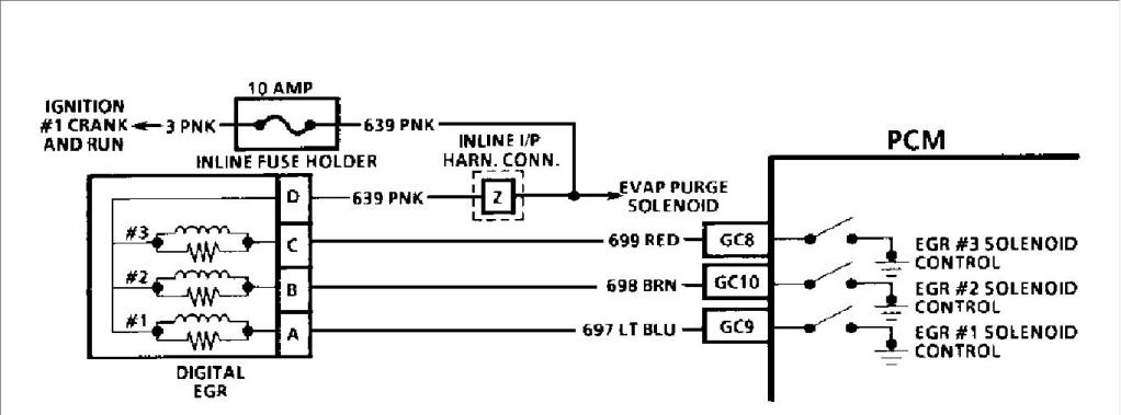

Michael Savage Posted March 30, 2014 Author Report Posted March 30, 2014 Graph shows Red Brown Blue and Pink. Asking because I have Brown Green Red and Brown Sent from my iPhone using Tapatalk Quote
Imp558 Posted March 30, 2014 Report Posted March 30, 2014 (edited) Check it, see if there's power on D, the other 3 are solenoids. GM uses Pink and Brown for ignition power, the green you see could be faded light blue 3 resistors, from Ignition power (D) to the other 3, you can stick them in the plug and test it. Or just leave the EGR plugged in and block it off. I had one that I made a double thick gasket with no port hole Edited March 30, 2014 by Imp558 Quote
Michael Savage Posted March 30, 2014 Author Report Posted March 30, 2014 Pink is probably faded to brown, I gotcha now that makes sense. I'll check them when I get to the shop in a bit and see if I can find a box of resistor that'll work Sent from my iPhone using Tapatalk Quote
RobertISaar Posted March 30, 2014 Report Posted March 30, 2014 all of the PCMs that run digi EGR(W-bodies from 90-95) test them by commanding them on during a coastdown. if the PCM doesn't see a change in MAP, it will set DTCs. Quote
Imp558 Posted March 30, 2014 Report Posted March 30, 2014 I'll be darned, it is smart enough to see it. Need to cal it out of PCM. Quote
