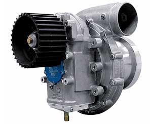

Imp558 Posted March 29, 2014 Report Share Posted March 29, 2014 Superchargers are at full boost with 1 revolution, they don't need to spool up,they make power NOW. Supercharger parts that are in the airstream would be way too big to "break and fall into the engine and bust up everything" Turbos spin at high RPM and are far more likely to drop oil pressure or some damn thing and end up as schapnel, and yes they are in the airstream too. Jet Fuel is something like Kerosene, aviation gasoline is pretty mean shit though. Quote Link to comment Share on other sites More sharing options...
Michael Savage Posted March 29, 2014 Author Report Share Posted March 29, 2014 Supercharger vs Turbo can be argued forever lol not even gonna touch that one, but for my tastes I prefer a turbo. Also you can't fit a supercharger in a 90s model Monte Carlo without and engine swap from what I've heard. If there's a 3100-3400 supercharger please give me a link IDE love to read about it, tried to find it but never could. Yeah it was you could hear the big block a mile away lol every time we cranked it someone called the police since we lived in town. Sent from my iPhone using Tapatalk Quote Link to comment Share on other sites More sharing options...
Imp558 Posted March 29, 2014 Report Share Posted March 29, 2014 This thread took a wrong turn, it was about putting a 3900 in, not putting a blower on a 3100, that's not a huge option true. But in the grand scheme of this thread I was merely pointing out that the 3900, while it would be novel, and would be cool, is also not exactly practical. A boosted 3400 might be a more favorable engine for you. The car you were talking about was likely running airport avaition gas, it's over 100 octane, I'd love to have a barrel of that. Jet fuel would be aweful, you would have very different memories of it were it truly jet fuel. I believe it happened, don't get me wrong but you were misinformed, cars can't run it, they just stall. Quote Link to comment Share on other sites More sharing options...
