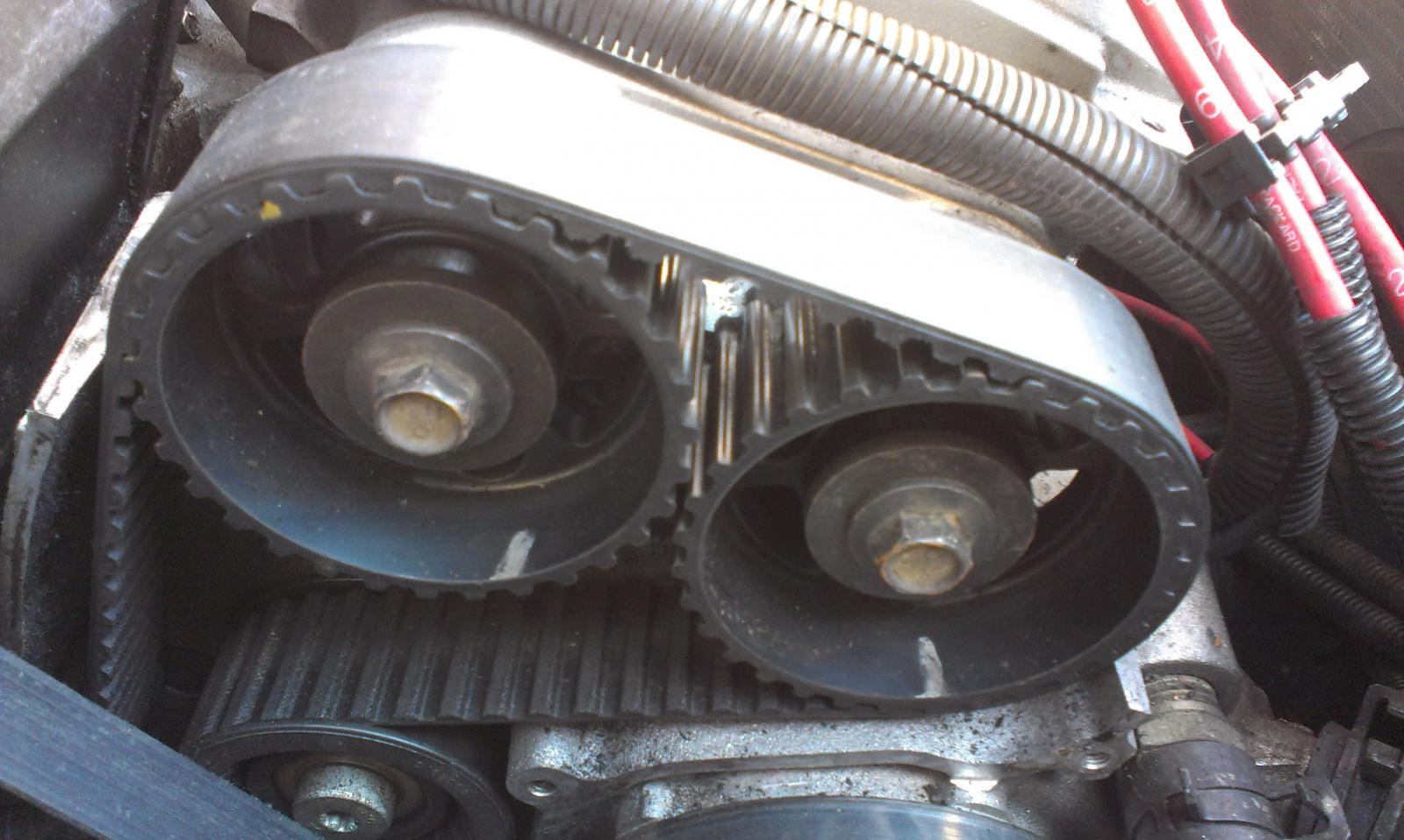

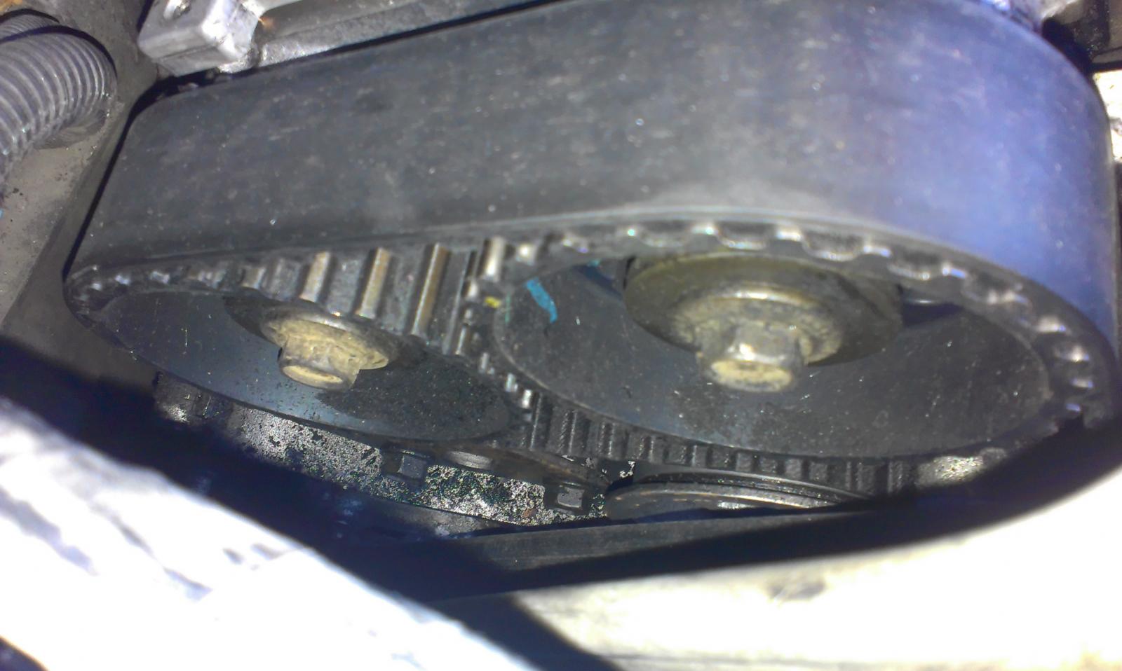

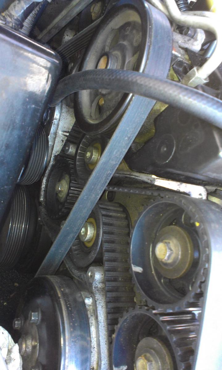

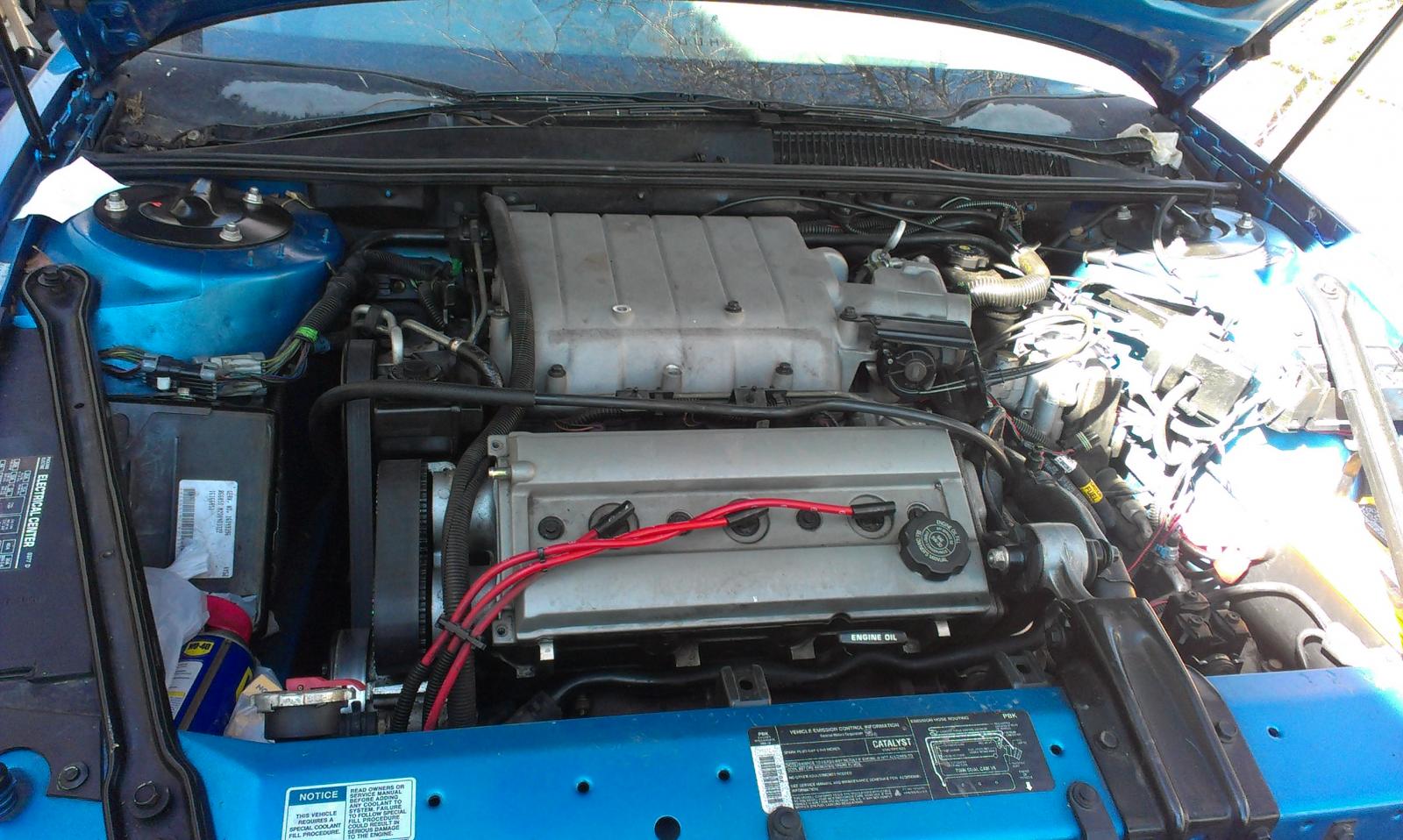

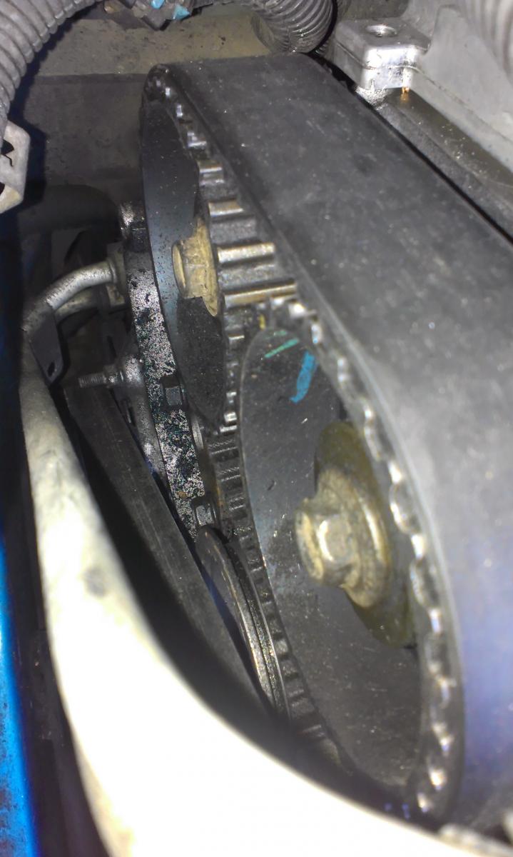

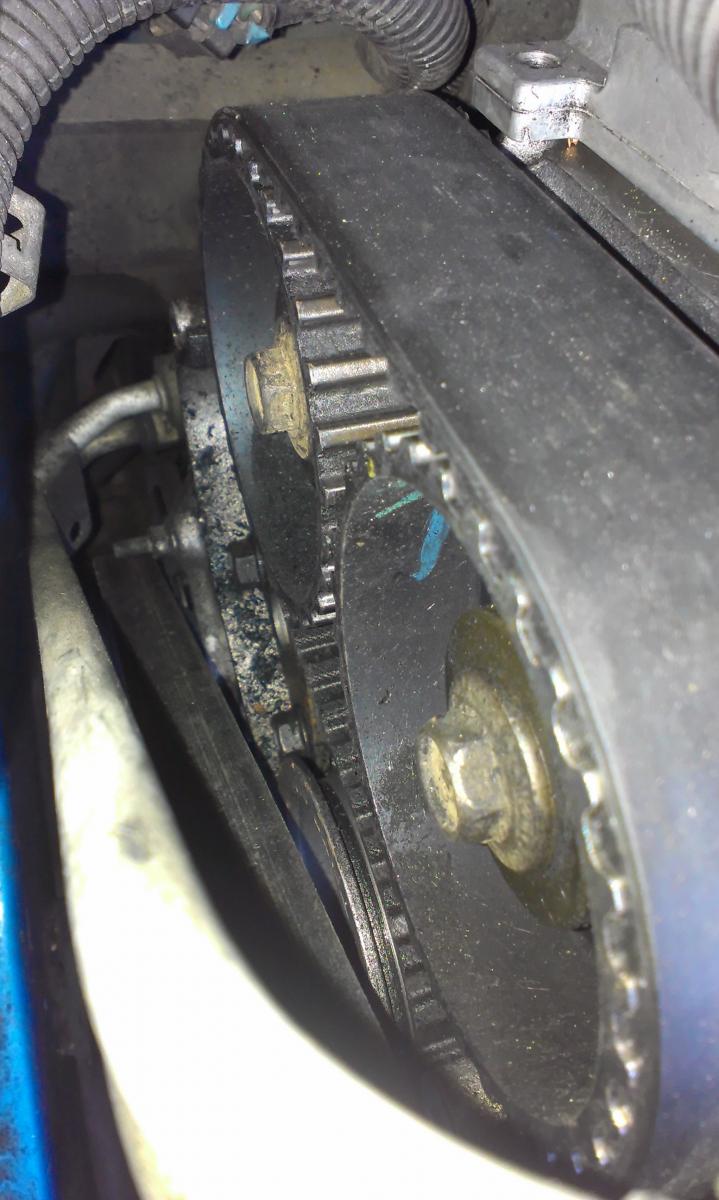

jw16 Posted March 24, 2014 Report Posted March 24, 2014 (edited) Hi I'm James and I'm new to the w body forums, and this is my first gm i have worked on and unfortunately a pain to work on literally. But i got this car from my aunt for $200 bucks as my grandma had originally had it and rarely drove it and they got it when she passed... well they drove it with out doing any repairs as it had 76000 miles, well months later the timing belt broke and they paid 1500 to replace it. It was fine for a week or so they said and he drove it on the highway and it just died, he had it towed to the shop that originally did the belt and they said it was the timing chain in the intermediate shaft? I really don't buy it and couldn't stand the car to be junked so i had it towed to my place and sure even figured out that the crank sensor magneto swole up like a balloon and broke the case (made it a pita to get out!!) So i replaced that and the car seemed to crank faster and much better but wouldn't start, i could keep cranking and put my pedal to the floor. But all the car did was backfire through the intake... - I have fuel pressure (but gas in it may be old, have 1/2 tank and put all but 1/2 gallon in my other car and it seemed shitty in it so gas couldve been old) -Injectors work (they spray the plugs) -spark plugs and wires are acceptable but two got cuts in the rubber on bank two and are electrical taped -Fuel pump works but i don't hear it, but injectors wasted my whole half gallon of gas! -the car has 78000 miles so i don't know what else could be keeping it from running I suspect that the map sensor may be bad because i do see a lot of dirt and oil in where the hoses connect to the body and intake plenum. I hope someone can shed light on this frustrating problem... the cars sat for 6 months now, i don't want to have to sell it for $1000 on craigslist!! Its sentimental value is so great but Ive lost motivation, really my 40 year old original parts charger runs even now, 75 and its original thermostat even and everything else but intake! Not dawging on Pontiac, my mom had a Ventura that would dust my charger, but point is Pontiac was shit in early 90s (well most car manufactures then with the cheap plastics and paints now mostly from greater, cheaper import export trading) Sorry for going off topic, but I'm really just looking for any input, thanks Edited March 24, 2014 by jw16 Pictures Quote

White93z34 Posted March 24, 2014 Report Posted March 24, 2014 Personally I'd be suspicious of the chain jumping time or the chain tensioner failing. I'd be looking to verify timing, Pull the plenum and find cyl 1 should be passenger side rear on that engine. get a long screwdriver and verify TDC by aligning the mark on the crank pulley/ballancer to the mark on the timing cover. Also feel for any play in the crank that could indicate excessive chain play. While you are there I'd pull the valve covers and verify that the cam flats on each bank are lined up turn the engine till the front cam flats by the cam cogs lay flat, they should do so in unison. at the same time the cam flats on the rear of the engine should be the same at this time, but 180* off from the front. I could also believe fuel injectors might be causing some of your problem, I had it where I'd get great pressure at the rail but no injector pulse. One bad injector caused all that. Quote
Heartbeat1991 Posted March 24, 2014 Report Posted March 24, 2014 $1500 for a timing belt job is a bit much, especially considering the covers weren't put back on it. It sounds to me like a timing problem. Pull off the valve cover. There is a spot on each camshaft just behind the belt that is make to fit a timing tool. They should be matched to each other. I'll see if I can dig up a pic. Quote
Psych0matt Posted March 24, 2014 Report Posted March 24, 2014 if you have the stock timing marks on the stock engine, I'd take off the belt and time it yourself that way first. I did that twice on my cutlass and it worked great. Now, if you don't have proper timing marks or don't know how to line things up, may not be a good idea. Quote
White93z34 Posted March 24, 2014 Report Posted March 24, 2014 Stock timing (paint on cam cogs) are a terrible way to judge anything. If the job was done properly they will be in no way near what the factory might have been. You'd just be chasing your tail. Quote
Heartbeat1991 Posted March 24, 2014 Report Posted March 24, 2014 /\ That's why I said take off the valve covers. I had a crate LQ1 that I assumed the timing marks were right, they weren't. It ran like poo. Once I took off the valve covers and timed it to the clamping journals, all was well again. Quote
