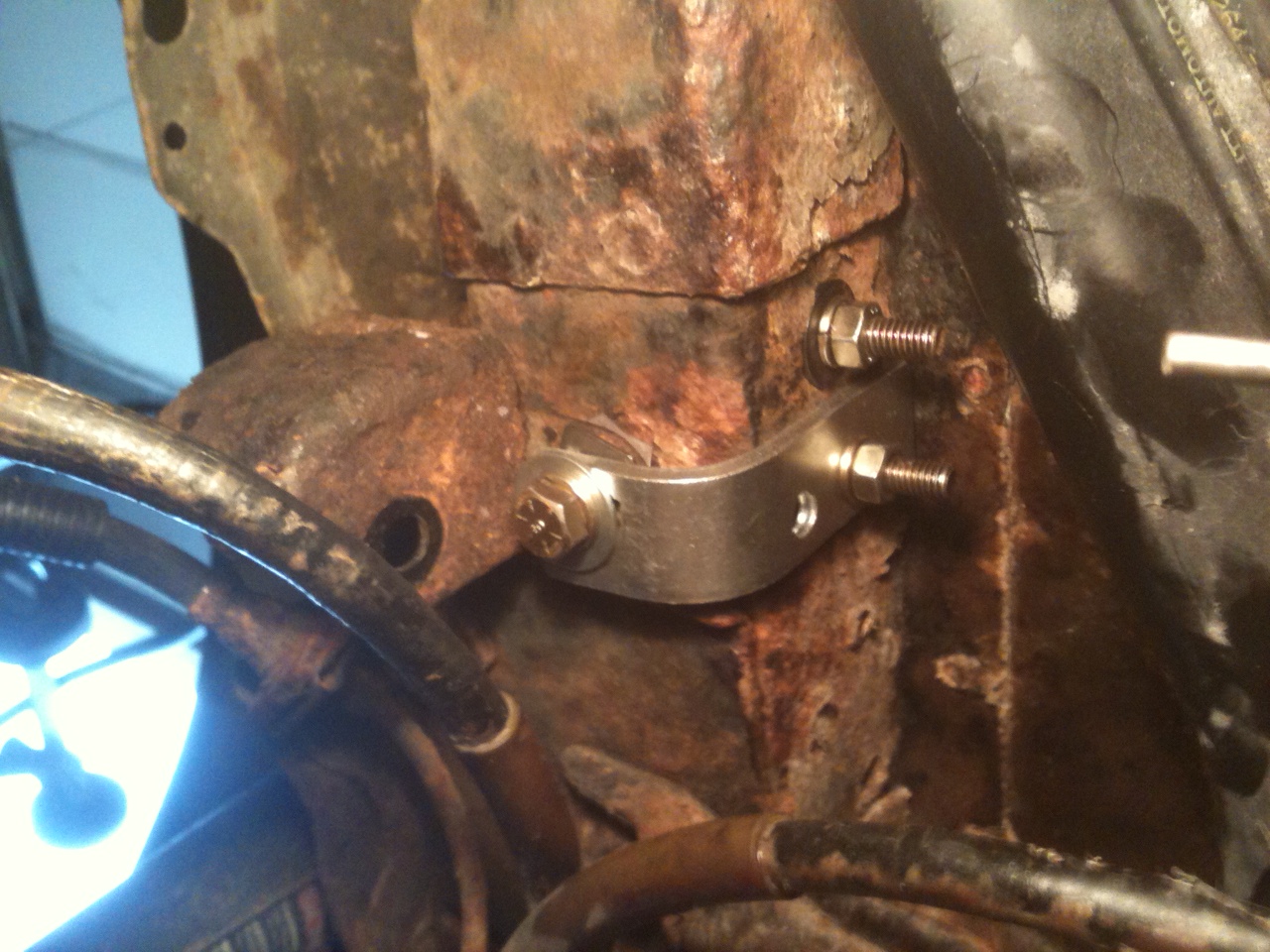

vipmiller803 Posted October 8, 2014 Report Posted October 8, 2014 I added a sway bar a few days ago to my buick. It had no sway bar stock so it also did not have the tapped nuts inside the frame. Driver side had holes going through the frame. Passenger side did not. Drilled my own there. Had to cut out a small section (maybe 2 1/2" by 3/4"?) of the wheel well to get a drill straight in there. If you have a long enough drill bit that would not be necessary. For hardware I just used grade 8 5/16th 4" bolts. I did not leave the third bolt alone, though. I ran a corner from the inner part of the frame/new bolt and mounted it via speed nut. I went with 3/8th 1" bolts here only because I had 3/8th speed nuts laying around. The speed nuts went on the sway bar bracket itself. The corner started out being a longer corner that was made for shelving. I can see how using that can be frowned upon, but the steel was thick and strong and it is better than leaving that bolt alone (at least in my opinion). It was quiet the PITA to get that corner fabricated with the right lengths but a good measuring job goes a long way here. Since I am already here I will just give you the rest of what might now amount to way more than my two cents. I wound up with a 16 mm bar out of a Lumina, but I know you are looking at the 7/8th one. With pulling a used bar, be sure both frame mounts move freely around it, otherwise corrosion may have eaten through part of the bar. I went with the used links rather than the repair kit. Cheap, I know, but the upper bushings were still solid. The bottom ones and the knuckle ones are a different story, though. Loose and stretched is putting it nicely. Another word about the knuckle/strut bolts bushing caps. Be sure the ones you get are the right size holes. I am sure you know of the sizes because you are redoing your whole suspension, but for someone just adding a bar, getting the undersized bolt holes can mean an extra trip to the yard. For me this did entail taking caps from a GP and ditching the Lumina caps. If you can ignore the overwhelming ripe crustiness, here is a picture of my driver side before the bar went on:Miller Quote
pitzel Posted October 11, 2014 Report Posted October 11, 2014 Yeah I got mine installed as well. All stock hardware, pulled from a FE3/LQ1 Cutlass Supreme, a newer one, I think a 1995. Had to find blind rivet nuts to fit into the holes. That was the biggest hassle. Oh, and they changed the size of the holes on the strut to bar mount (made them smaller), so I had to grind them out to fit the bigger strut to knuckle bolts used on the earlier ones (24mm bolted ones). Don't really notice much of a difference though, but I am using the Moog spring pads + the auxiliary springs + the bar + new KYB rear struts. Put the bar on last. Obviously replacing the struts and doing the spring pads was a much larger improvement overall. Quote
vipmiller803 Posted October 14, 2014 Report Posted October 14, 2014 Yea I did mention that in my post there about the strut-to-bar bushing caps having different sizes. As far as the resulting performance, to be honest, I did feel it a little, but I quickly got used to it. I have a steel rear leaf spring with the moog pads and Monroe struts, so the handling will be different than yours regardless, but I think the bar mostly helped with mid-range to high speed maneuvers only. It may be the bushing slack being just too much for the low speed turns or it could be the leaf spring doing all the work, but for any turns below 35mph, except for extremely harsh swerves, I felt very little difference. However, higher speeds are a little different. There is one expressway exit ramp that I could not easily take at 60 before but now I can. I know I can still upgrade to a 21mm bar off some Monte Carlos, and stiffer bushings might go a long way, but I am happy with it for a good long while. Quote
