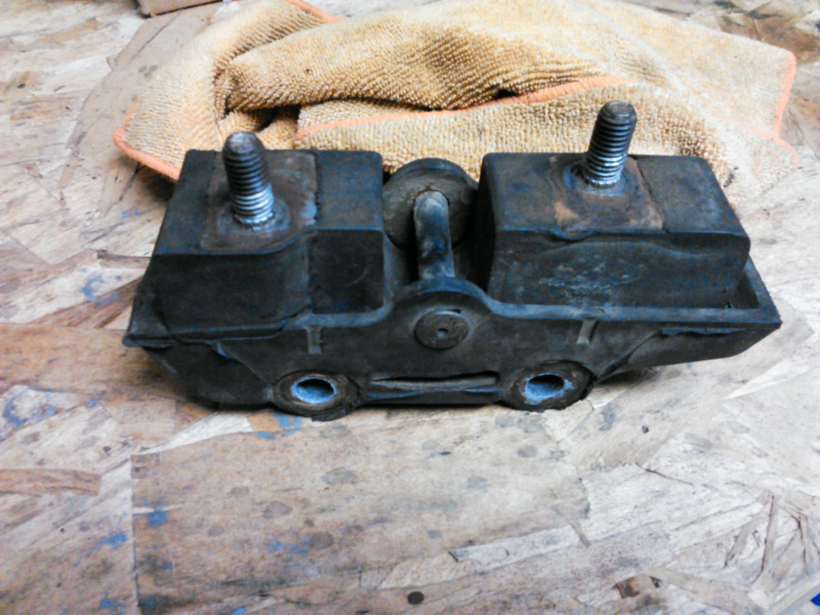

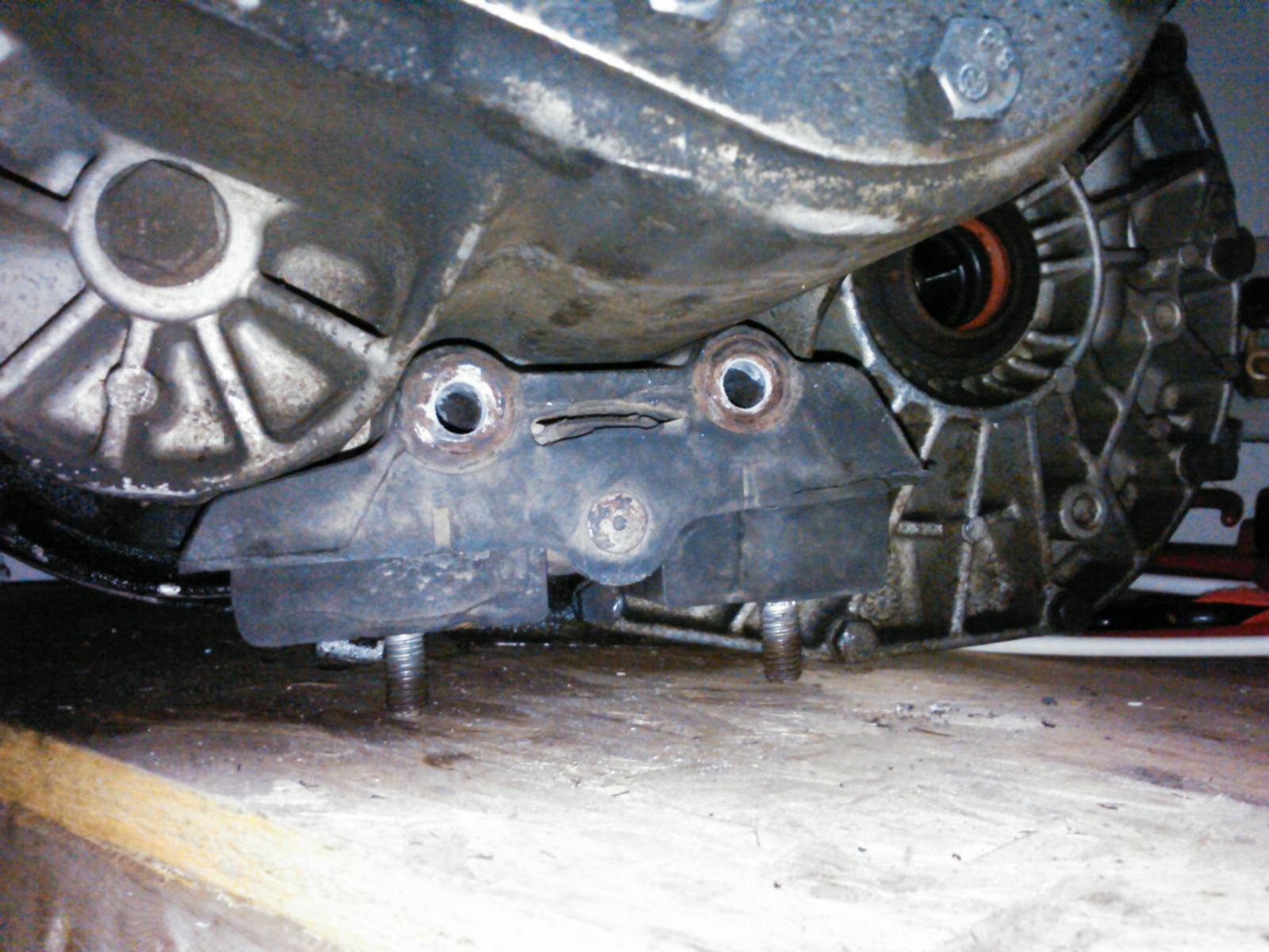

rich17 Posted February 19, 2014 Report Posted February 19, 2014 I've searched and searched and searched....But there isnt a decent thread out there that gives me definate info on all that I would need to do this swap. the plan is to top swap my L26 and drop in a manual trans to go road racing. I dont plan on making more than 300hp. I am getting the trans, shifter, cables, pedal box, and what not for a great deal. What clutches are still available? What axle inner tulips do it need? Is the 282 trans mount the same or no? What flywheel can I use? Will a factory 284 flywheel work on a 3800? Starter from a 3800 work? I'm sure I'll have more questions Quote

rich17 Posted February 19, 2014 Author Report Posted February 19, 2014 I think there was something with the oil adapter out of a Reatta. and a couple other things.. I think Kuntzie may have an idea as he has a 3800 with a getrag 284. 282 trans munt is different physically but can be used it will bolt up. 2 I believe left side axles from a 4t60 I think? axles should be plenty available. Spec has a Stage 3 clutch that will hold that power. Im not sure about spacing between the 660 and the 90* engines. -Jarek Kuntzie still lurking around? I'm not on here often these days. The 282 mount will bolt up to what? The trans or the cradle? I really just need it for mock up since I wanna run a more solid mount anyways. I read that the two 4T60 tulips will work on the 282's but not the 284? Quote

rich17 Posted February 20, 2014 Author Report Posted February 20, 2014 How the hell your thread is not a sticky or a faq is beyond me.... Couple more questions. I dont have a set of 284 axles. And theyre hard as hell to find. I am also going to 2nd gen front knuckles and bearings so they would have to be hybrids. Can you test fit your old axles to try and see if they slide onto the trans at all? Can you post a photo of your trans mount just so I have a reference please Quote

carkhz316 Posted February 20, 2014 Report Posted February 20, 2014 How the hell your thread is not a sticky or a faq is beyond me.... Couple more questions. I dont have a set of 284 axles. And theyre hard as hell to find. I am also going to 2nd gen front knuckles and bearings so they would have to be hybrids. Can you test fit your old axles to try and see if they slide onto the trans at all? Can you post a photo of your trans mount just so I have a reference please Ya, not sure why it hasn't been made sticky worthy yet. Maybe I just have to ask, haha. In regards to the axles, I unfortunately got rid of them when I sold my 4t65e earlier in the fall, so I can't test fit them unless I "borrow" one from the parts store. I'll check it for you, but IIRC, the spline count is different on the inner shaft(s). I also just ran out to snap a quick pic of the trans mount since there's 2 of you now that wanted it. Sorry it's taken me so long. Quote
