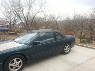

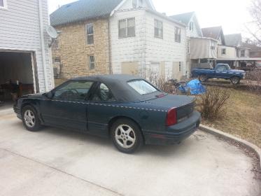

95toplesscutty Posted February 20, 2014 Author Report Posted February 20, 2014 Ok everyone, my top is done. It came out good! I have a book that I got when I ordered my top that walked me through the replacement process step by tedious step... in the end I have a sweet new top for less than half the cost of most shops! Quote
94 olds vert Posted February 20, 2014 Report Posted February 20, 2014 Looks like you did a good job. Quote
DOHCx3 Posted February 20, 2014 Report Posted February 20, 2014 Nice job! Is there anyway you can make a copy of that book? It would be nice to look at. Quote
95cutlass Posted February 20, 2014 Report Posted February 20, 2014 Looks great, nice work! I have to replace mine withing a year or two, I use it often in summer so it is wearing on the drivers side and almost has a hole. Quote
