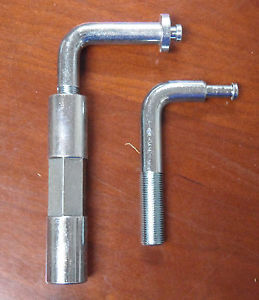

Imp558 Posted February 1, 2014 Report Posted February 1, 2014 (edited) A little pissed off, thought the Regal came back with excess neg camber and now I realized today one of my rear tires is shot. So I'm going to order the rear adjustment tool so they can do it right. I understand it's for toe but it'll show them that there's adjustment to be had. The big question is which brand is better? The Northstar brand: Or the Goodson: The Northstar is three bucks more after shipping than the Northstar. Edited February 1, 2014 by Imp558 Quote

Imp558 Posted February 1, 2014 Author Report Posted February 1, 2014 I thought maybe one of the alignment techs on this site would Say one was better than the other. Given the choice I think the goodson Might be the better option, gold colored is usually tougher steel Then the zinc plated one. Quote

Imp558 Posted February 2, 2014 Author Report Posted February 2, 2014 I actually have a camber problem. But I was under the impression this tool to be used to pull the A arm in. Gotta be better than what they're doing now even if it takes a little juggling. I'll just be happy to have something to show them that they are indeed adjustable in some form. I may pull it in until it looks straight with my level first. Can't understand why they wouldn't have the tool,But they don't appear to. I don't imagine they would discard one after they stop seeing a lot of these carsAnd they should have had it at one time at least When they were more popular. Quote
55trucker Posted February 4, 2014 Report Posted February 4, 2014 (edited) The tool we are discussing here does not alter the camber angle, it only adjusts toe angle, camber is done right at the strut mount flange, one backs off the two mounting bolts & moves the knuckle&strut at the base to alter the camber angle. Can't tell you what to do where this shop is concerned, I'd personally be looking elsewhere to a shop that is properly equipped. Edited February 4, 2014 by 55trucker Quote
