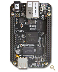

Imp558 Posted January 5, 2016 Report Posted January 5, 2016 (edited) There's a nice SBC on the market, Beagle Bone Black. It's dirt cheap and has auxiliary "capes" (accessory boards to do VGA, sound, LCD, GPS, ect..) that are cheap too. Lots of raw LCD touchscreens for it on Ebay. What's really cool is that it'll run a number of OS's including Android and.... Linux! http://beagleboard.org/black Edited January 5, 2016 by Imp558 Quote

Imp558 Posted January 28, 2016 Report Posted January 28, 2016 And a bunch of add on boards. There's a lot of SBC s on the market, bb black is just one. Quote

Imp558 Posted February 6, 2016 Report Posted February 6, 2016 Yeah I bumped an old one but I'm thinking about doing an SBC for calibration software,GPS and OBD II streaming and thought it would be appropriate for this thread. You should have seen the old threads L67ss used to bump, it was hilarious, I still don't know if he may have done it for fun. Quote
