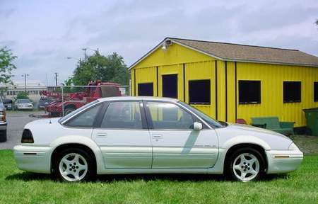

please be this. the earlier style B4U sedan concept was incredible. i don't know how 94-96 adapted to sedan would look though.
Someone posted this photoshopped picture a long time ago.
pretty sure i would prefer that above reality....
now if only i could find the 90-93 sedan B4U concept pic.... google and site search hasn't brought it up and i know i've seen it somewhere on here. i want to say it was in a magazine as well, motortrend, road & track or car & driver.
