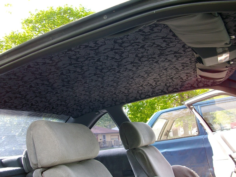

Night Fury Posted January 16, 2014 Report Posted January 16, 2014 (edited) Youbetcha. Mine is a coupe though so I could pull the thing out without folding it. Recovered great over a year ago and it is holding up great. Get creative with it, personalize while you have it out. Here is mine- it is actually a How to Train Your Dragon bed sheet. I used 3M spray adhesive, removed all the old fabric/crap from the headliner board then sprayed adhesive on some felt, then glued the sheet onto the felt. That way it has the factory 'feel' of soft thickness rather than it just being hard had I just put the sheet up there alone. I get compliments every time someone gets into my car. "OH WOW! That's so cool?! Where'd you go to have that done!?" "I did it" "NO WAY!?!" Edited January 16, 2014 by Night Fury Quote

Night Fury Posted January 21, 2014 Report Posted January 21, 2014 I used felt. There were scraps on clearance. The ENTIRE project cost less than $20 iirc Quote
